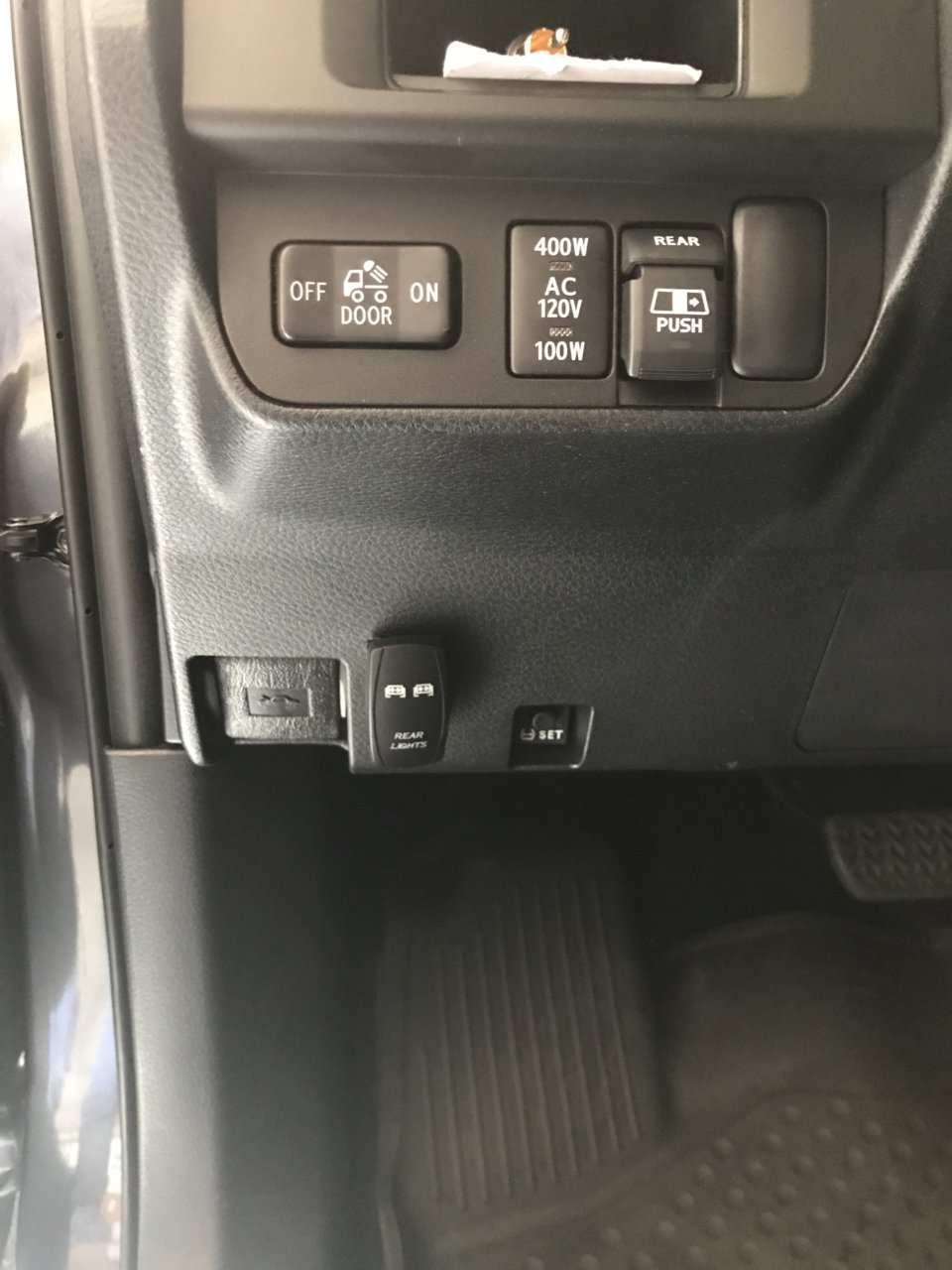

    After much research, this is how I wired my Reverse Lights. (Not trying to hijack your thread. Should I post this in a new thread?)
    This is with running lights on the auxiliary switched lights on. The lights and white in the LED strip also turn on automatically when the vehicle is shifted into reverse and the 3-way switch is on automatic (down).

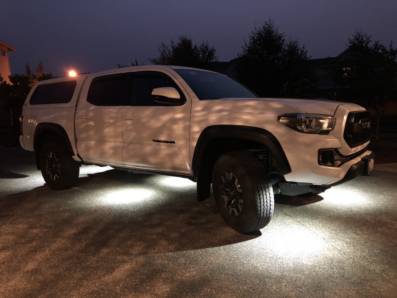

    Thanks for the write up! I installed 6 tonight. Thinking about adding two more (one for each door)

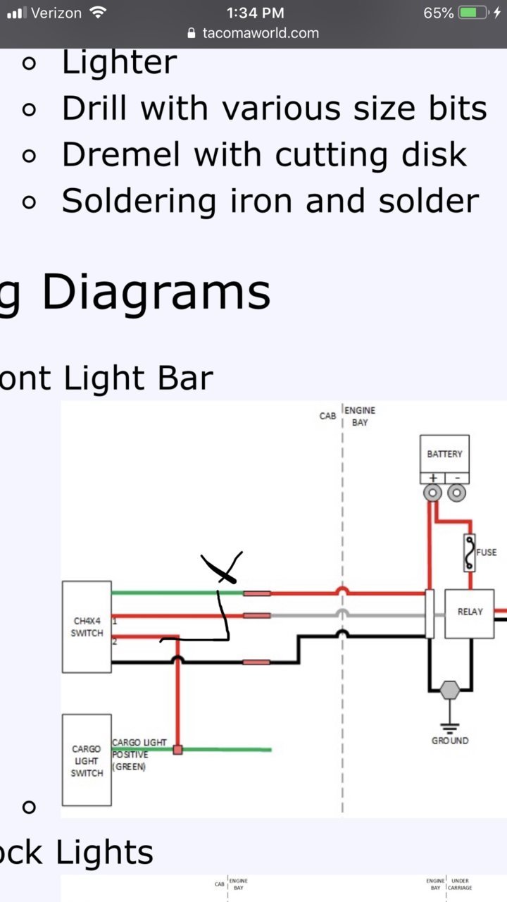

    Okay I’m know nothing about electrical work at all. But I was wondering you ran you wire to the positive of the cargo lights so it turns on when dash lights are on. Can you not just rub it the the positive of the switch you installed? upload_2018-10-16_13-38-4.jpg

    You can do that but then the switch will only light up when the switch is pressed (both the text and symbol). With how I have it wired, the text lights up when the rest of the interior dash lights come on and then the symbol lights up when the switch is pressed. You can see this at the end of my write-up in the switch section.

    Okay so it’s not the same positive like the after market switch is? Your drawing said positive so I thought it was that switches positive. How did you figure out what wire only illuminates when lights are on?
    Also why didn’t you use 20AWG I’ve seen others use like 16

    Sorry, I didn’t follow. The switch wiring is in the write-up abs below. Red 2 is the one that we are talking about. A lot of people use the green wire from the cargo light which is what I did for all of mine. You could also potentially use an add-a-circuit for an appropriate fuse that comes on with the interior lights.
    I used 18AWG wire for pretty much all of my wiring since it’s what I had on hand. I’m sure anything from 16-20AWG wire is probably fine since this is such low power draw for all of these lights.

    Yeah that makes sense. I thought the green wire going into ch4x4 was the same (not the same exact wire but same purpose) as the green wire going into cargo switch. I want mine to light up when lights are on as well so I’ll do it this way.

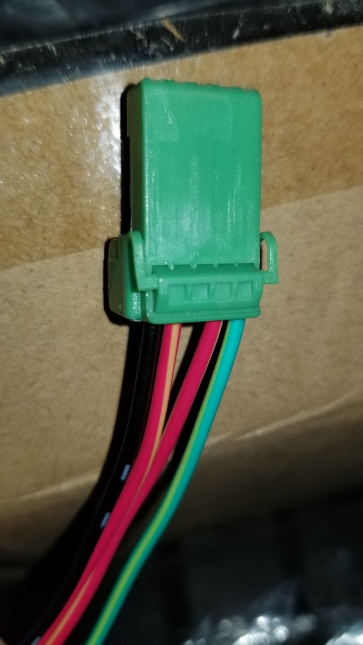

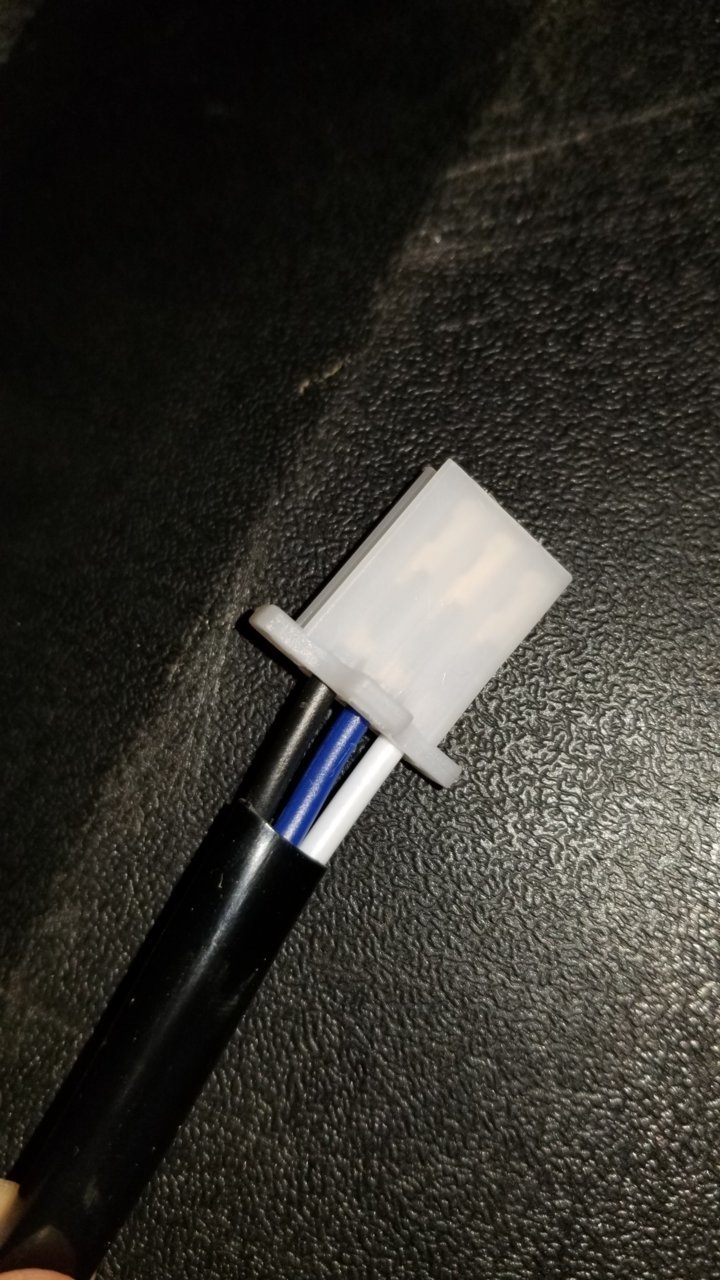

    Hey there. Question: The LED light bar harness I have has WHITE, BLUE and BLACK wires. How would I wire that to the CH4X4 switch that i have with GREEN, RED, RED, BLACK wires?
    Thanks for any replies.

    I believe I had the same issue. Look at post 64
