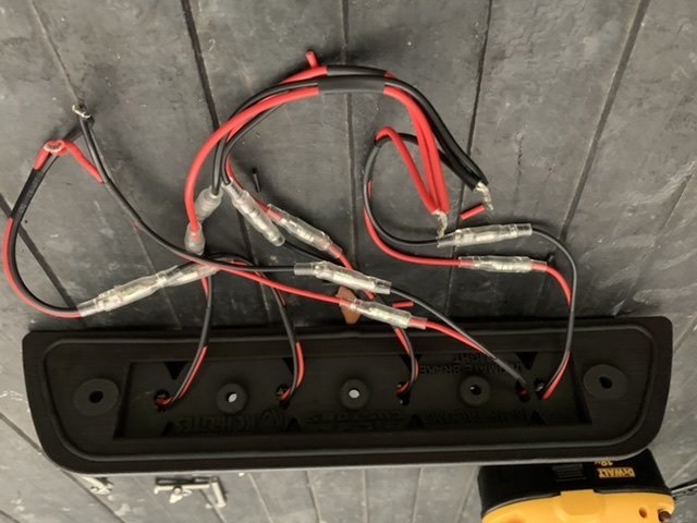

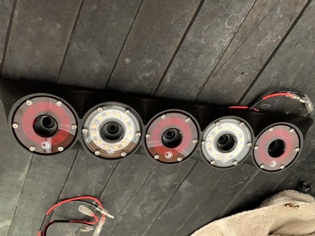

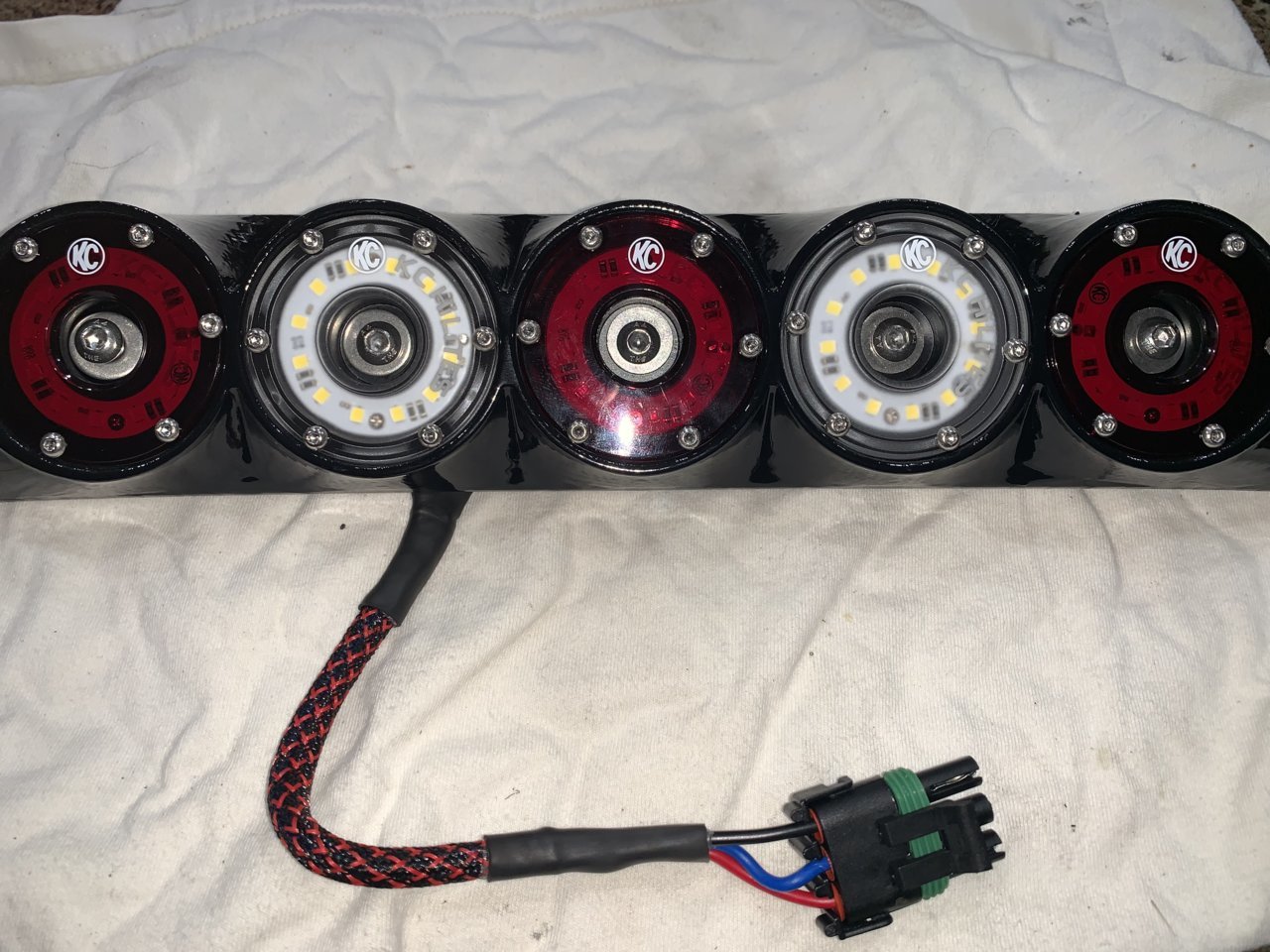

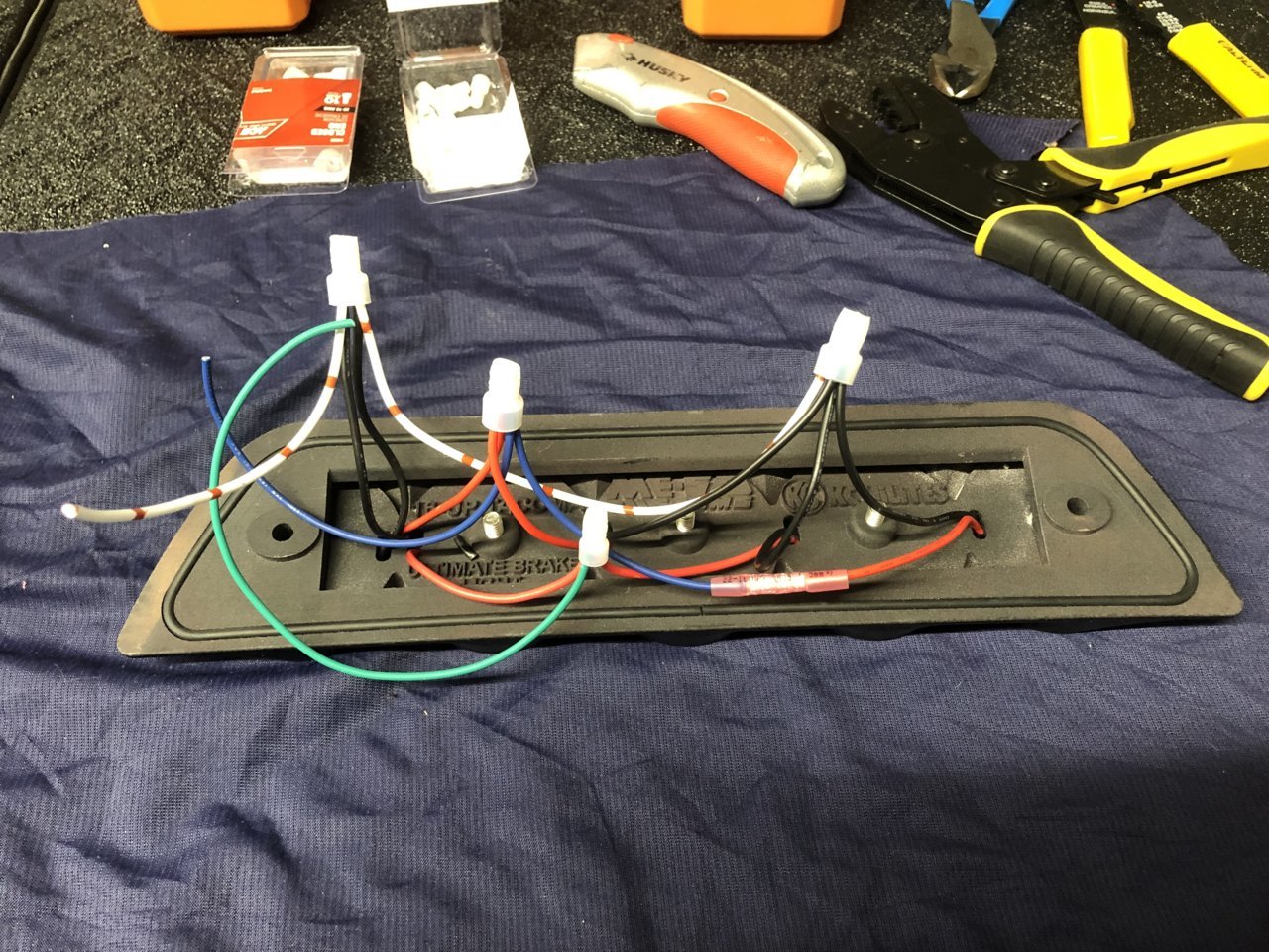

    I’m far from an electrical genius, so a little help is needed.
    I’m stuck on wiring the MESO 3rd brake light. I’ve got the KC Cyclones and just don’t follow how to wire them up properly. Don’t want to inadvertently screw it up.
    The purple, green, and white/black cables should connect how to the black and red brake lights and the black and red bed lights?
    Any help/advice would be appreciated. Thanks in advance.

    Thank you. That helps.
    Just to make sure I’ve got it:
    Bed Lights: black wire from lights will connect to the green wire. Red wire from lights will connect to the ground.
    Brake Lights: Black wire from lights will connect to purple wire. Red wire from
    Lights will connect to ground.

    No...all black wires from KC5’s lights go to ground the wire with the black stripe
    2 Red wires from KC5’s go to green for bed lights
    3 Red wires from KC5’s go to purple for the stop lights.

  5. Sep 14, 2019 at 12:14 PM
    Ronzio
    Ronzio Well-Known Member
    Feb 20, 2018
    #245114
    2,719
    Pennsylvania
    17 DCSB TRDOR

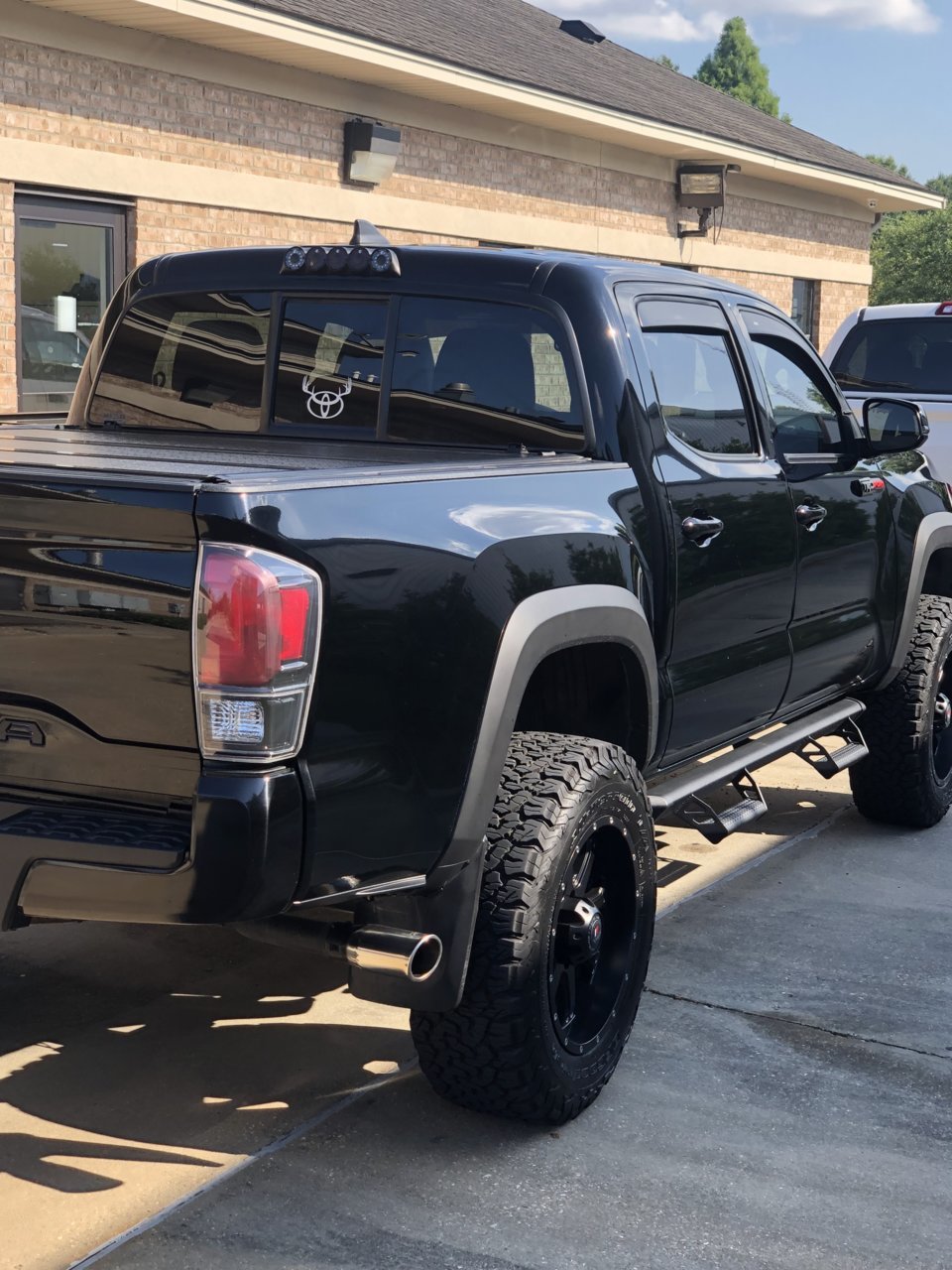

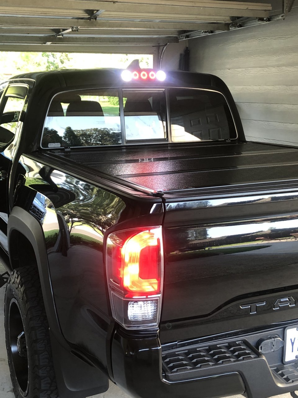

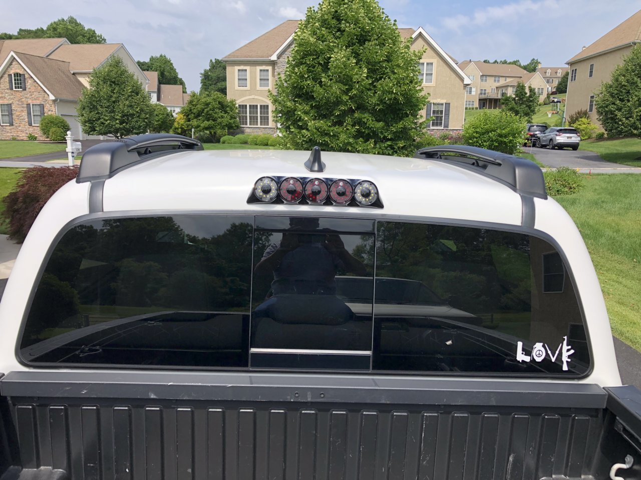

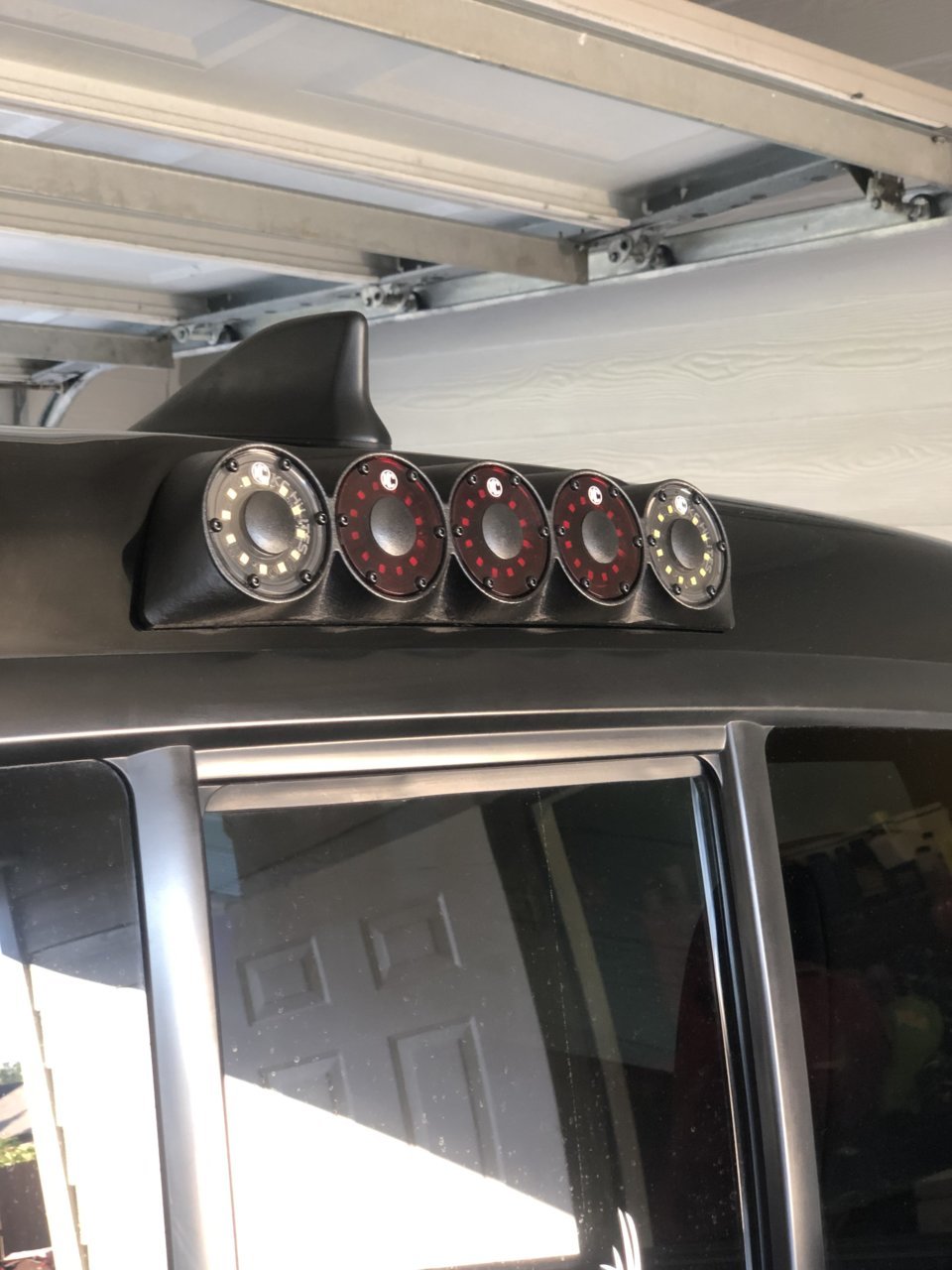

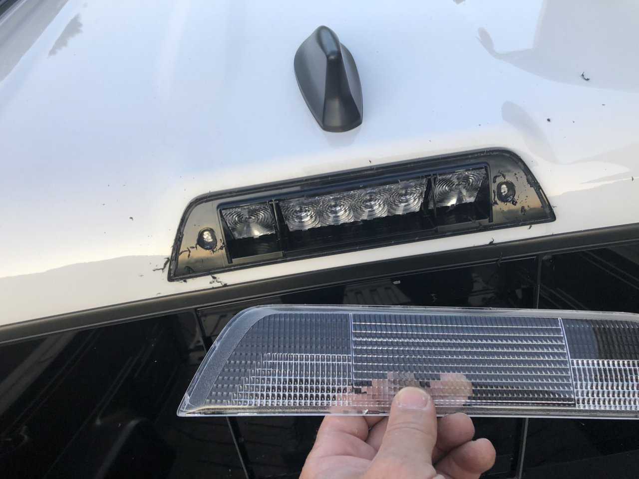

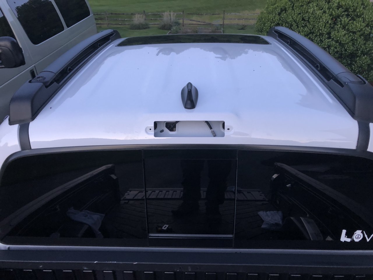

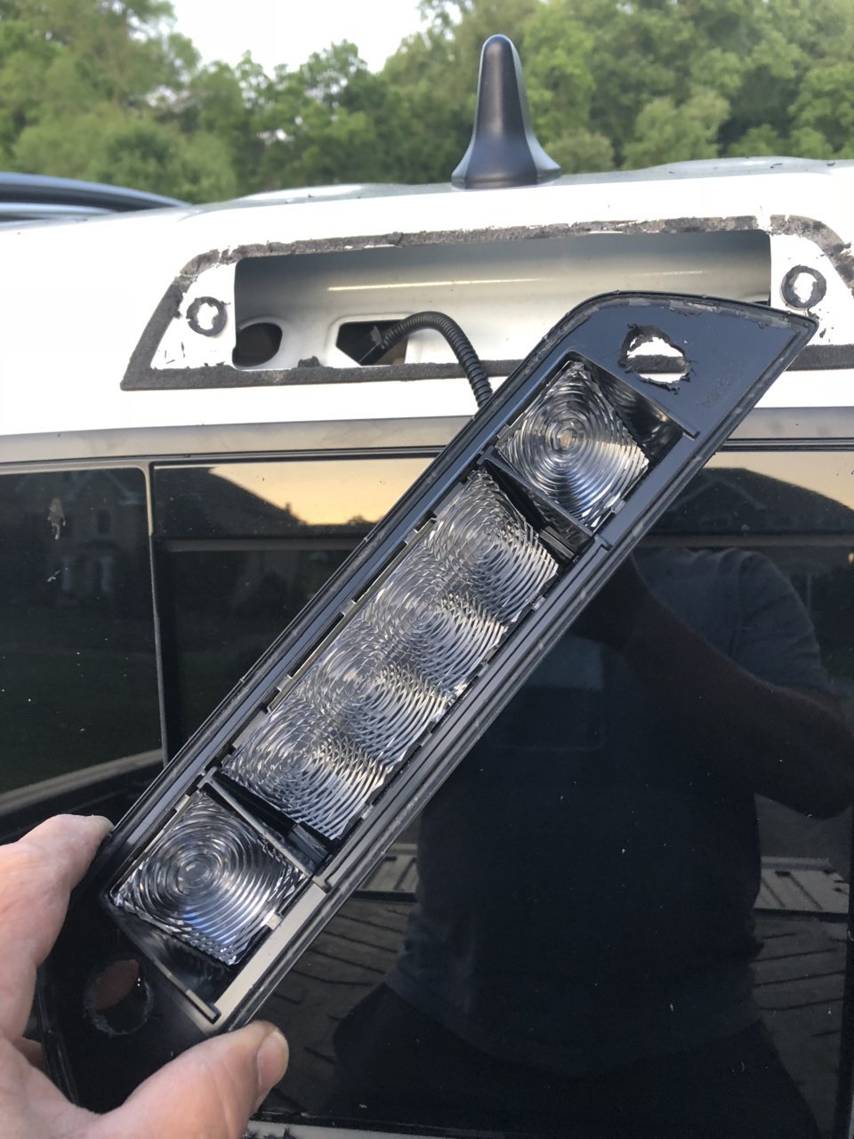

    Pop the lense off, drill out the studs, install the Meso one...takes all of 20 minutes then enjoy. Also review the Meso 3rd brake light thread in sticky section for details. Excellent mod for the money!

    perfect! Thanks for this! Got ‘er done!

    @Ronzio method would make the light useless after. Dropping the headliner allows you to actually unscrew the light instead of tearing it apart.

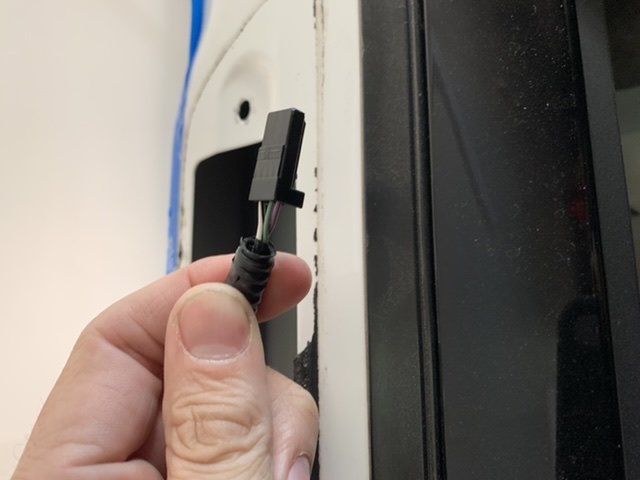

    Really? Has everyone w/ the KC5 had to do this? I feel I would have seen this talked about. The connector only needs an extra millimeter to fit through the hole. Seems to me that enlarging the hole a tiny bit with a drill bit would be easier than cutting wires. There’s gotta be a easier way to get the lights in the housingo_O
    Like this, how do I get the connectors through the hole where the wires come from? The connectors are too big

    Either drill it or cut the wires. I cut mine so I could solder them anyway.
