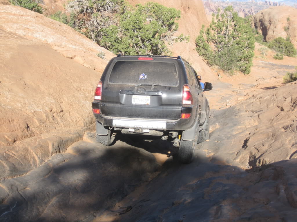

  5. Jun 7, 2013 at 8:02 AM
    Wishbone Runner
    Wishbone Runner [OP] Because 4R
    Sep 9, 2012
    #86546
    6,212
    James
    CO
    04 SR5 4Runner
    King/Dirt King
    The light itself it quite bright, where I have it is not optimal for backup though. This was my previous setup, and the LED one is mounted below the bumper to the left of the hitch. Ideally it would be higher up for better light projection, but I cant figure out how to mount it up high without a rack.
