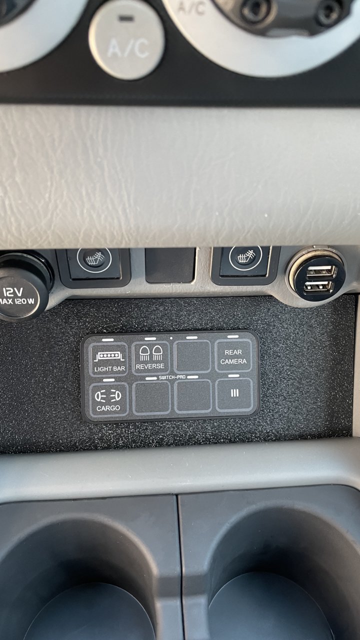

    Invest in a switchpro 9100 no need for relays or additional switches everything is in one nice package. Not cheap but very well built and if you plan on adding more lights or accessories like reverse or a compressor your all set up73F76B76-3316-4FF1-A860-D160EED6C809.jpg

    Yeah that looks nice but that price is an arm and a leg.

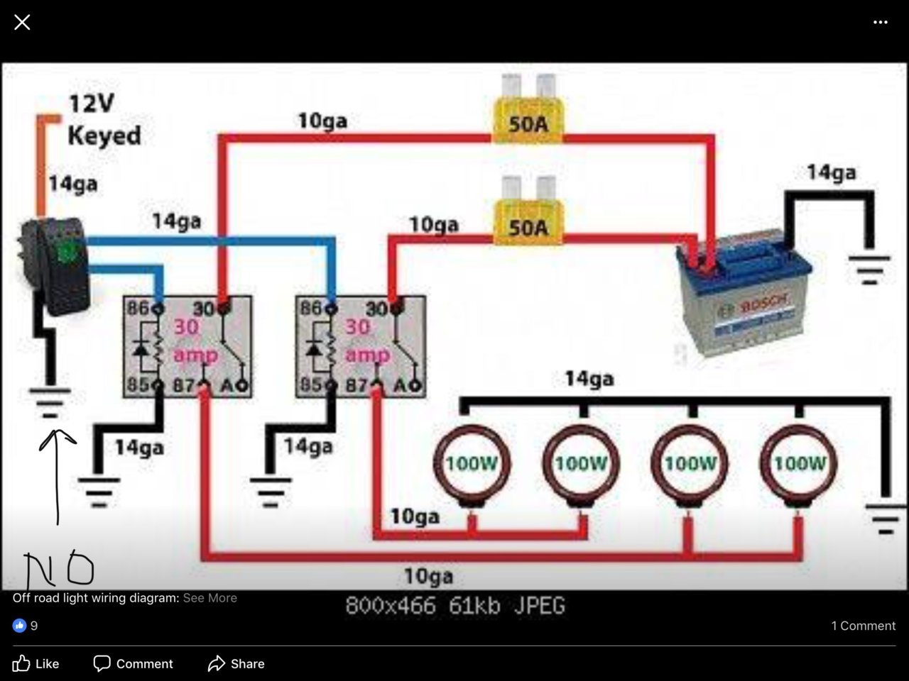

    upload_2021-4-15_8-9-15.jpgWill this help ?

    I’m just going to find a spot somewhere for another relay
