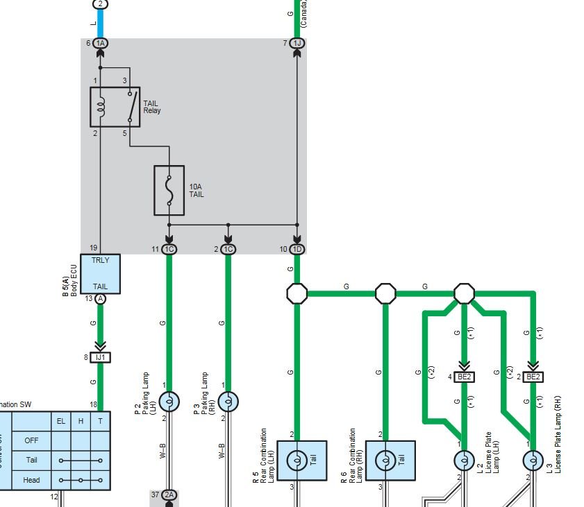

    I wired everything before installing and it works, but now after installing the lights the marker lights are not working so evidently I have blown a fuse. I opened the fuse box, but can’t find which fuse is for the marker lights. Can someone let me know which fuse i need to replace? Headlights (both lo/hi) and turn signals all work, just not the upper outermost light on either side (which is what I spliced the leds to. Any help would be appreciated.

    It's the 10A tail fuse. Either you pinched a wire to ground in the mounting or the added lights draw too much for the existing circuit. If it's the latter, you're going to need to put them on a relay.

    Thanks, not sure Toyota would mark a fuse “tail” for a light that is in the front.

    Well, they did. Look at the schematic above.
