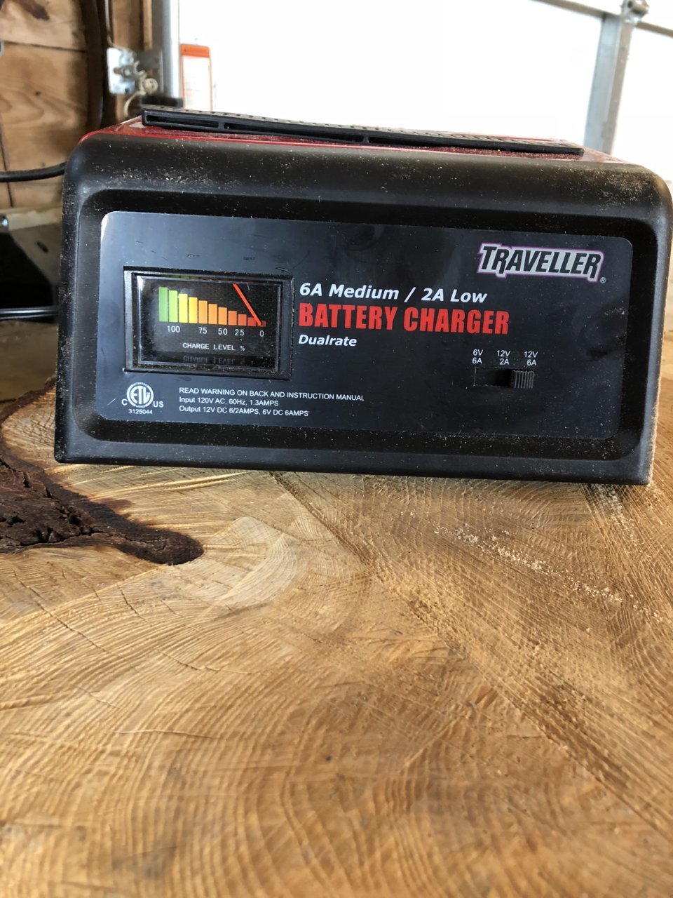

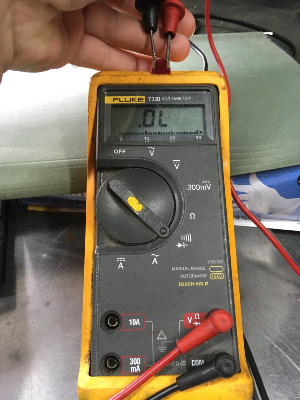

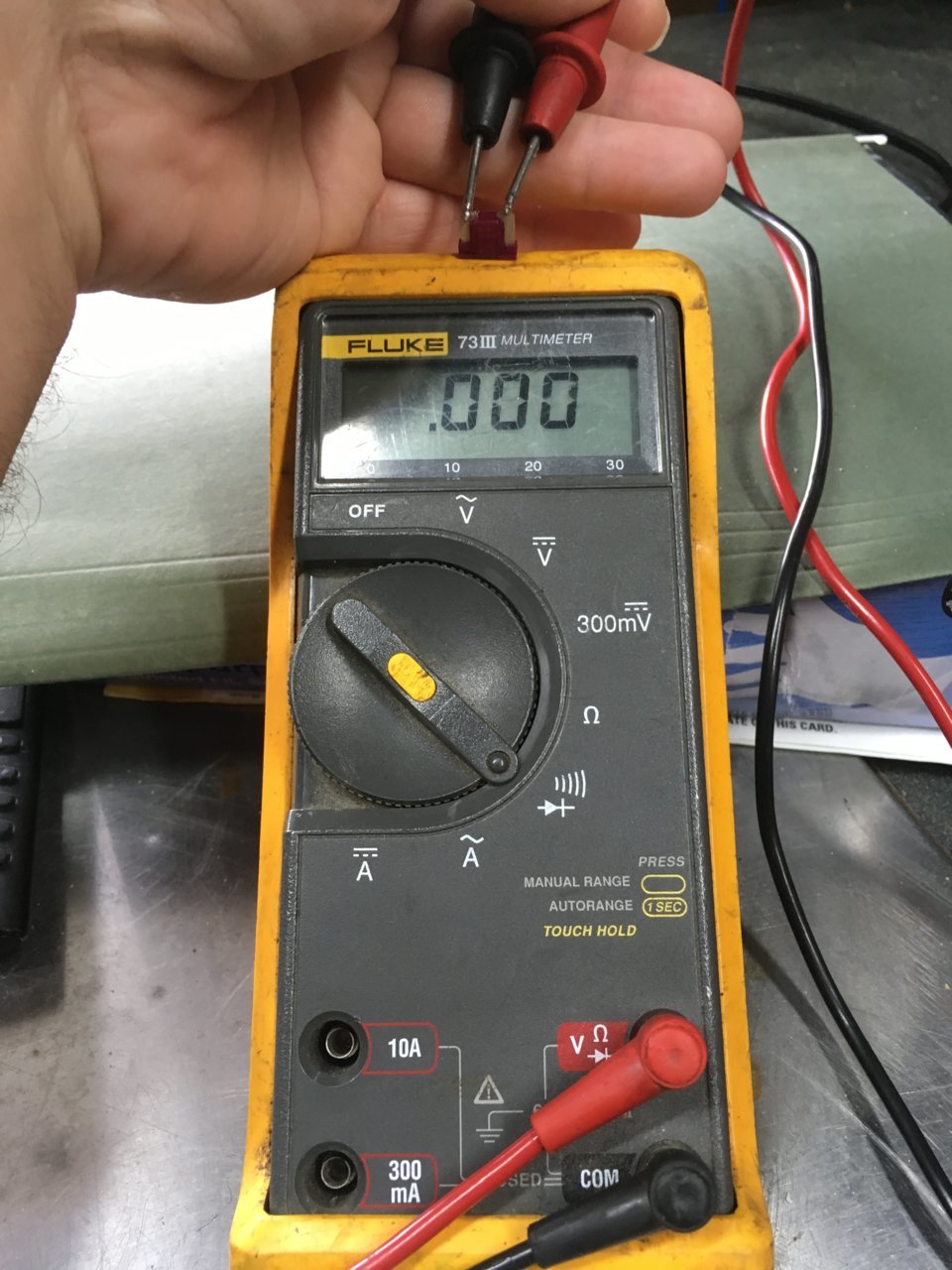

    I’ve tried but IDK if I’m not doing it right or the battery is just dead. Meter reads nothing, no matter what setting it’s on.
    On yall’s advice I am taking the battery out and charging. My charger says it’s dead.
    I appreciate everyone’s ideas. No bad ideas here IMO. It’s all good, brainstorming etc.

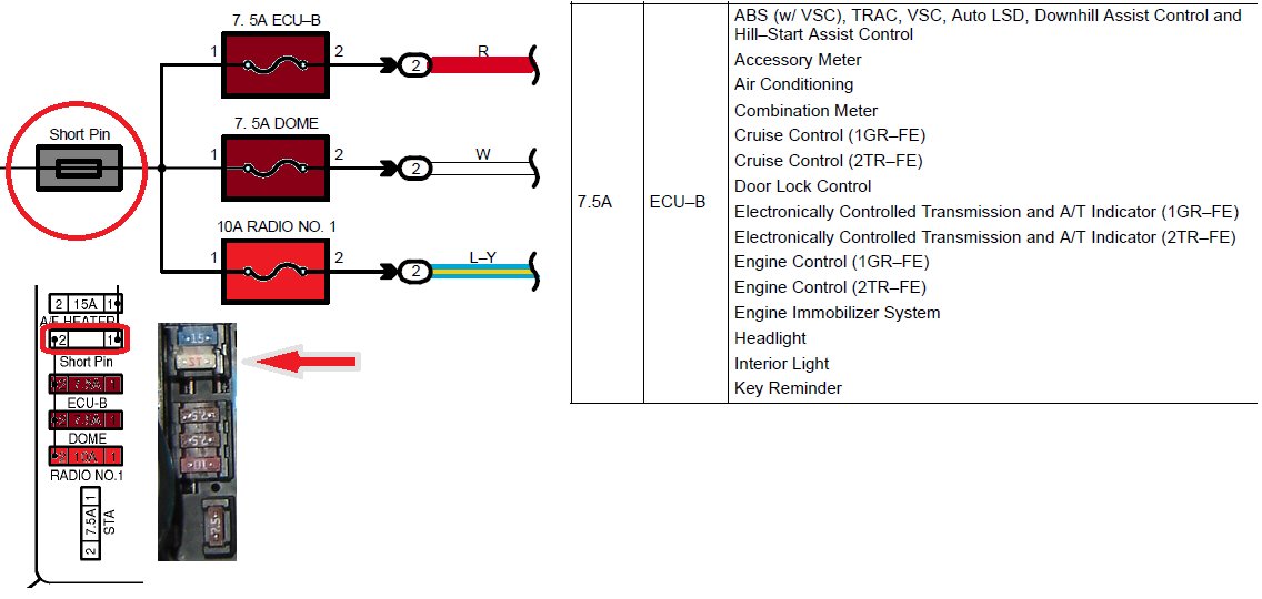

    Replaced engine with an '07 FJ Cruiser motor. Clutch accumulator deleted. WIP. plan to add new exhaust, cold air intake, URD short throw shifter,
    It actually does not have a window on this fuse..? Not sure how I tell if it’s bad
  17. Apr 13, 2019 at 11:08 AM
    #37
    dolbytone
    dolbytone Well-Known Member
    May 14, 2010
    #37165
    1,320
    South Carolina
    09 TRD Off Road
    Good fuse-
    Bad fuse-

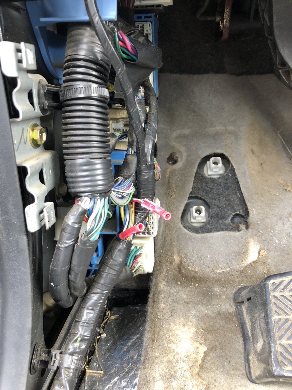

    Thanks... wasted a whole Saturday chasin my tail today! Lol
    Charged the battery. No difference. Same issue.
    Even fixed a broken circuit to my tail lights (I think). C5D33172-3752-4512-BA70-DA9F8AAA35F9.jpg
    But, alas. Did not fix it either.
    I have tore off multiple interior panels, center console, tail lights, etc now trying to chase wires.
    Will keep at it. Thanks for the encouragement and advice.
