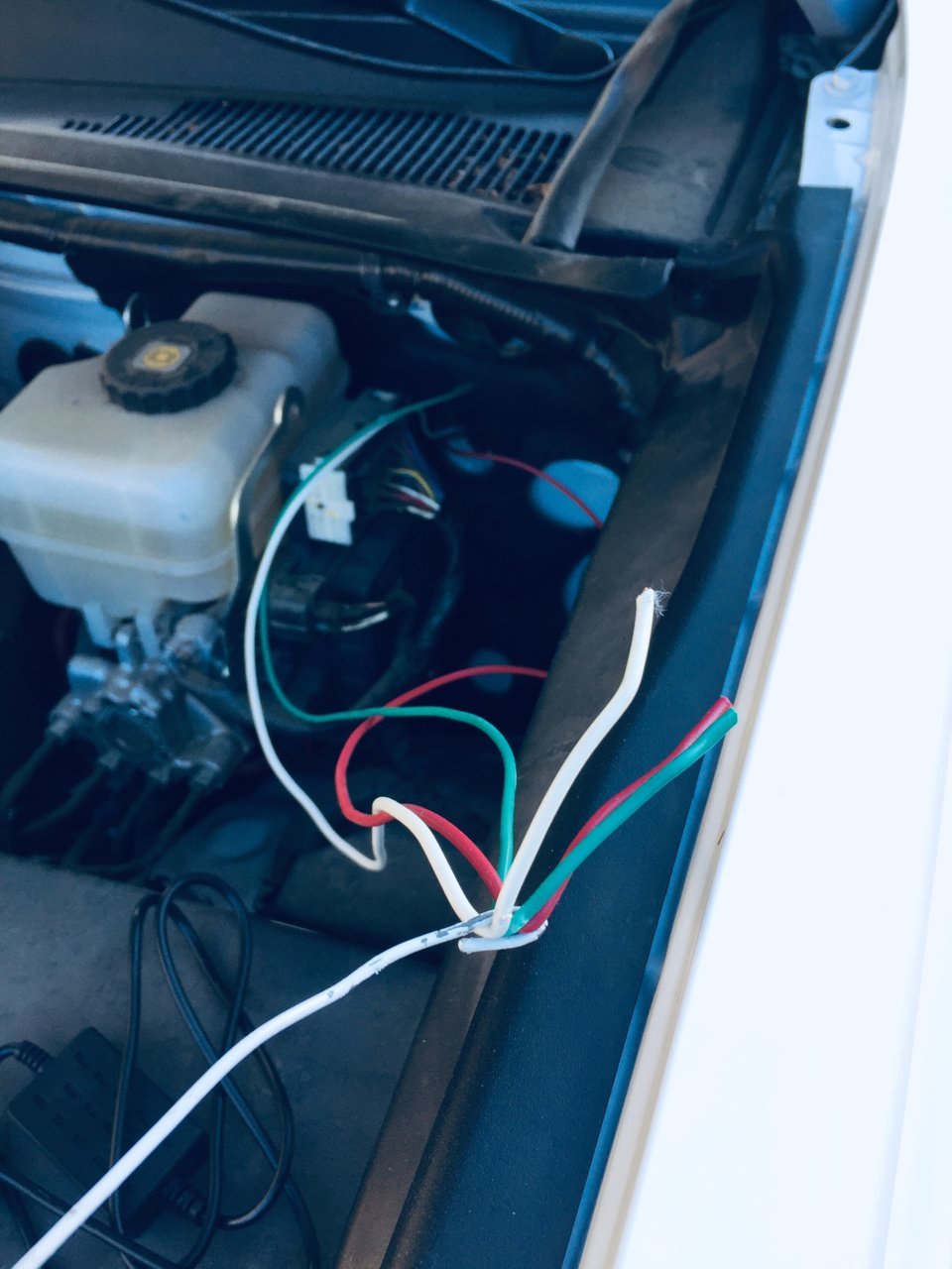

    I used the boot where to two aluminum 9AC?) lines run through the firewall, right in behind the fuse box area. This truck was the easiest one I ever had to get wires from the bay to under the dash. I didn’t punch a hole or anything, just pushed real hard on my wires and they were inside in no time.

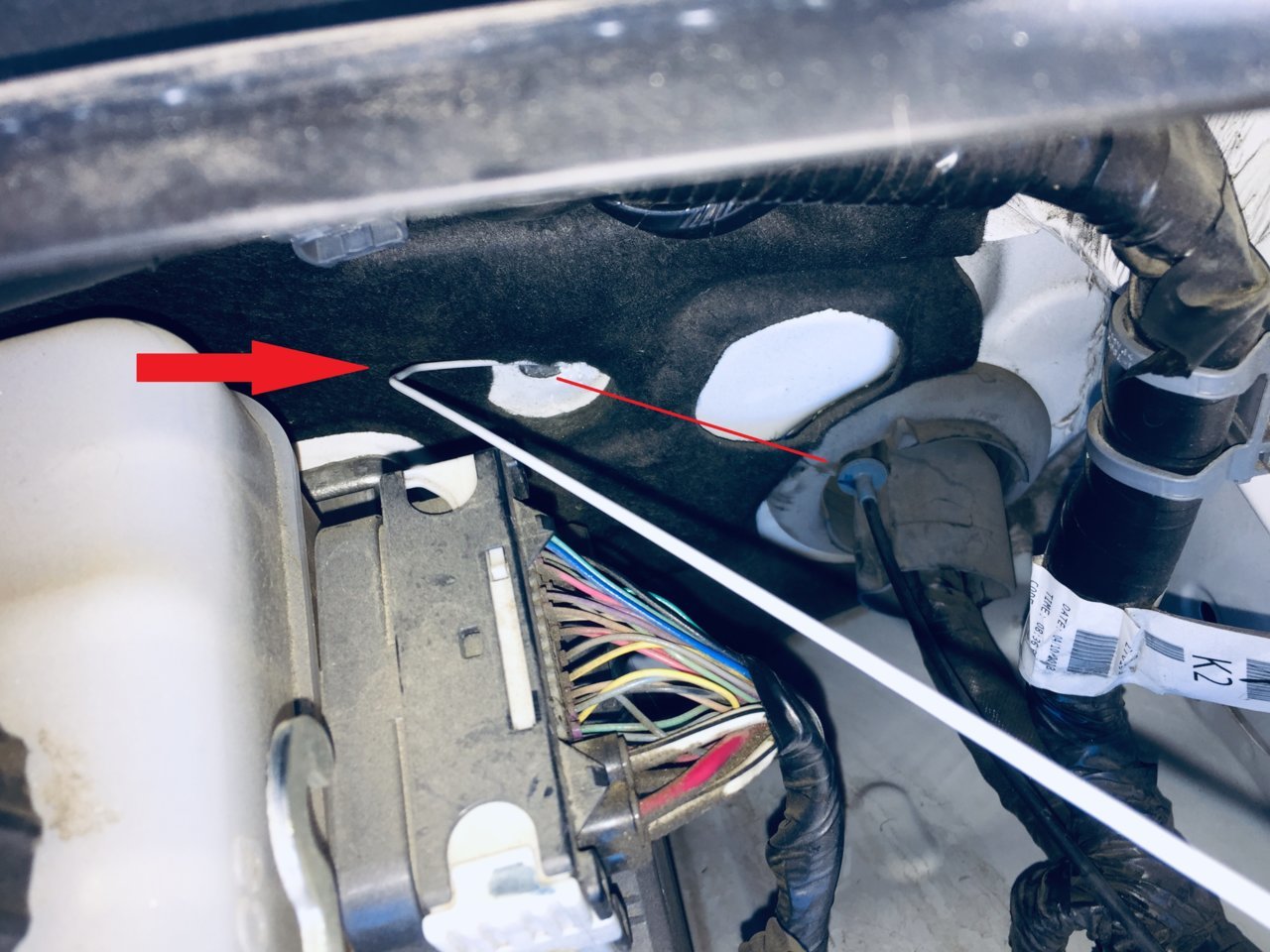

    This is what I did and used the hole from the engine bay that has the hood latch release cable going through it and yes on the inside it is covered by a 3 way cut carpet inlet on the inside

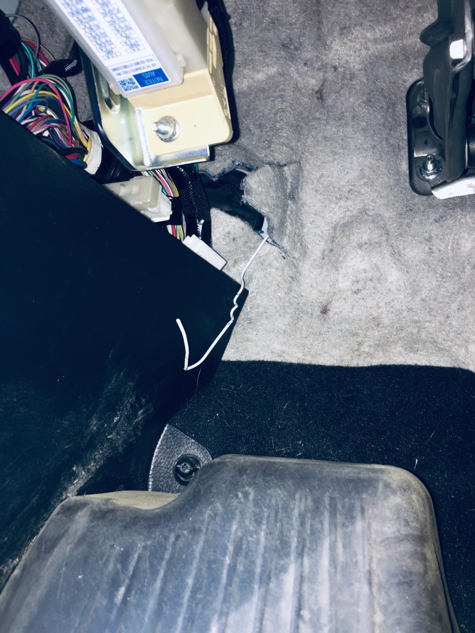

    Rather than punching a hole in the fabric of the firewall I did a little fishing from the small driver side passthrough, between the fabric and firewall to the main passthrough where on the inside you will see the fabric is slotted to peel back so the fishing can begin and end to the main fuse box.
