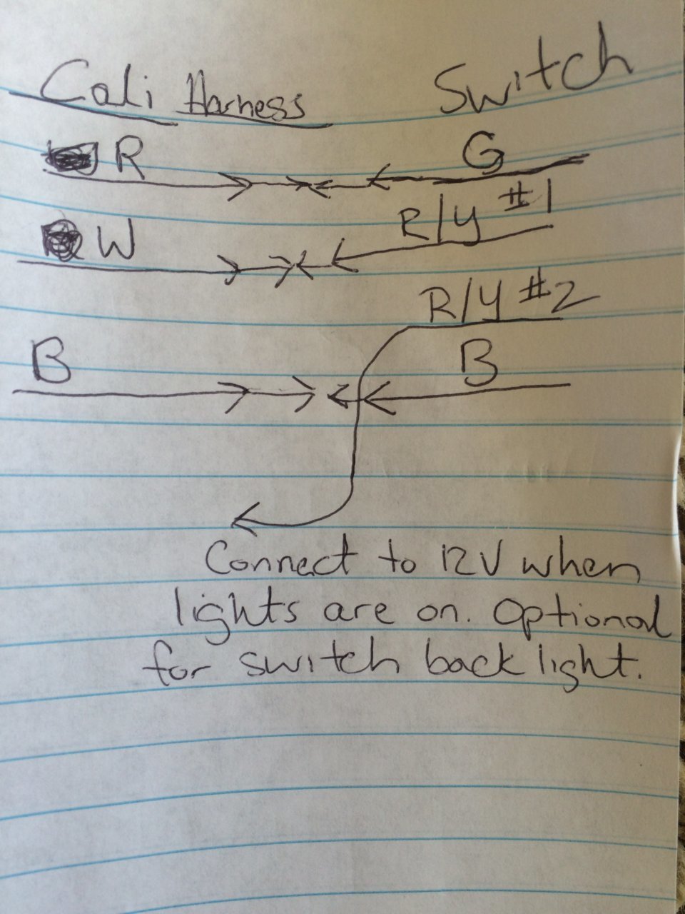

    Has anyone run into the issue that the oem style switch when tapped into the tail fuse the switch stays illuminated when lights are on but the bar is not on? My switch stays lit at all times when the tail lights are on. I was under the impression that the whole switch didn’t stay lit even when the light bar is off. (I have the blue wire taped off)

    When I turn on my headlights the whole switch lights up in both the on and off positions, not just the "LED Light Bar" portion when off and the whole switch when on. I believe I might have a bad switch.

    I followed most of the videos and online forums. My wiring harness has a blue, white, and black and I wired the switch black on black, green on white, and both reds to the add a fuse. Blue wire not used as it keeps switch on while truck is not on so I just taped it off.

    white to green/yellow.
    blue to red/yellow(next to green/yellow).
    black to black.
    red/yellow to add a circuit or stock illumination off an oem switch or circuit.
    All of my mic tuning switches are wired this way and only the bottom writing is lit up with headlight circuit. Once I flip the switch, the top icon of said switch is illuminated.

    Sounds like you definitely wired it wrong. You need 2 power wires- 1 is tied to your dash lights (dimable circuit) and the other power is the one that feeds the switch and basically loops back around to the relay telling lights to come on. You just have to think of it that these 2 functions are totally independent of each other. Are you using a harness that already has a relay and all connectors?

    I'm seeing the same problem as @Tacomaandrew1021 . I tried to swap my 12V lead to the other red with yellow stripe wire (adjacent to the black ground wire) and the light bar will not illuminate. That just back lights the switch label. So, I have the light bar switching fine, but the switch icon remains lit up when the switch is off. And I just have a one conductor wire running to my relay in the engine bay, couldn't be any simpler. Could there be a mistake on the LED circuits internal to the switch? This is how I at least have the switch properly working with the light bar:

    I reached out to @CaliRaisedLed and got a pretty quick response. The green wire actually goes to your 12V supply and the red wire nearest the green wire goes to the relay. So, starting with the photo in my previous post, switch the green and red. Works like a charm!

    8B7296A6-4C92-4845-AC6C-A9B664A55379.jpg Sounds like you’ve figured it out but
