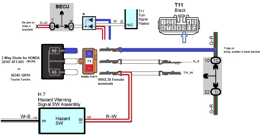

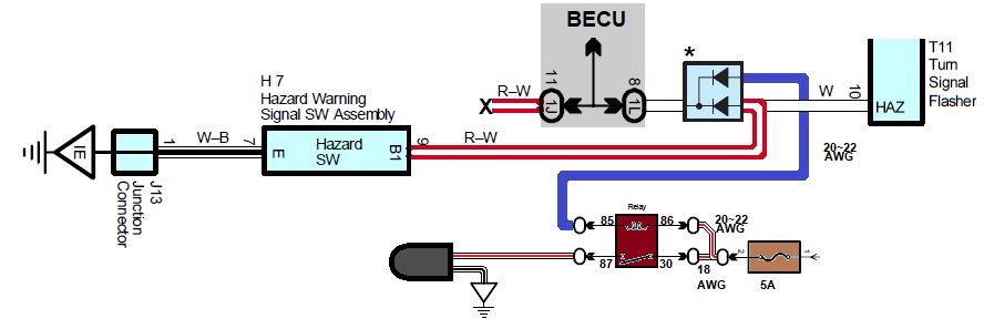

    Cool. Did you try to get it activated like the link in post #19 suggested?
    Here's a simplified one for the horn.
    The center wire does not have to be "made" it's the original wire removed from connector 1L_8 to T11_10, which needs to be.

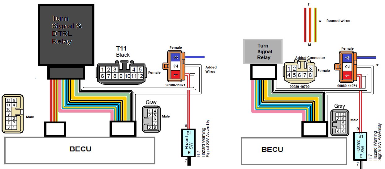

    Yet another way...

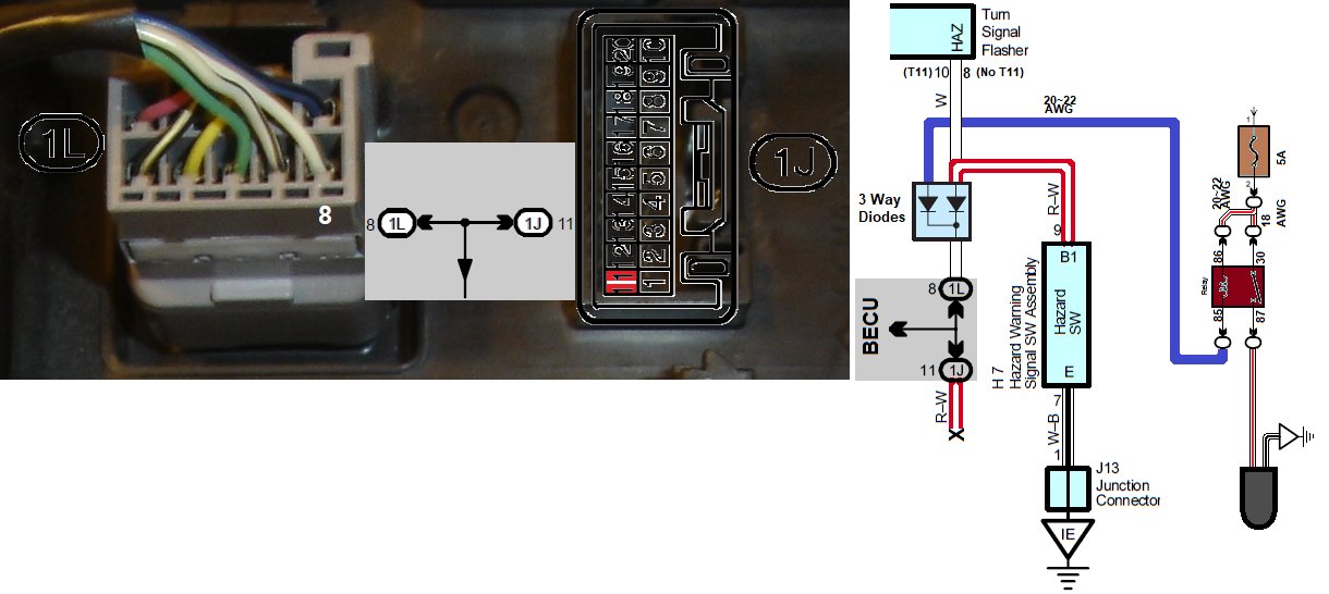

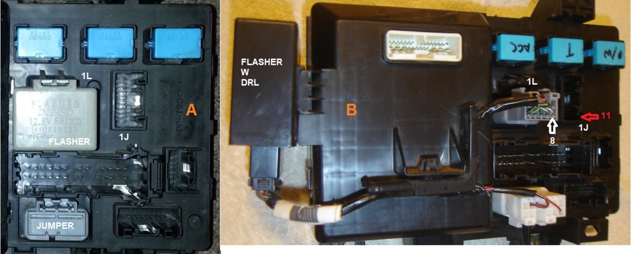

    OP, FYI, in case your Tacoma does not have a DRL Turn Signal Flasher...(12 pin vs 8 pin)
    You can get the drl harness ($15.00 approx.) Part# 82241-04030
    The 2 types of Turn Flasher setups at the BECU in the 2nd Gen.

    i also have a 05 so i can just add the buzzer ?
  8. Nov 4, 2019 at 5:12 AM
    #28
    caribe makaira
    caribe makaira Well-Known Member
    Feb 13, 2011
    #51121
    11,786
    Caribbean, Puerto Rico
    05 PreRunner TRD Offroad AutoTrans
    Hood Struts, My version Fogs always ON, Map & Overhead Light Mod,
    The "just" part is iffy...:D
    You'll need assemble a harness...

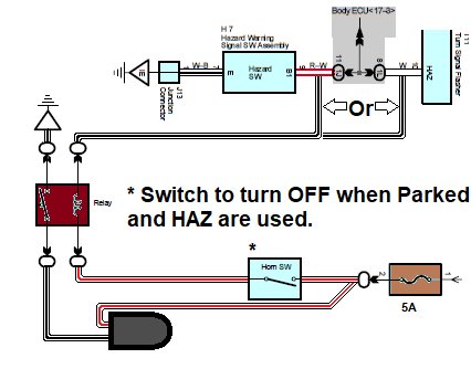

    Be sure to include a disconnect or switch for when you grow tired of the honking.

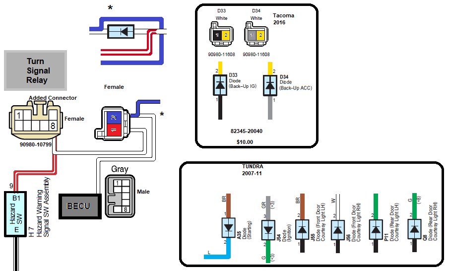

    If you can't find the 3 way diode and the connector, you could use these diodes and connectors. Tundra 2007~11 & Tacoma 2016..
    The TUNDRA ones are all the same, the numbers are for their location in the harness.
