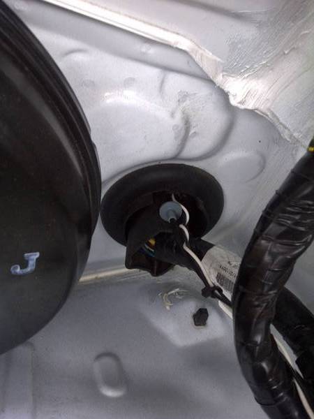

    I am in the process of adding some off road lighting to the truck. I was wondering if the only place to run the wiring for the switch through the firewall is under the drivers side dash????

    I was able to get wires through the firewall next to the cable for the hood release, on the driver's side. I pushed a screwdriver through the rubber to make a hole and then pulled the wires through. Just be careful not to hit any other wires when pushing the screwdriver through.
