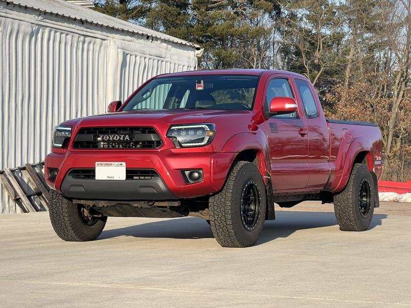

    Happy spring everyone! Its nice to see the snow starting to melt down. Best time of the year when it starts to get warmer
