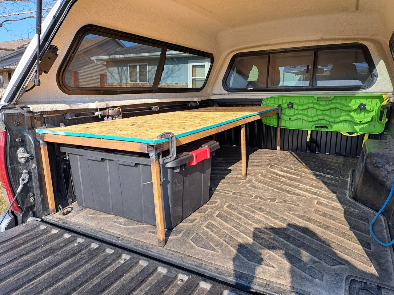

    Move your traction boards. They won't help you much buried behind your stuff :D

    They come right out. I'm a short emmeffer, the bed doesn't go all the way to the boards. If necessary, the bed moves easily. Besides, they only have to come out if I get stuck. :D

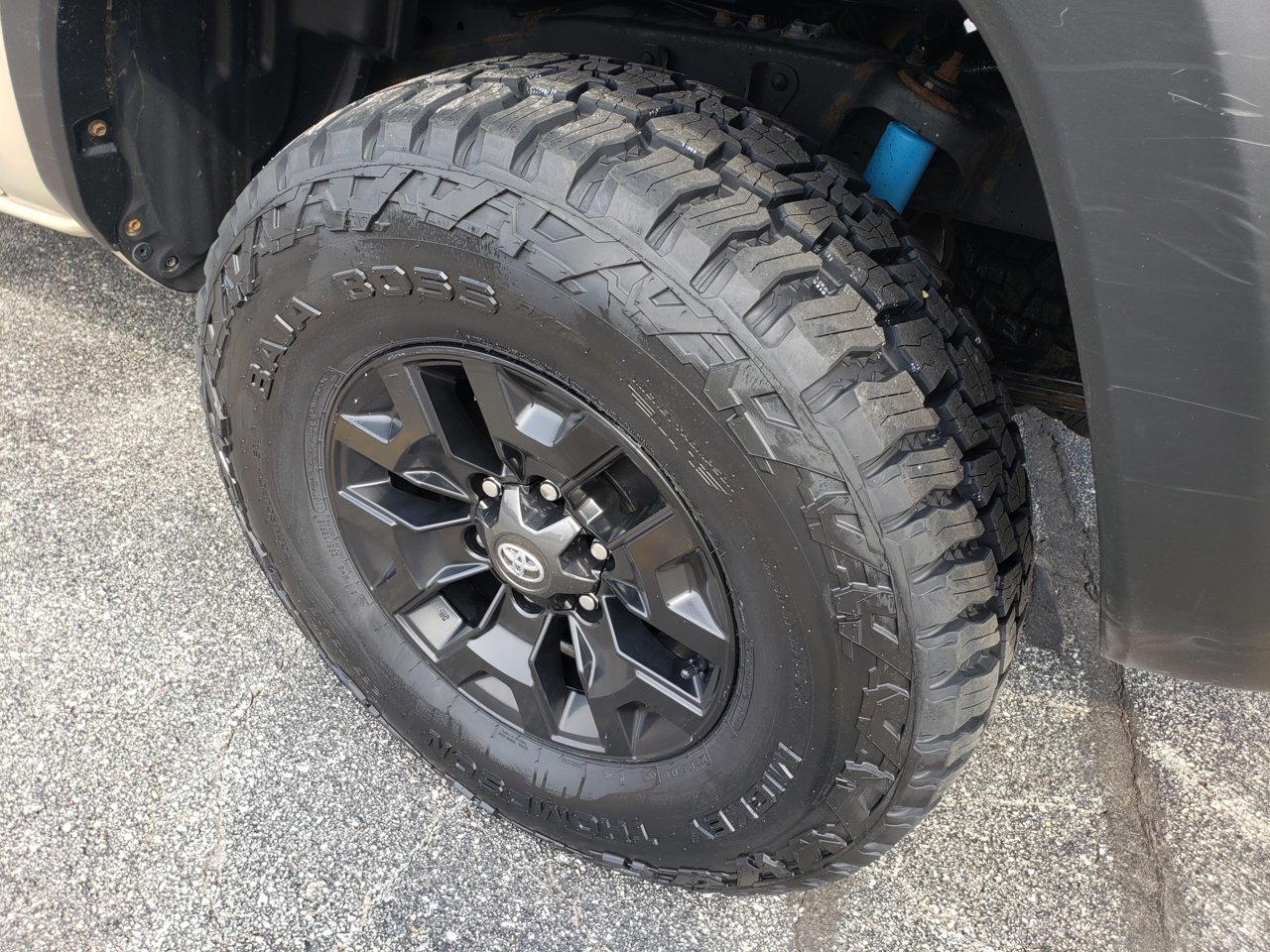

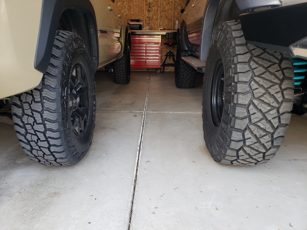

    Got the Mickey Thompson Baja Boss ATs mounted today, one size up from stock. Overkill for my use, but I dig them:
    Initial impressions are good overall. They do have road noise similar to a hybrid tire. Interestingly enough they come in at 16/32 when new in standard load, which is close to my Nitto Ridge Grapplers in load E (granted, they're not mud tires) - very impressive for a passenger rated tire.

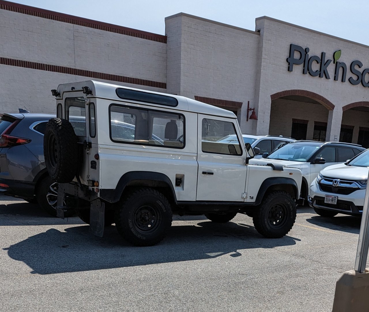

    I saw this at Pick 'n' Save earlier today. I had to stop and drool a bit, and I figured you guys would appreciate it as well.
