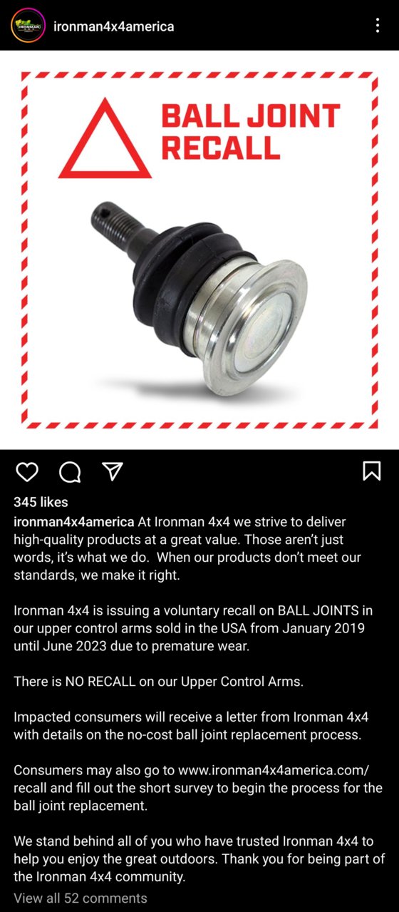

    Speaking of UCAs and ball joints...
    I give Ironman 4x4 credit for stepping up and fixing the issue. I'm waiting on my letter to get mine replaced.

    Hmm…As much as I would like to take credit for showing you the clunky hood latch sound solution for the sound you were hearing, I suppose I could be wrong and it is a suspension sound. Hopefully not, but at least Ironman is stepping up regardless
    edit: wait a minute…if the ball joints are bad…could you ever trust your tires ever again? Lol….after all, maybe they’ve started scalloping. Once they take a set, even microscopically, it just turns into a tire equivalent of a road turning into washboard. The only solution may start with M and and with a T…or I guess an N technically speaking.;)
