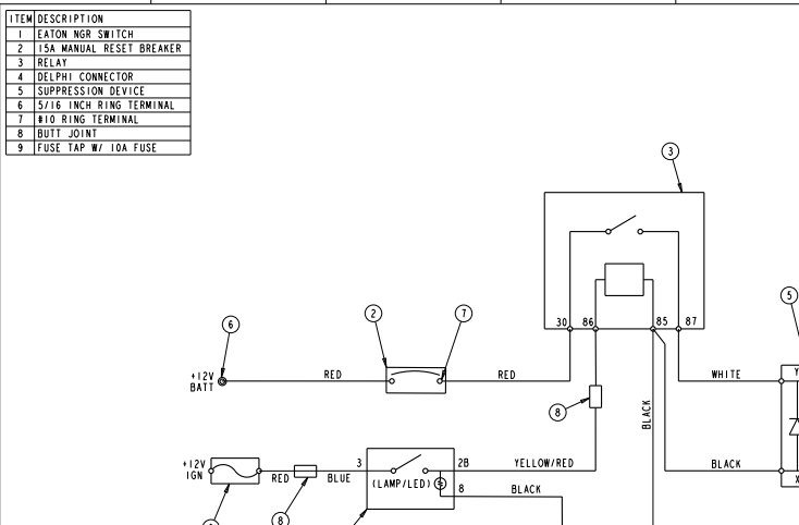

    Need some help...
    Went out wheeling the other day and got into a branch that tore the wiring plug for my Eaton ELocker apart. Looked it over and put it back together, but it wasn't working. Went looking for a fuse, but... Eaton uses a 15A Manual Reset Breaker (see #2 in schematic below.) Unfortunately, I pulled that out and looked it over without taking note of how it was oriented. I did not see any monkey business and put it back in. When I checked to see if it made a difference a bad cloud of smoke came from the engine bay... and said breaker was melty toast! Clearly I have a ground issue and I can bet it is where I reconnected the wires at the rear end. I will check that more closely. Question is: can I just put a 15Amp fuse in place of that breaker?

    Pat, I hope this helps with the orientation of the breaker. The post on the left goes to the battery. 16894210505114491487047757587676.jpg

    @pearing
    Pat, I have my Manual right in front of me. Call me if you have any questions.

    As I am running out the door -it is inside the clear plastic covered thing right next to the relay... I will take a picture later, but it looks just like a fuse but black with funky white markings on top. I do not have a breaker in line like what you are showing...

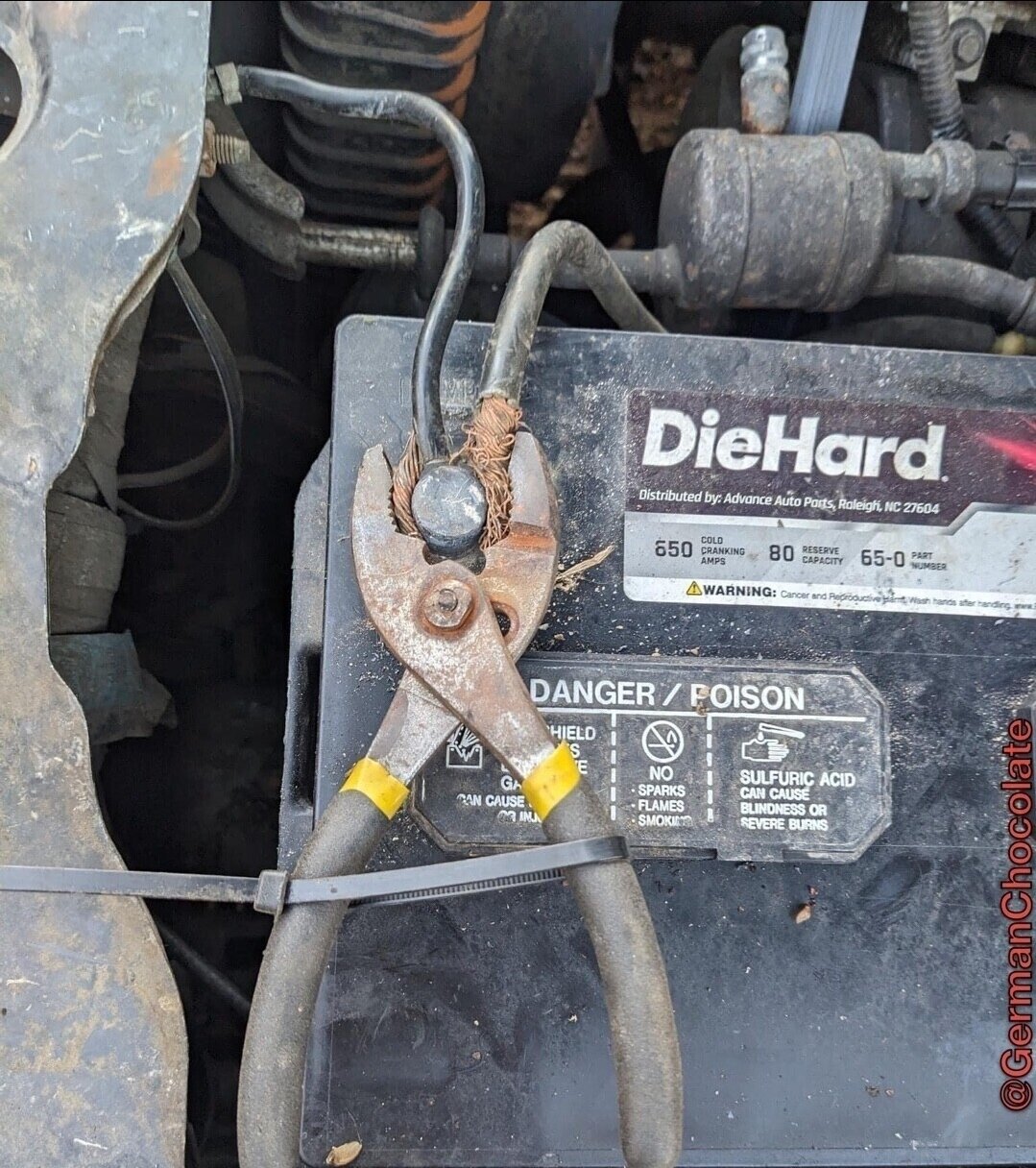

    Under the hood of @pearing 's truck :D

    Small lift, slightly oversized tires, well...
    That's cold...

    Looks fine to me.
    Red Green would approve.

    Should have duct tape holding the pliers though.
    If the women don't find you handsome, they should at least find you handy.

    Duct tape was "over there". Zip ties were within reach.
