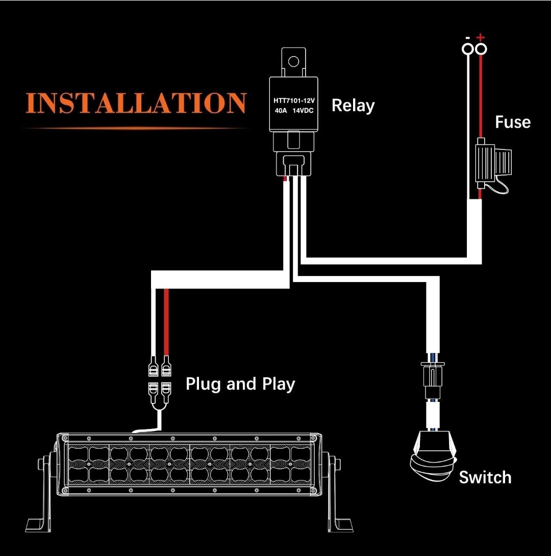

    This should help explain it
    https://youtu.be/Cq2WVUOxIfE
    Just don’t use vampire clips like that guy does off the high beam. You can just run a fuse tap to the fuse box under the hood to the high beam fuse
    basically you just need something to send + to the relay. That’s all the switch is doing. A relay is just an electromagnet that closes when power is applied.

    I am VICTORIOUS! Locker works. No fire. All is well in the universe.
    Relay was toast. Had a MUCH better one in a box, so... rewired in a new relay and fixed the wires down below. Winner, winner, chicken diner!
