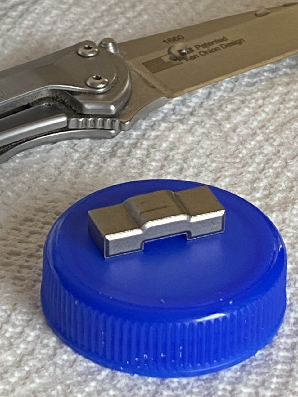

    I’m gonna need some help from the experts here.
    I know at least @Supr4Lo has been inside a transfer case. And @CygnusX191 is a tech if I’m not mistake? Manual 4runner transfer cases aren’t quite the same as tacomas, but there might be some commonalities, so I’d thought I’d ask.
    Yesterday I tried to engage 4wd while at around 20-25mph, but the thing grinds loud. Enough for me to stop trying immediately. It’s never done that before. When I stopped the vehicle, it would shift into and out of 4wd just fine. Tried it again while moving a bit slower, and it ground again, yet shifted just fine while stopped. Yeah, that’s a problem.
    Basically, I’m no longer able to “shift on the fly”. It otherwise drove quiet and fine in 2wd on the drive home. When I got home, I turned the front driveshaft by hand in 2wd, and didn’t like the sounds of it. Kind of a creaking sound once per turn.
    That was yesterday night. Today I drain the transfer case and hear this little fella fall right to the bottom of the milk jug.
    I’d just rather put it back inside and call it a day, but something tells me it has other friends at the bottom of the transfer case.
    My question to the learned brethren among us, any clue what this is? It doesn’t have any break marks on it, and it looks like it might have served as a key of some sort to hold something in place. I’m afraid whatever it held in place is….umm, no longer in it’s place.
    I’m wondering if this be an easy internal fix that would make it worth splitting the case for, or if it’s better to get a new one. It’s a 21 4runner Off-Road with manual Transfer case.
    This is the last thing I thought would have a problem, and apparently seems rare? Searching the various forums only led to one example of someone else losing shift-on-the-fly on with a manual TC (with no real answers or info besides the problem).
    I’m going to give it a try at the dealer with a warranty claim, since Im at 50k mile. However, I’m preparing for the worst. The worst would be getting a brand spanking new TC assembly myself for about 2500 to 3000bucks, which sucks, but not the most horrible thing in the world if I throw in there myself. Or doing a benchtop case-split if one of yous guys thinks the AWOL piece suggests an “easy” internal fix.

    That's a synchro detent for the 2wd-4wd shift. And that would explain why you couldn't shift on the fly. The case is going to have to get opened to fix.
    The manual I attached is for the NWF eco-crawler but has how to put them back in starting on page 17. But for them to fall out in the first place makes me wonder if something else is wrong also.
    -edit they also had a manual how to just install the shift detents. I attached that as well

    @McSpazatron, Rhine auto salvage in Plymouth has a xfer case from a 2018 4runner with 55K miles on it for $250. That comes with 6 month warranty also. It's an easy swap.
    I was thinking about buying it to have for spare parts.....

    Go for the warranty claim first. Toyota takes that stuff very seriously. As they give you any beef about it because you try to do it, drain and fill that void the warranty or whatever other BS they manage to come up with... Let me know ASAP.
    Them's fighting words, sonny. Good luck getting a Toyota warranty claim done somewhere that isn't a dealership lol
    Excellent
    That's a good price. Buy it anyway for... Reasons...

    Haha! I absolutely knew you’d know!!! Lol. Fantastic. Yeah, I figure that little part has friends it left behind inside, but probably broken-er looking.
    Well I better check on that before you snag it from me lol. Not opposed to a used transfer case that works. Just gotta see of it will work for my trim level.

    Don't forget to bring the part with you. Tell them it fell out of the drain plug just like you told us.
