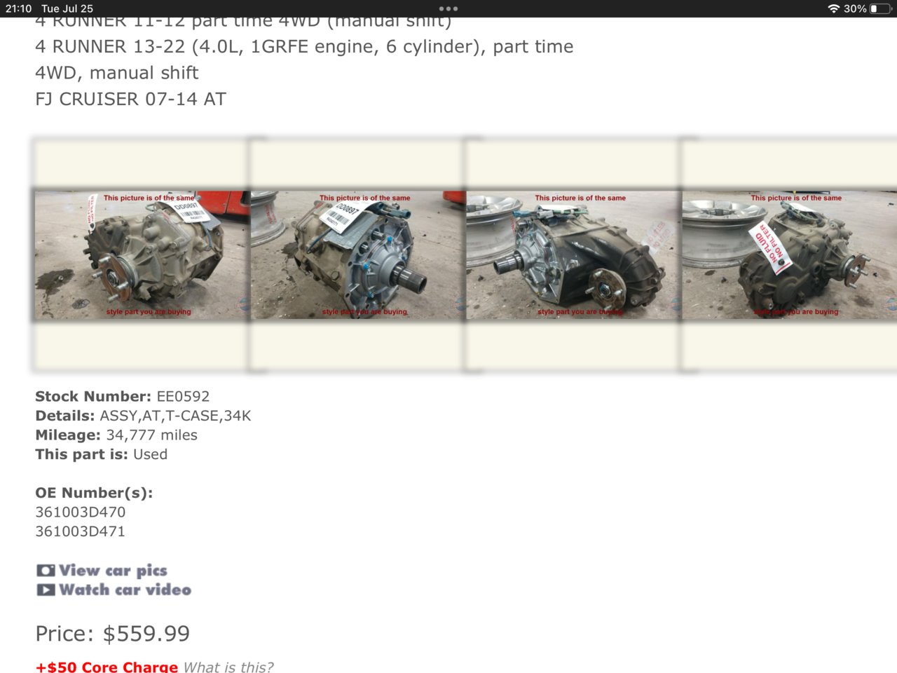

    Did a couple of quick checks: LKQ has 4 listed, 3 in CA, 1 in FL, Cousineau Auto up here in Appleton has quite a few, but nothing newer than a '14.

    Really appreciate those links. This is a stupid question, but when these come without the shifters, I would imagine I dont have to split the case to get a shifter put back on? Some stuff is easy to take out, but hard to put back in lol.

    I did a search last night after work. Local place Diamond Auto has one from a 2017 but with 95k miles and they want $500.00
