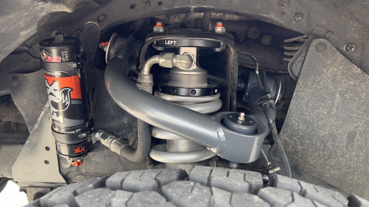

    Just got the alignment done Monday. I only got 2.8 degrees caster out of the new UCA and feels like I lost a touch of clearance to the cab mount/firewall versus the SPCs but it feels rock solid. Also your fancy 3rd gens seem to have a bit more clearance from the factory than our 2nd gens. I think it would clear without modifications but I just don’t want to risk it and have surprises on the trail. Will know more later tonight after some percussive maintenance.

    I've have seen it mentioned that alignment machines don't take UCA caster into account, but don't know that to be a fact. So technally you might be at 4.8 degrees of caster.
    I forgot that you changed your UCA's. So in fact you might have lost a little clearance as most UCA's add positive caster which moves the top of the spindle rearward. With the SPCs you can add negative caster clocking the ball joint forward which in turn moves the top of the spindle forward.

    Alignment machine should take the built-in UCA caster into the spec. When you do the initial reading and turn the wheel lock to lock it measures caster at the wheel itself. These JD Fab arms seem a little shorter from bushing to ball joint (i.e. from where it mounts on the shock tower to the ball joint pivot) so I think that’s where it loses fractions of degrees. I still don’t think it’s any less clearance than the SPCs but it really does become a game of inches.

    Any modern machine will take into account as UCAs when it gets its laser level reading. If the tech can't do it properly then he doesn't need to be doing alignments.
