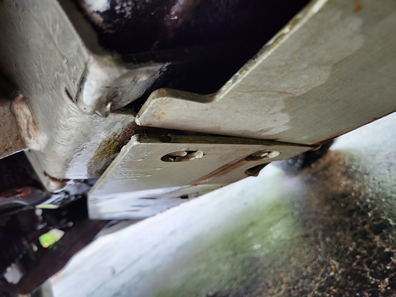

    Doing a pressure washer pre-rinse b4 the real cleaning tomorrow. Umm... my skids don't line up anymore. But I can still slide forward. 16920569227282664707224705479345.jpgI⁷

    Maybe, 'cause if these ever come off, pretty sure they won't go back on.

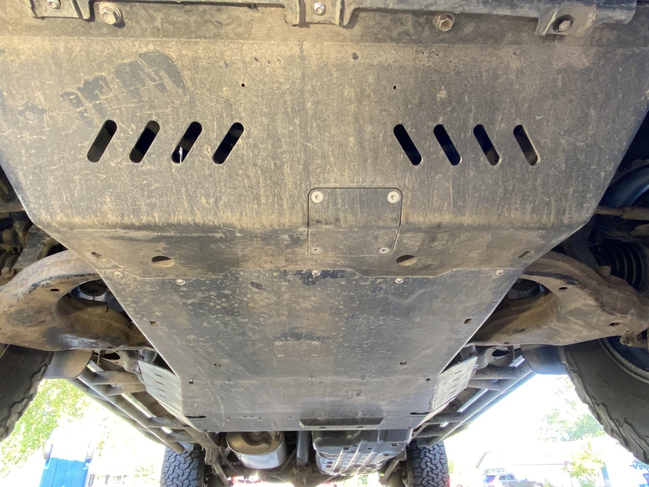

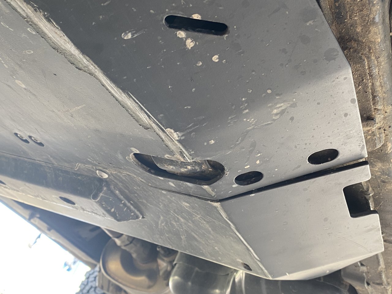

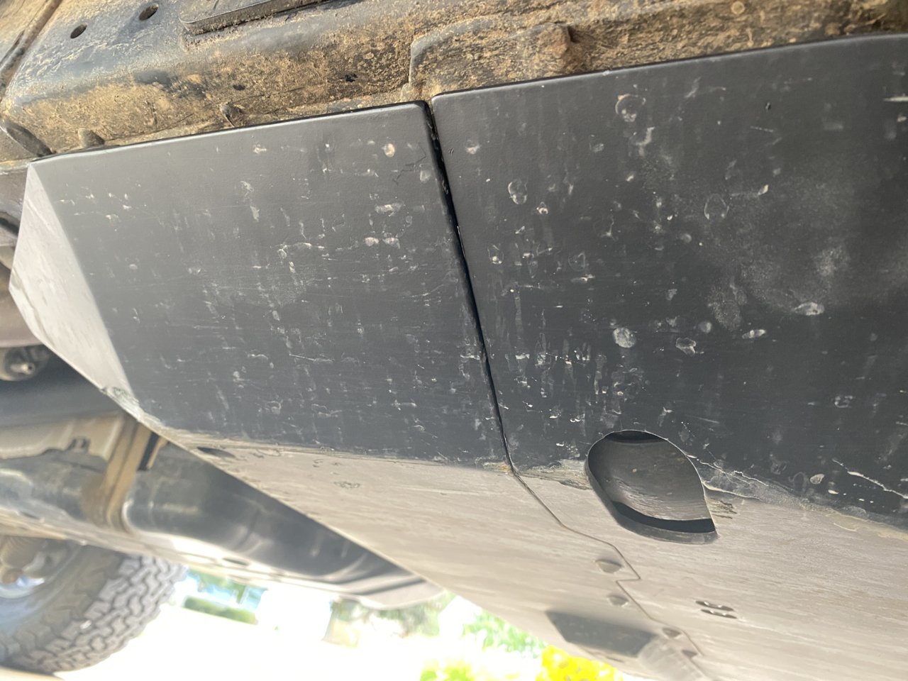

    If you’re referring to mine, you might be disappointed lol. When I was installing mine, I noticed they didn’t line up perfectly around the sides on the trans/crossmember skid seam. Probably a manufacturing thing…
    In my case, the transmission skid “wing” is slightly lower (deeper) than the transfer case wing. I’m sure mine are that way because I don’t have the 4x innovation sliders pushing those wings out. I could probably shim them to be even. Your wings are “out” a bit because of the your sliders take up under there.
    Looks like I rubbed a little at that seam and nothing got torn off. I don’t think it could anyway because all these plates are interlocked like puzzle pieces front to back, along with each plate having frame mount bolts. If one plate gets torn off, they all get torn off…. Along with everything they are attached to lol. It’s more likely they would either self-clearance by metal removal, or the rock itself is made to suffer.

    They are borderline too significant ;). It’s a lot of weight, but these skids seem to be the best at protecting the LCA mounts. I was myself thinking of running just the front two plates, and leaving the transmission and transfer case skids off…. But I like the exhaust cross-over protection of the transfer case skid.
    The transmission skid plate is a little overkill since nothing really gets really that high up in there. Unfortunately, I can either run the front two alone, or all of them. I can’t run it with only the transmission skid removed since the rear transfer case skid depends on it for strength.
