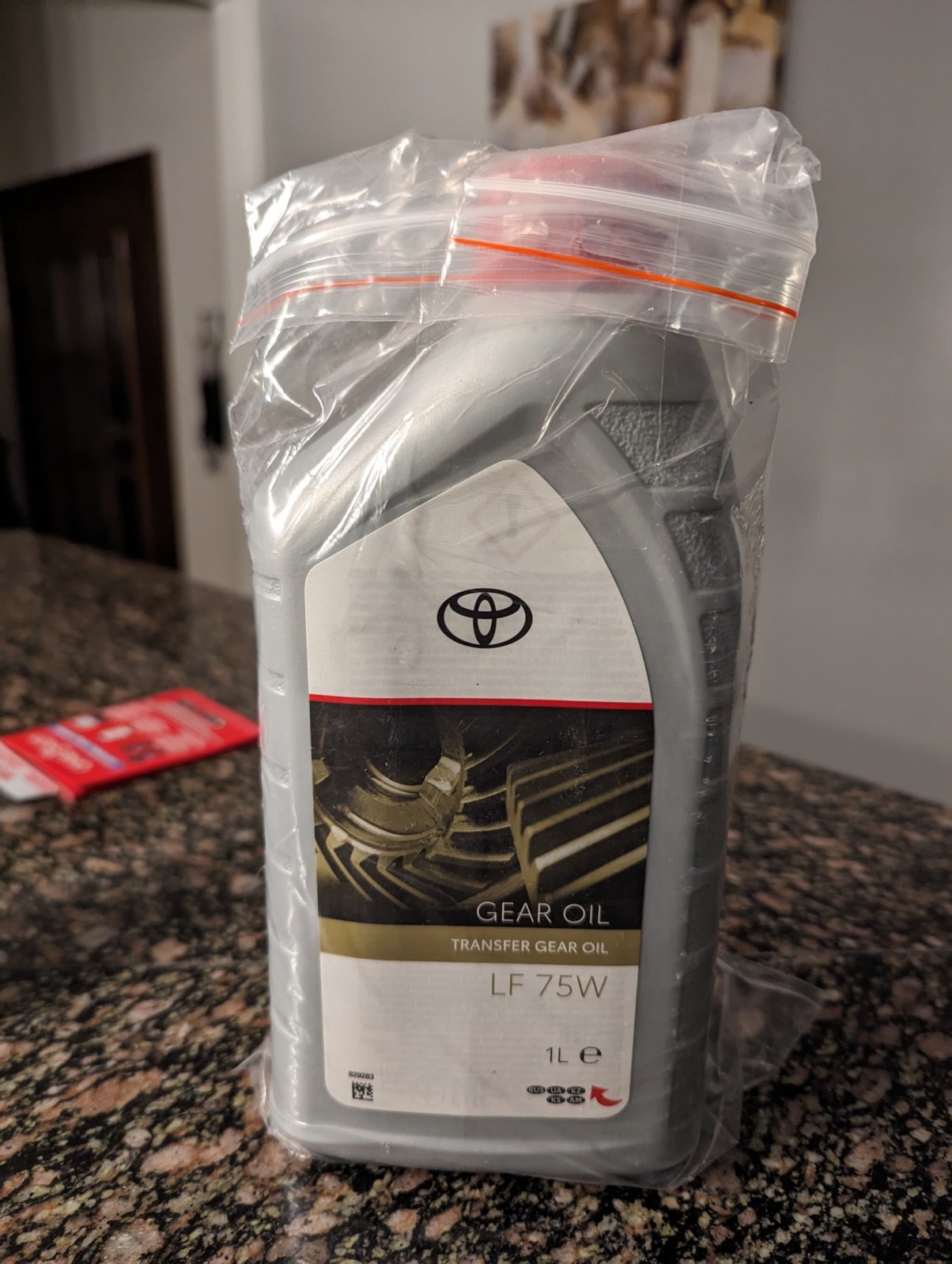

    spending a c-note on one liter of dino oil has to be the worst financial decision ever made in this thread!
    Now for the hundred dollar question,
    who makes said gold?????

    Doesn't matter. Toyota put their name on it. There may be many other reasons they they can deny me warranty service, but not the oil.

    Like I said, I got bored reading the debates, but some pointed out that other brands/types had phosphorus additives or something that can cause corrosion on yellow metals that are in the transfer case (brass or something). That stuff may show up on an analysis, I dunno. Didn't mean to create a debate here. My $100 for my peace of mind. Not even close to my worst financial decision.

    GL5 oils contain more phosphorus. Any GL4 should be fine for yellow metals. I use Redline MT-90 in the trans and t-cases. Redline MT-LV is listed as a suitable replacement for liquid gold on their site.
