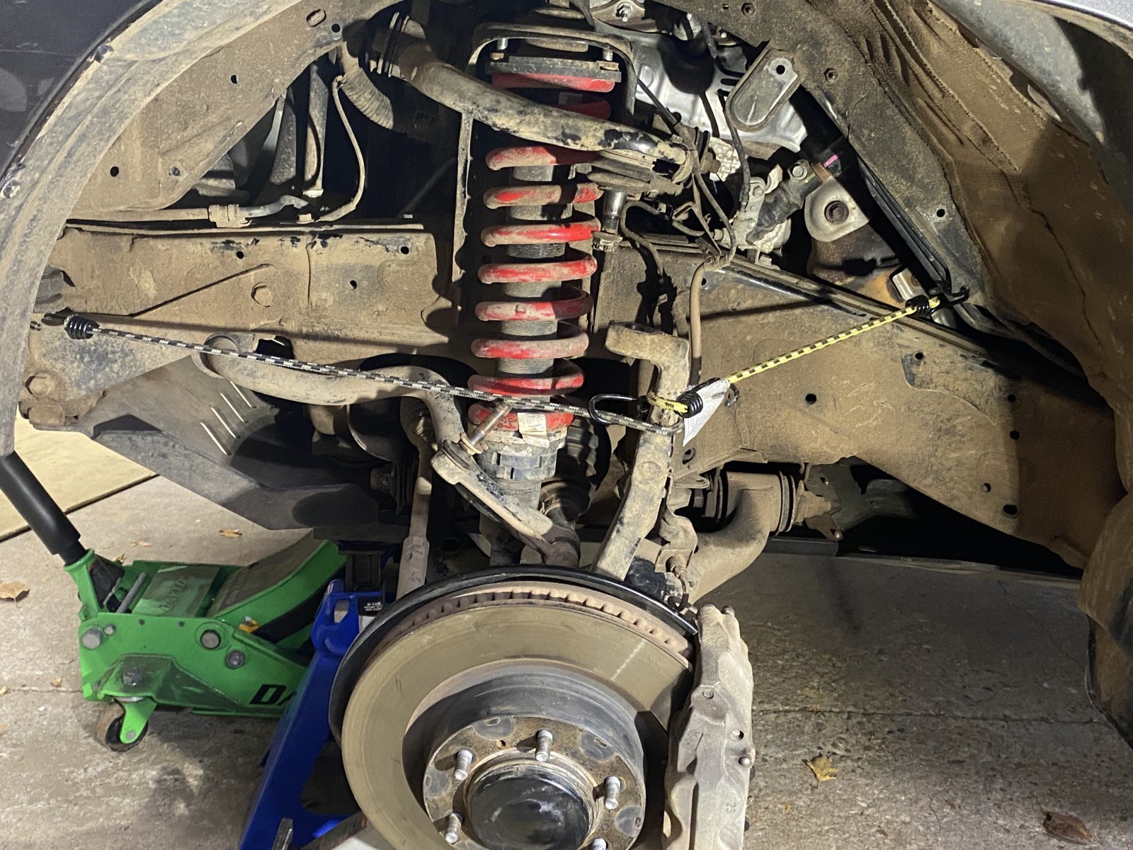

    When I initially installed my suspension, I loosened the LCA and separated it from the lower ball joint. It was pretty easy.
    @wi_taco told me about how easy it was from the top side, so I gave it a try today. I only removed the sway bar bolt from one side, but not sure it was even necessary to do that. Other than that, it’s really only removing the one upper ball joint bolt, and the brake/abs wire brackets.
    So if we’re counting the important bolts, it’s basically one bolt, and swing it up. Nothing is ever that easy though lol.
    Going from the top lets you avoid the possibliitg of knocking it out of alignment , and more importantly, avoids having to retorque those LCA bolts, which is a real pain in the ass when the wheels are on the ground, no clearance to swing the torque wrench, and no really good way to get your body situated to get enough grunt on the wrench. I mean, I can do it, but it kinda hurts, especially the next day. :p:D

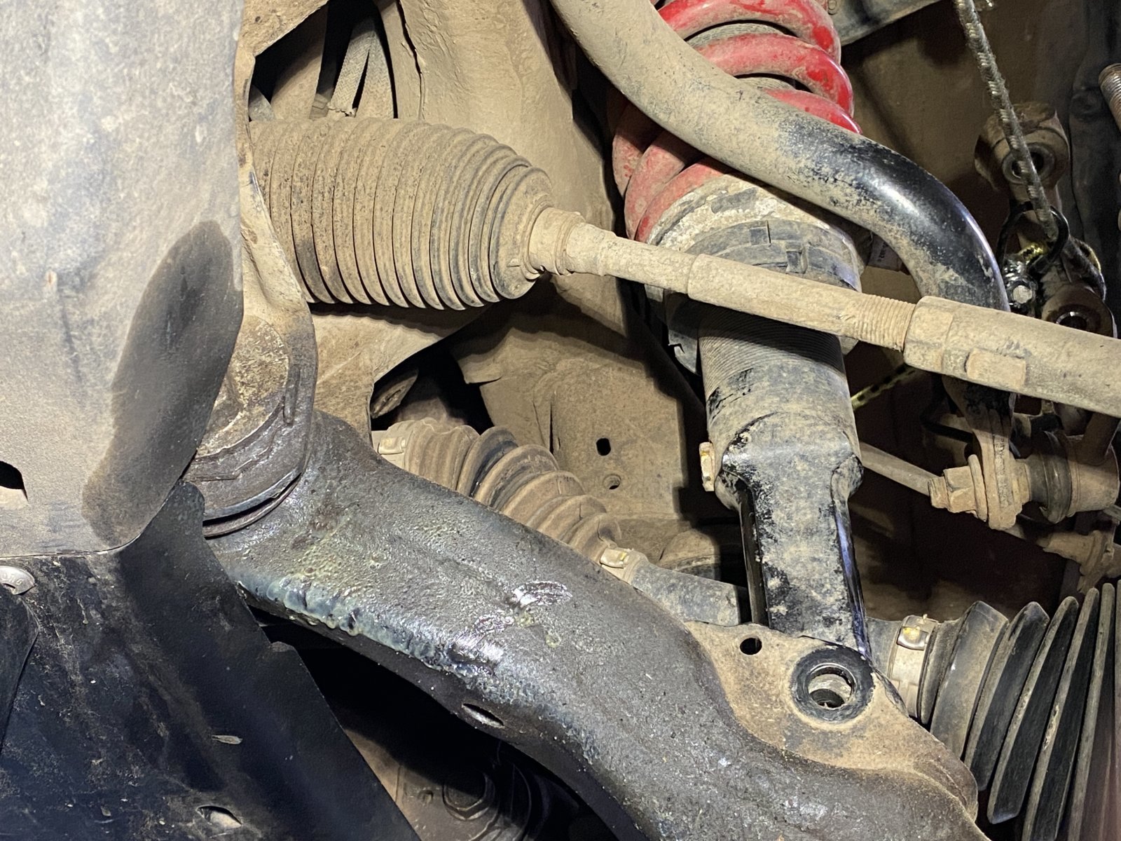

    My only mistake is that I didn't account for your monster bomb-proof 4xInnovations skid plates. It's actually good they protect more of the LCA cams, but in this specific case it causes more work having to remove the skid. I'd still rather remove the skid than have to worry about tweaking the alignment.

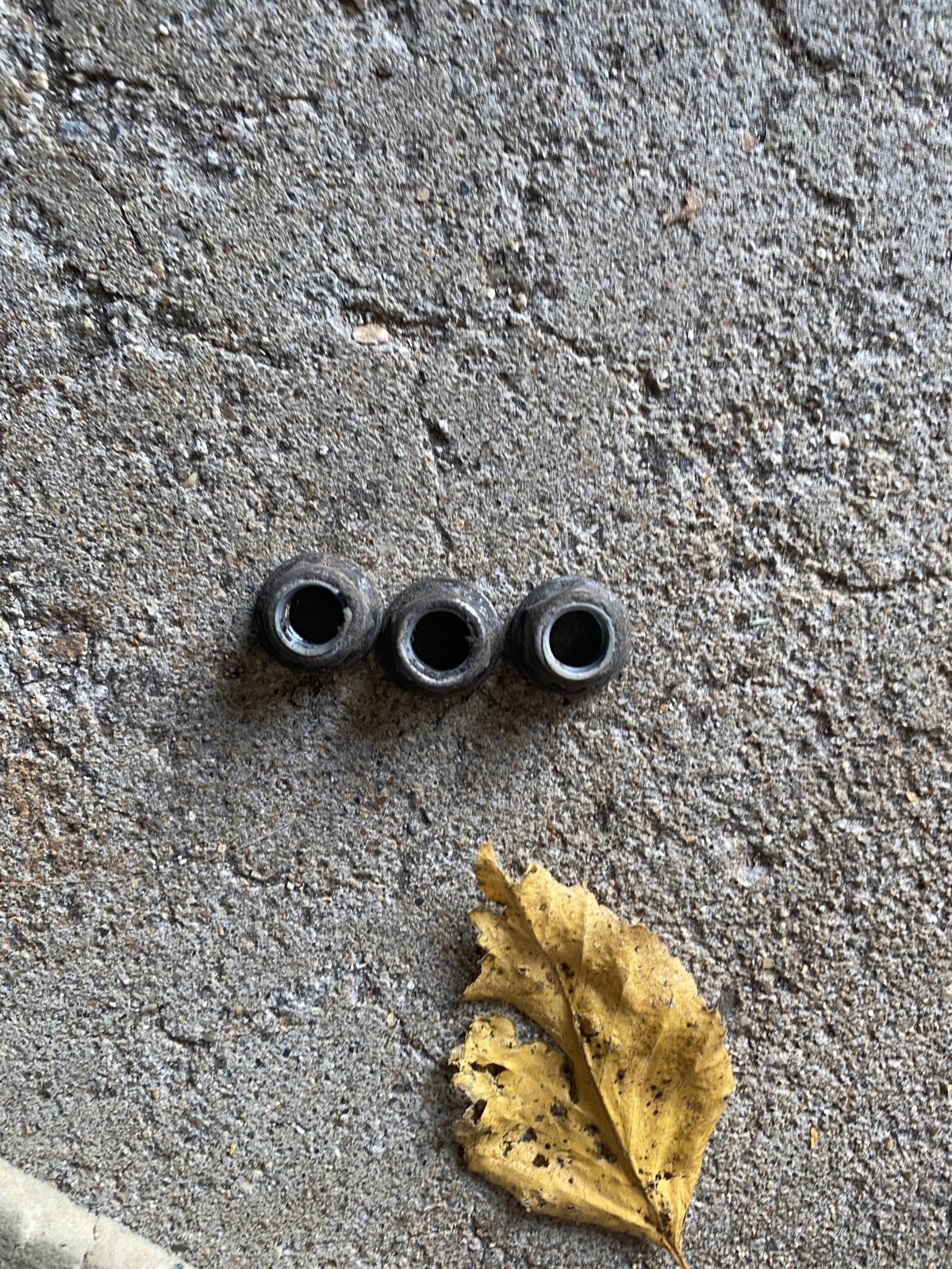

    What I thought what ovaled-out, was in fact just the locknut plastic liner at the top. You can see it broken on the one on the left as well. Regardless, I’ll be ordering a couple of extra sets, as recommended.

    I was wondering the same thing lol. I believe it allows full extension for a normal travel shock, judging from this pic. 78797B37-A5EC-4447-8324-B2360D8D973F.jpgThis pic shows the shock unbolted from the top. The bottom is also unbolted, but still sitting in the pocket of the LCA where it bolts up. Here, the LCA is extended as far as the skidplates allow. The coilover assembly is fully extended. The space between the top hat and where it mounts in the shock tower shows it could droop a good amount more than what the standard length shock will allow.
  17. Oct 29, 2023 at 7:25 AM
    Camerasandcoffee
    Camerasandcoffee 900hp short of 1000hp
    Aug 26, 2019
    #303375
    1,886
    Jonathan
    Racine WI.
    2019 Trd Sport
    Relentless Fab hybrid bumper, 2.5” Dobinsons IMS lift, RCI skids and sliders, block heater. Painted FJ Steelies. Was trying to keep it stock, now slowly building for the Wisconsin trails.
    Dobinsons IMS are extended travel vs stock shock. Regardless, your photo shows the skid isn't interfering with full downward travel.

    Damn, you might consider cleaning that area since it’s exposed. It’s not shiny at all!
