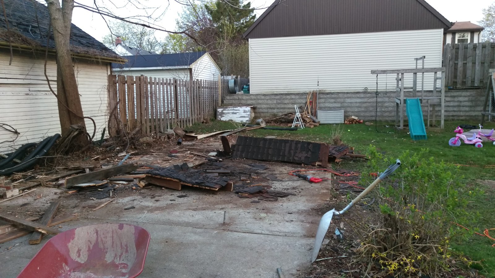

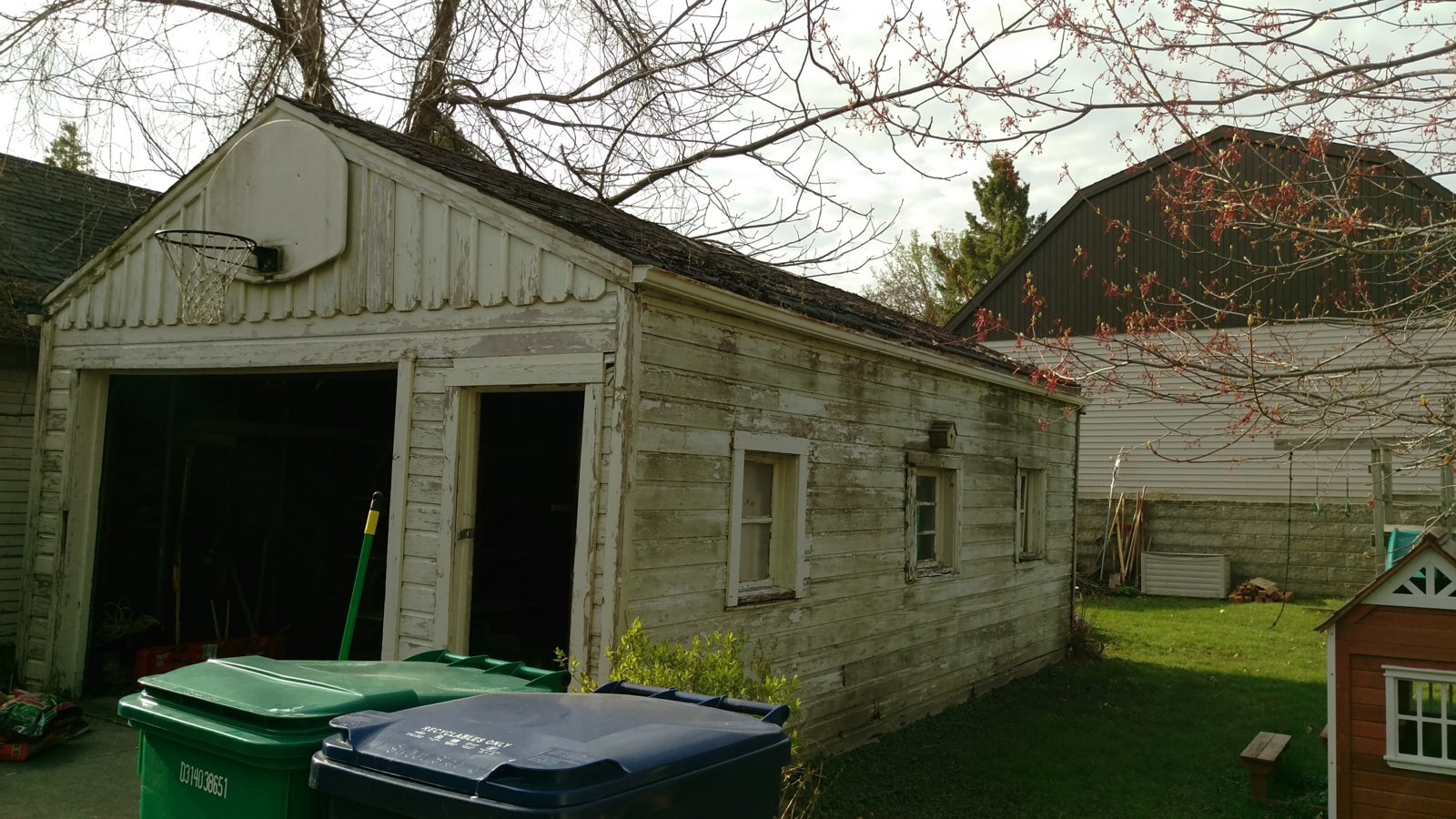

    Wow... yeah, that's only slightly worse than what I had when we moved here.
    8:00 am one fine May Saturday:
    7:30 pm that same day:
    A new slab was poured and the new garage is 22'W x 28'D which I thought would be more than enough room for my woodworking tools and a couple cars. Those damn tools multiply like rabbits though, and have taken over the whole garage.
    (Notice my neighbor's lofted garage in back. Yeah... :drool:)

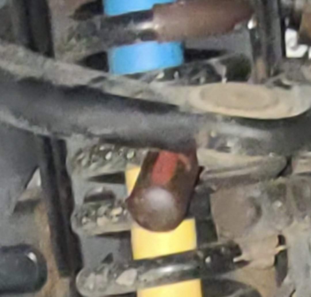

    Looking closer at the image of ecgs install you'll see I have a big screwdriver supporting the uca on the spring. The uca never had the opportunity to drop low enough to stretch the line.
    (The screwdriver is what I had closest to me and it held the spindle solid so I left it. :D)
    Will just reset ecu like always and go from there. Was getting a feel for how the brakes were acting 1st.
