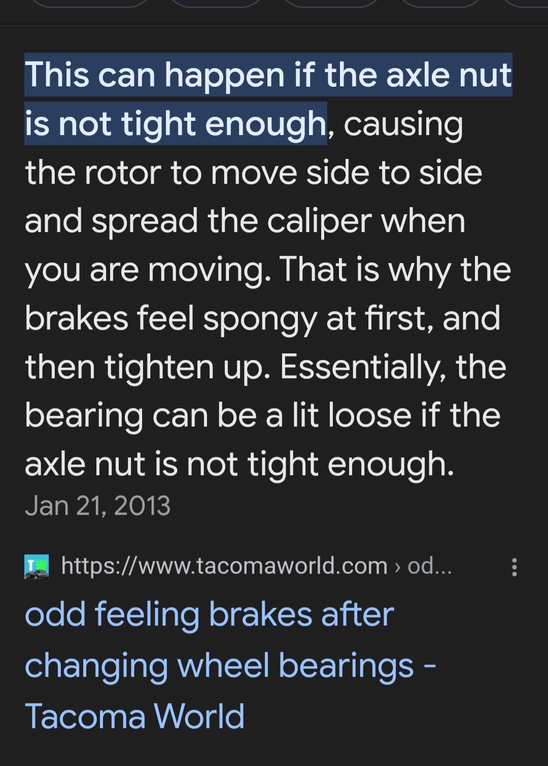

    @bkhlrTaco's your brake issue sounds simular to what I had after doing my ECGS bushing on my last truck. Did you torque the 35mm axle nut to spec (can't remember of top of my head 175ft/lbs?). I thought mine was torqued all the way but it wasn't and that allowed the hub assembly to walk out some because the bearing races aren't caputed. Which would open the pads in the caliper in turn took a few pumps to tighten them to the rotor again. And rinse repeat. That was the last thing I checked after troubleshooting everything and the axle nut wasn't tight....

    It was the axle nut.

    Glad you found it before the bearings got destroyed. Bad design, if you break the splined spindle side of the CV axle you can't drive because it holds the bearings together.

    Kind of thought a shake or wobble would accompany a loose axle nut though truck rode smooth as ever.

    Yeah, mine rode fine also.

    This is great stuff! I was racking my head wondering why a loose axle nut would lead to spongy brakes, and this makes perfect sense now.
    This also made me get how @sparkystaco loose lug nut suggestion could do the same thing, considering that rotors could move around and push in the brake pads. I’m learning!!!
