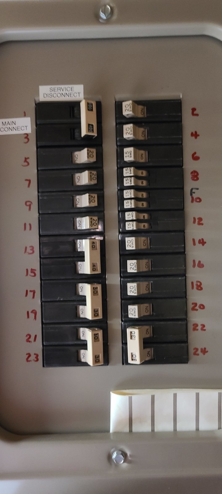

    Ok. In order to have a worthwhile electric heater in the garage, you'll have to run at least 10awg Romex back to the panel. But, for the King 7.5KW, you'd need 8/2 and a 40 amp breaker. And, this is dependant on your panel having space for a 2-pole breaker.
    This still might be easier than a gas heater, though, as you'll probably still want a dedicated circuit for the fan (probably only 15 amps, though).

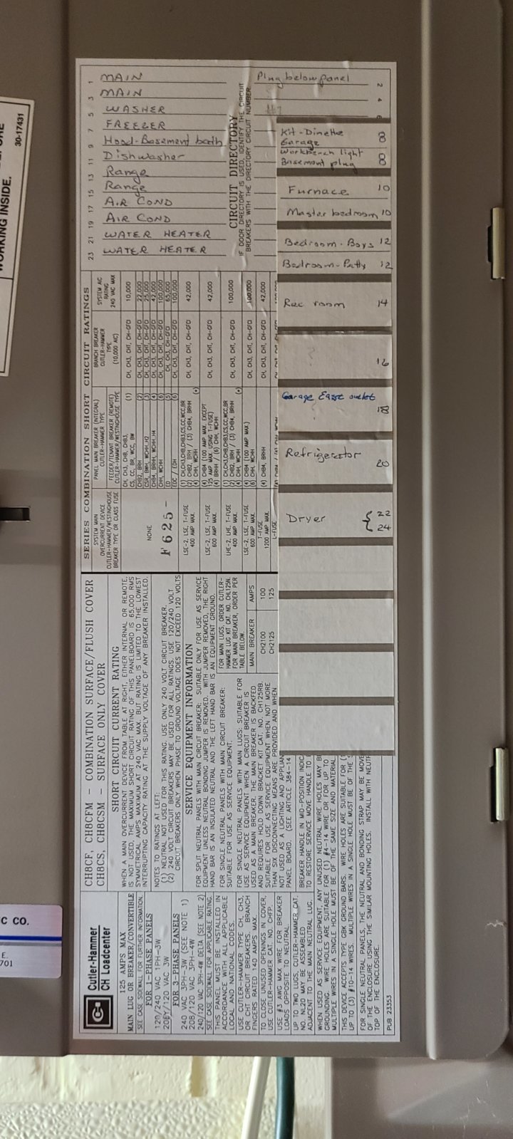

    legible if zoomed in

    Depends on your needs. I'd probably want a dedicated 100 amp sub-panel if I were building a proper garage/workshop. Think about welders, air compressors, tablesaw, etc. But, for regular use, a 20 amp outlet circuit is probably sufficient for most people.

    Yeah, that's full and you already have some tandem breakers. You could put the (4) 20 amp circuits on the right in tandem breakers to make room, or add a sub-panel. Could be a bit of a strain if you decide to use the range, do laundry, and run the heater at the same time. But, I think you'd be fine.

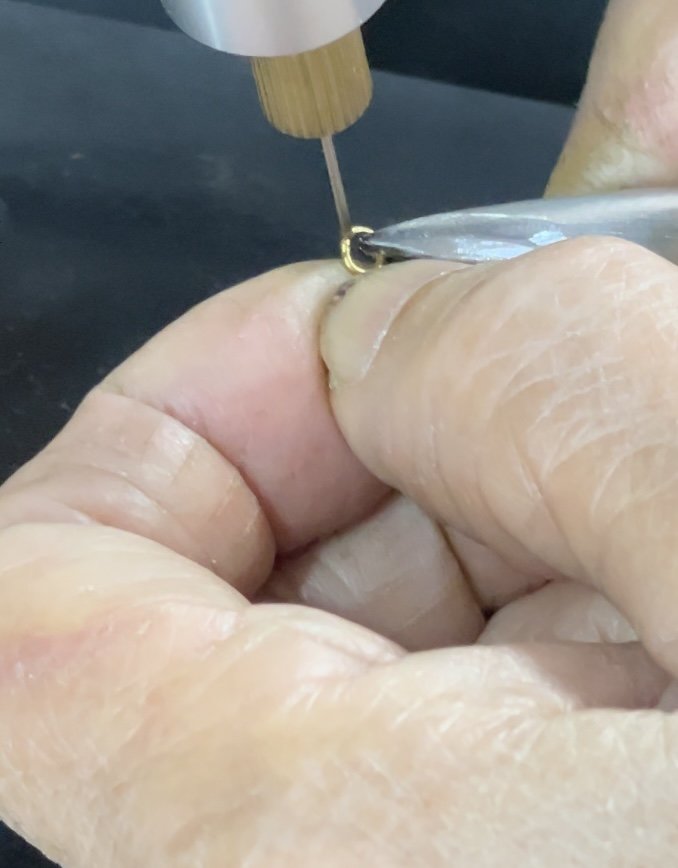

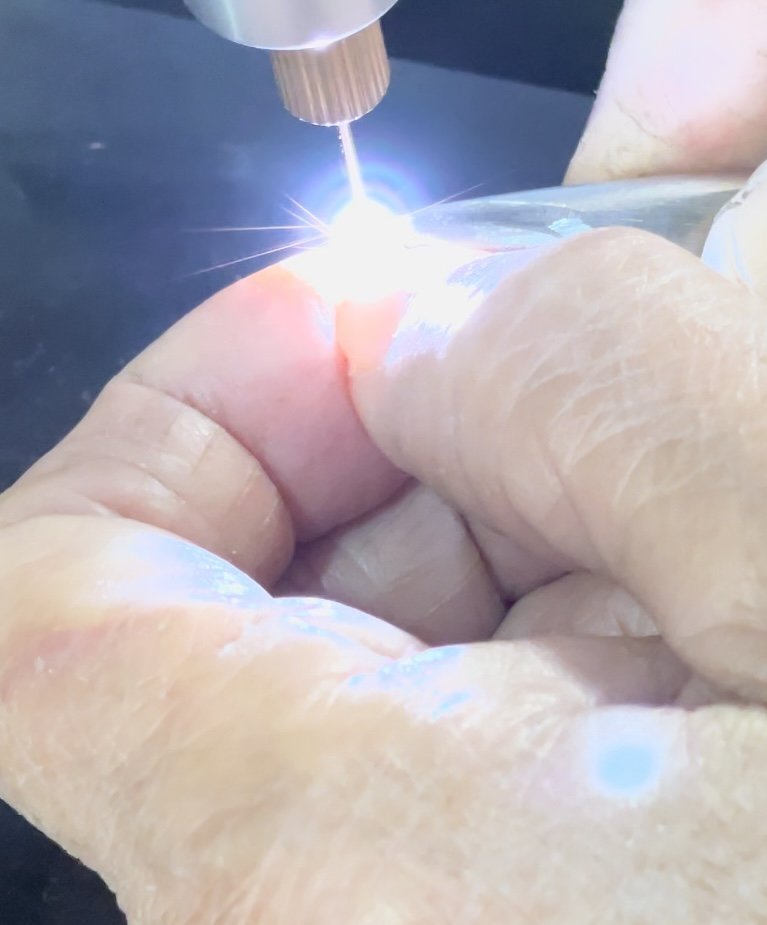

    My father in law has this welder, it’s not cordless, but easily could be. The electrode is thinner than a toothpick!
