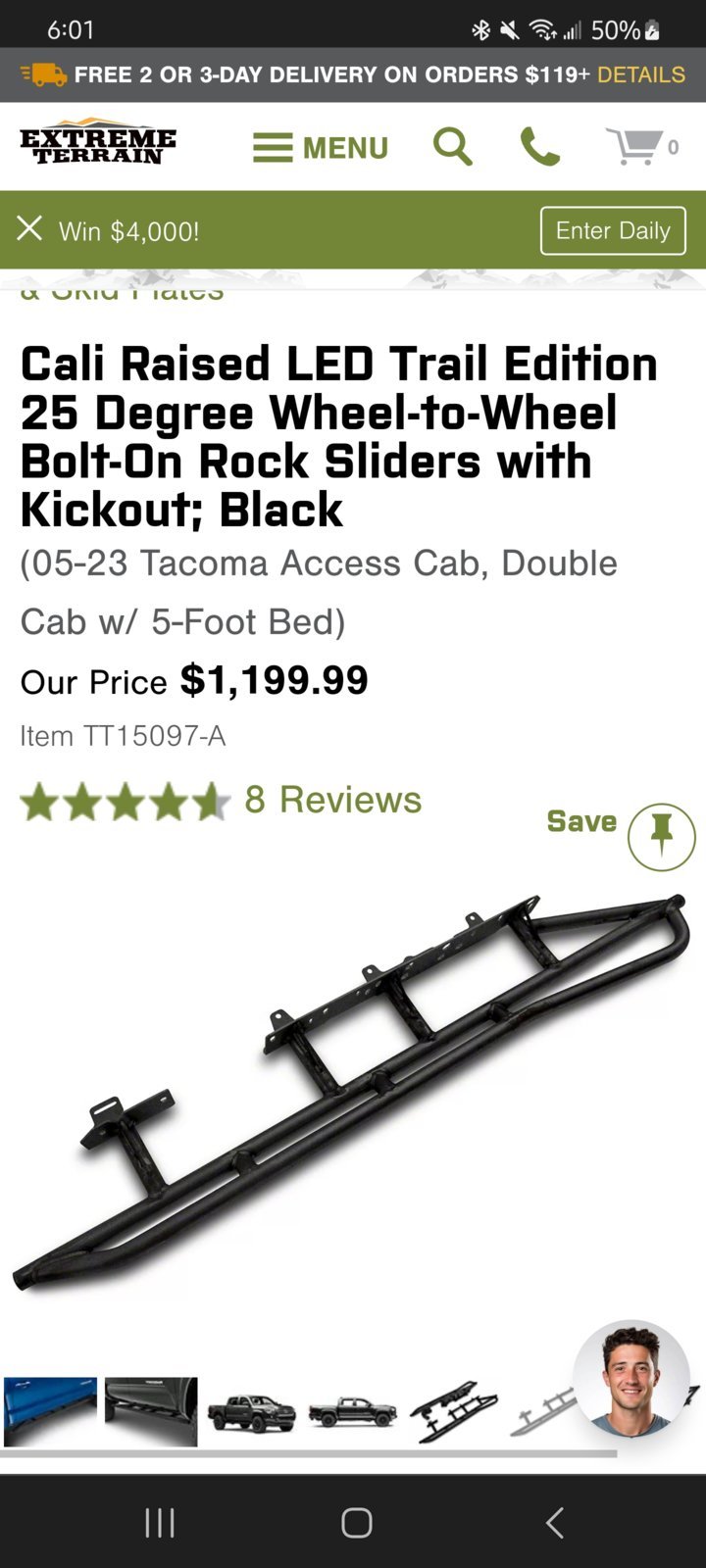

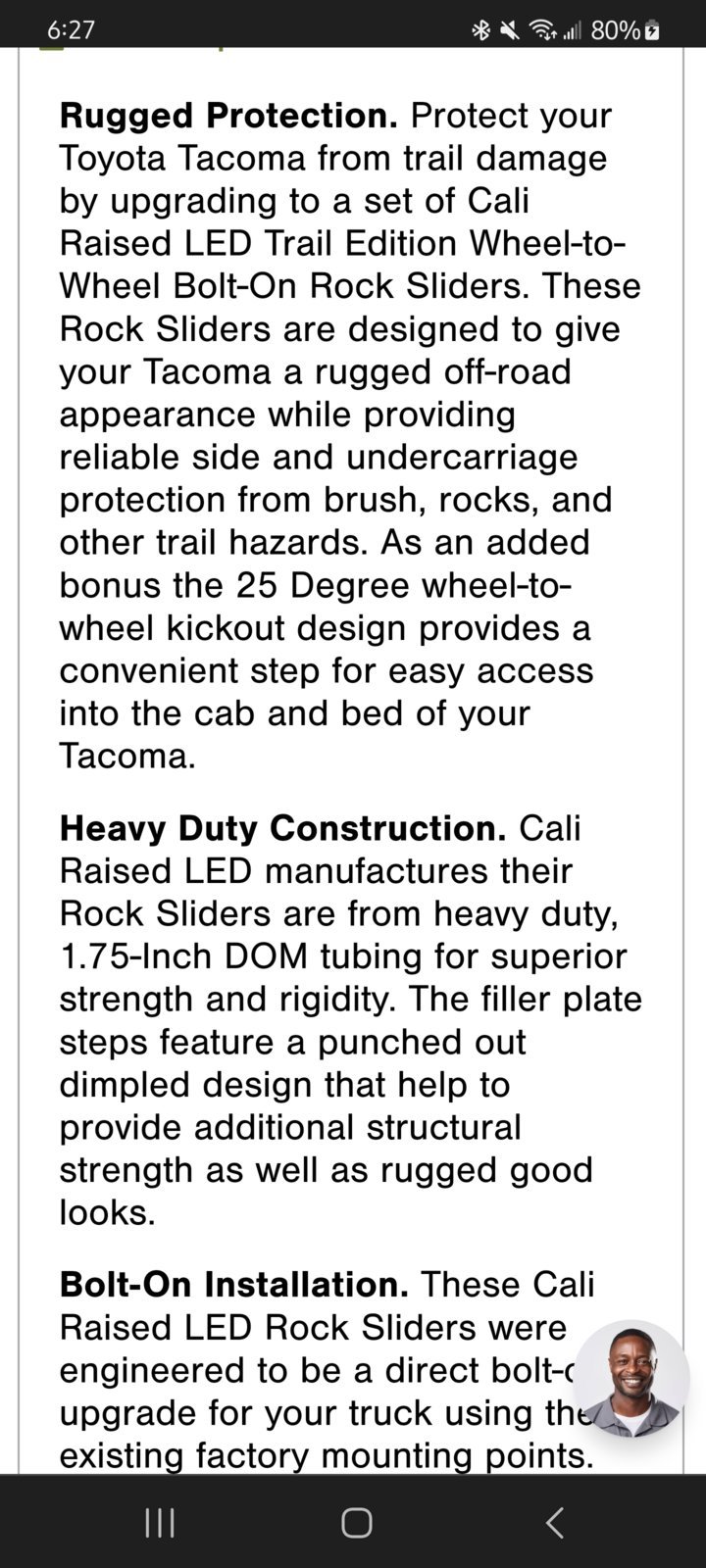

    Cali is DOM.

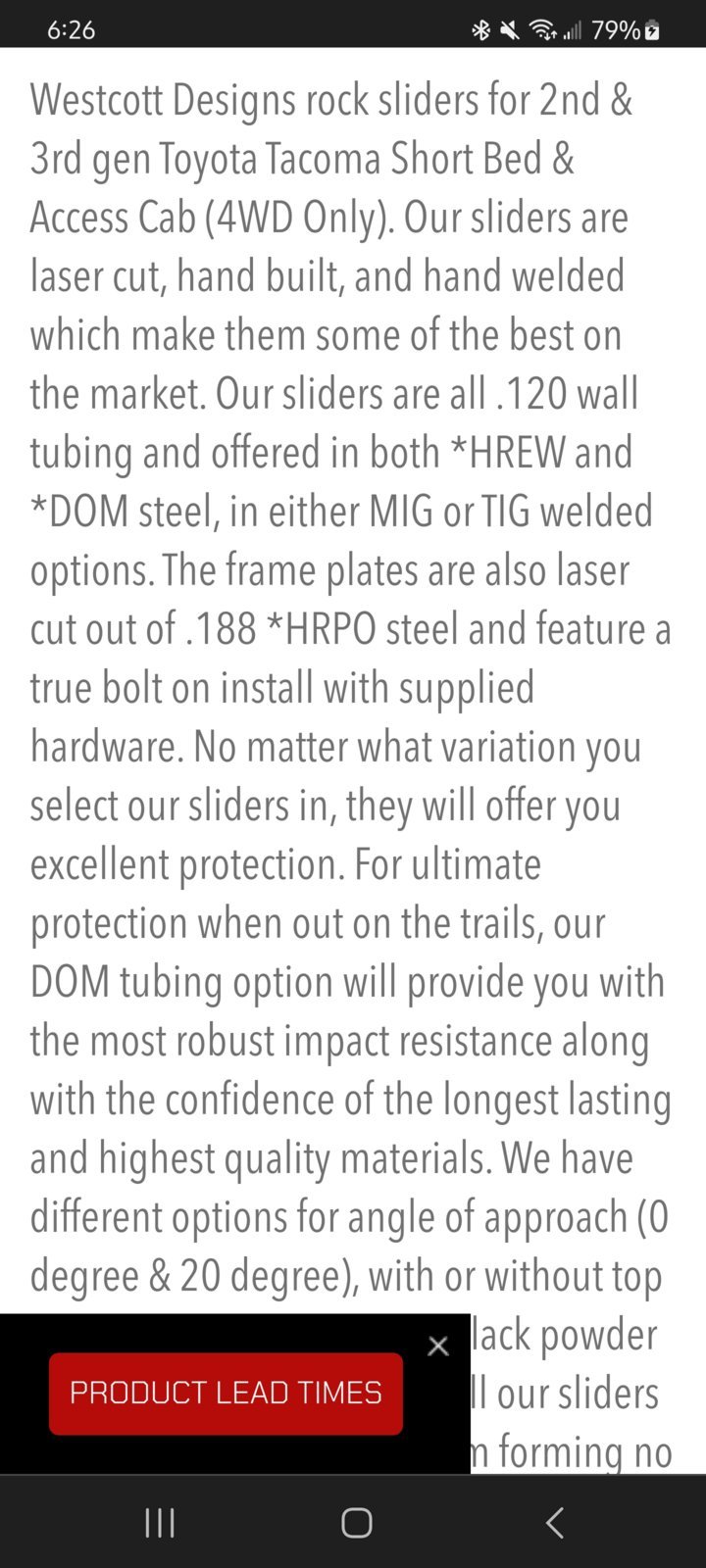

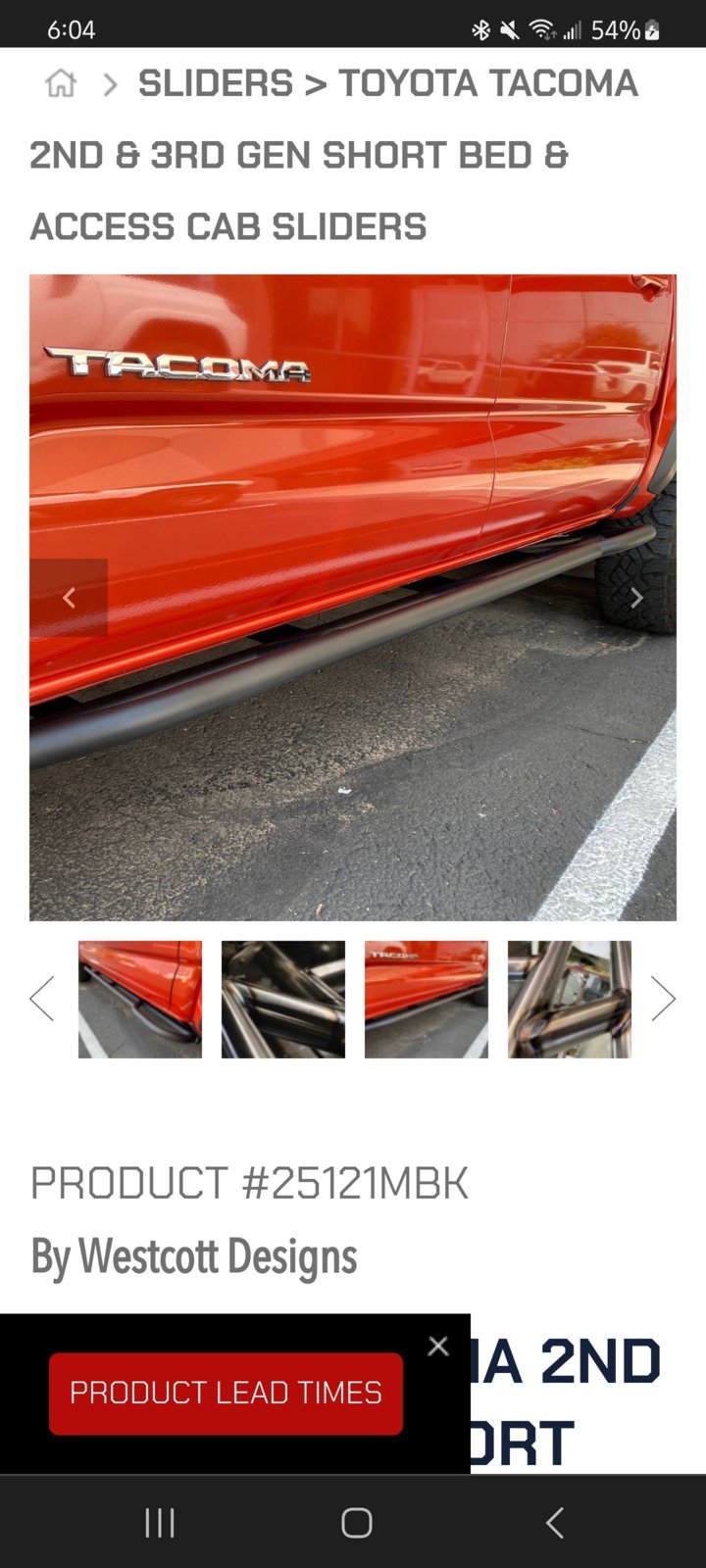

    W.D. you can choose DOM or HREW and mig or tig weld.

    See Dan's note... RCI and on sale. I don't know anything about those two you are looking at other than I recognize the name-assuming they are not the fabricator, but simply sell the product (no worries or implied insult if I am wrong...)
    I used .250 DOM at 1.75", but I don't think that is typical. I would definitely do DOM though. Mig is fine-better if you don't have an expert with TIG welding it together.
    Personally I would have MIG construction. ER70 vs ER80 for TIG (wire) won't be enough to make a difference, but the welder certainly will and if they are just mass produced you will be better off with MIG. My opinions here, so take with a grain of salt and do your research.

    looks like Cali raised is barely 1/8" thick @ .120
    RCI at 3/16" wins for durability.

    RCI would be my next choice. Those Wescott ones look good too. Cali Raised nah.

    Cali raised are good for show, and not much else. (Unless you like Chinese patent rip off designs. They are known for that)
