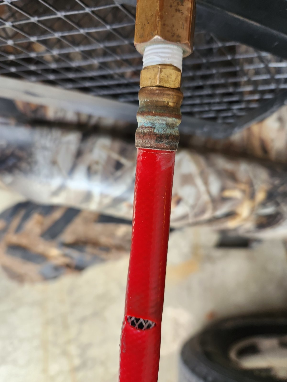

    Usually you'd just cut the hose and re-make the connection. What does it look like on the hose end/inflator side?

    What kind of inflator? I made a custom hose for my Viair. So, you might be able to replace the whole hose, if nothing else.
    As for repair maybe a tire patch kit, and then wrap it with some tape or heat shrink wrap.

    The connector that is on the hose is crimped. I don't have the know-how or the tools to make a crimp.
    I've had this hose for 18 yrs. Probably time for a new one anyway.

    Cut the hose below that damage, get a 99 cent barbed fitting and worm drive clamp from the hardware store, and Bob is your auntie.

    Fancy crimp from factory. hose clamp and splice the hose with

    I called the Parker store. They won't repair a used air line. WTF? When I delivered truck parts, we had them put new fittings put on used hydraulic lines.

    Try these guys:
    PIRTEK Madison
    • 6354 Copps Ave.
      Monona, WI, 53716
    • 07:00 AM - 04:00 PM
      • Retail & Mobile Service

    Flex seal tape. Yep. Flex seal.

    For what those hoses cost that $3 harbor freight splicer mentioned will work just fine.
