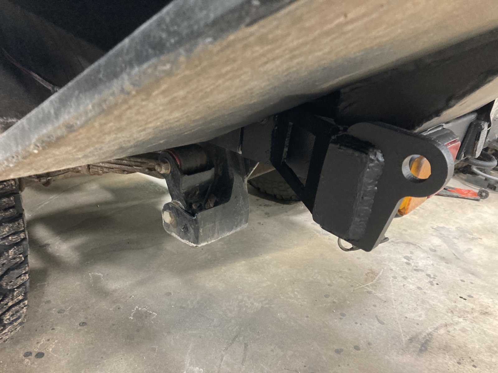

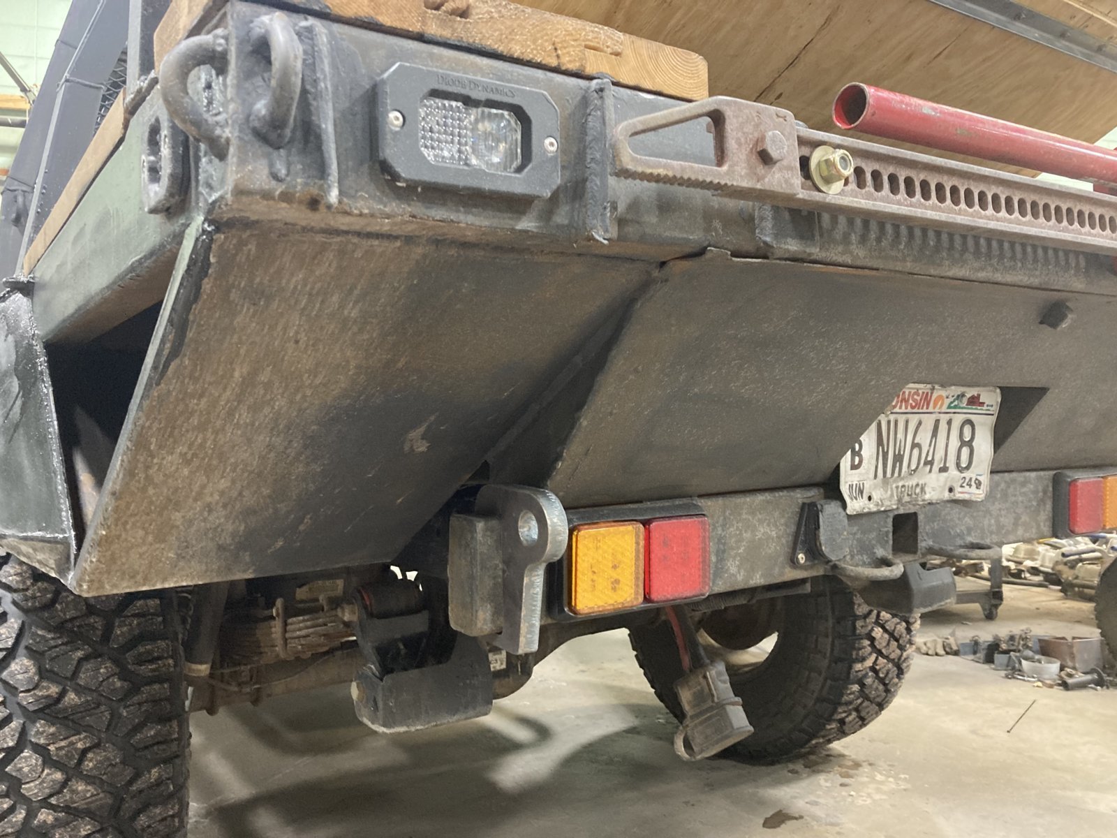

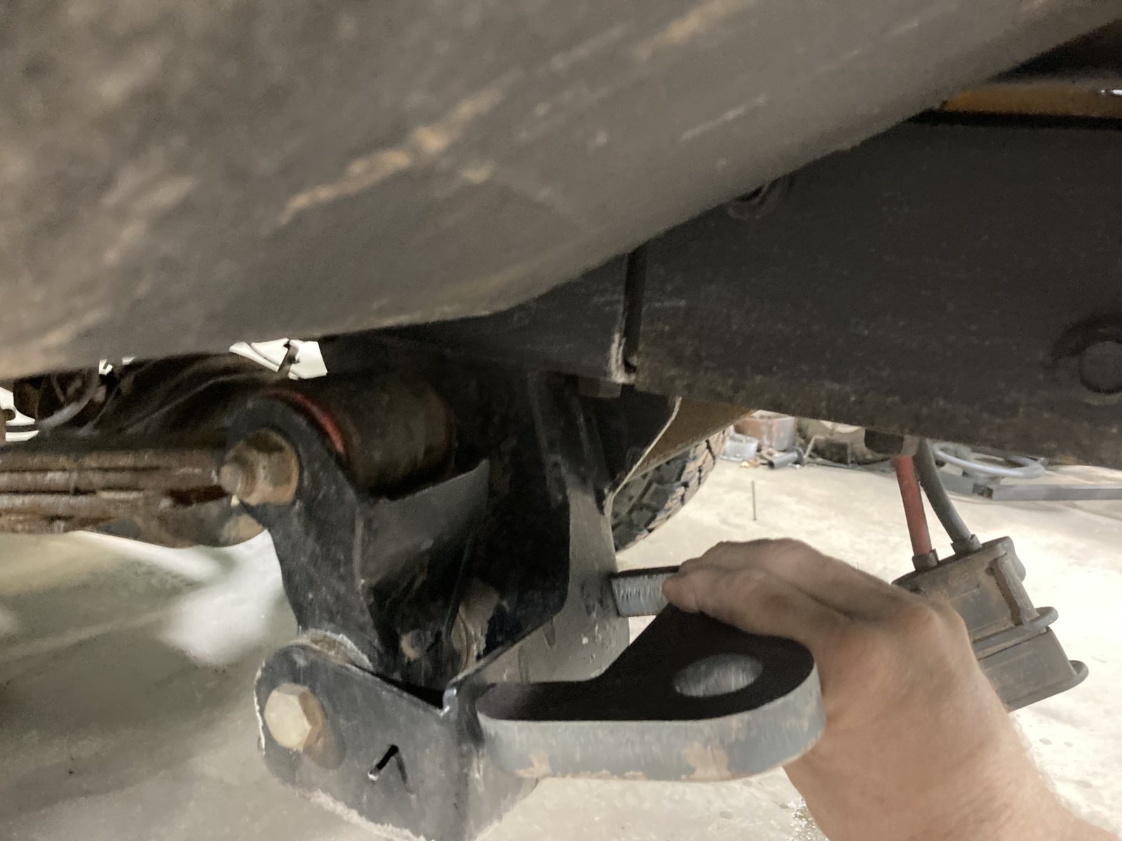

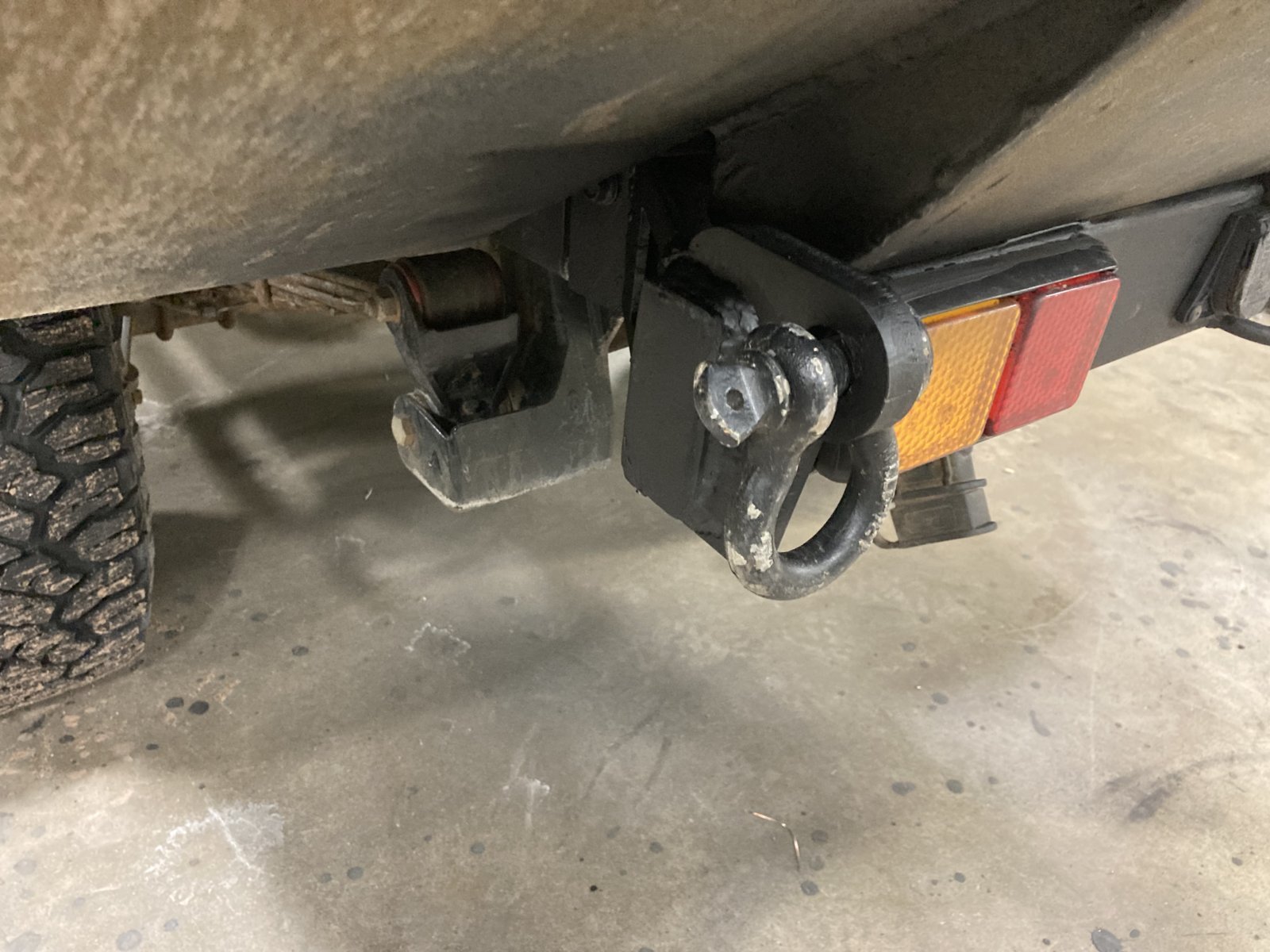

    Hive mind, need some discussion input. Bought these beefy 2x4 D ring mounts from RoughStuff. Were to mount them is the question. On the taillight bar is fine but I would have to gusset to the frame mount as it is only 1/8 steel tubing (one on each side)
    or, cut the tabs off and mount them to my Hammer Hangers. These are 1/4 steel and reinforced with an additional bar up to the trailer receiver. Super beefy. Don’t loose any departure angle this way. Decisions decisions…

    I'd say that while you are probably safe going off the beefy hammer hangers, it's still asking for trouble. Hangers will fail before that honkin big D ring and if those get jacked up you might not be able to drive home. If something goes wrong with the taillight bar it doesn't affect driveability.

    Good point. It would take a MASSIVE pull to damage the HH's especially since I have them reinforced up to the receiver. That said I do make some (possibly poor) decisions that require extraction... I am not as excited about the tail light bar, but it is easier to get to, easier to repair and with gussets should be strong enough.

    Mount them to whatever your tow bar is mounted to. Our trailer hitch. Or if you don't have one... Make one :D

    I was going to suggest mounting them as close to in line with the frame rails as possible to minimize any twisting forces during recovery. This looks good to me because if a dynamic recovery goes bad it's not going to damage the spring perches.
