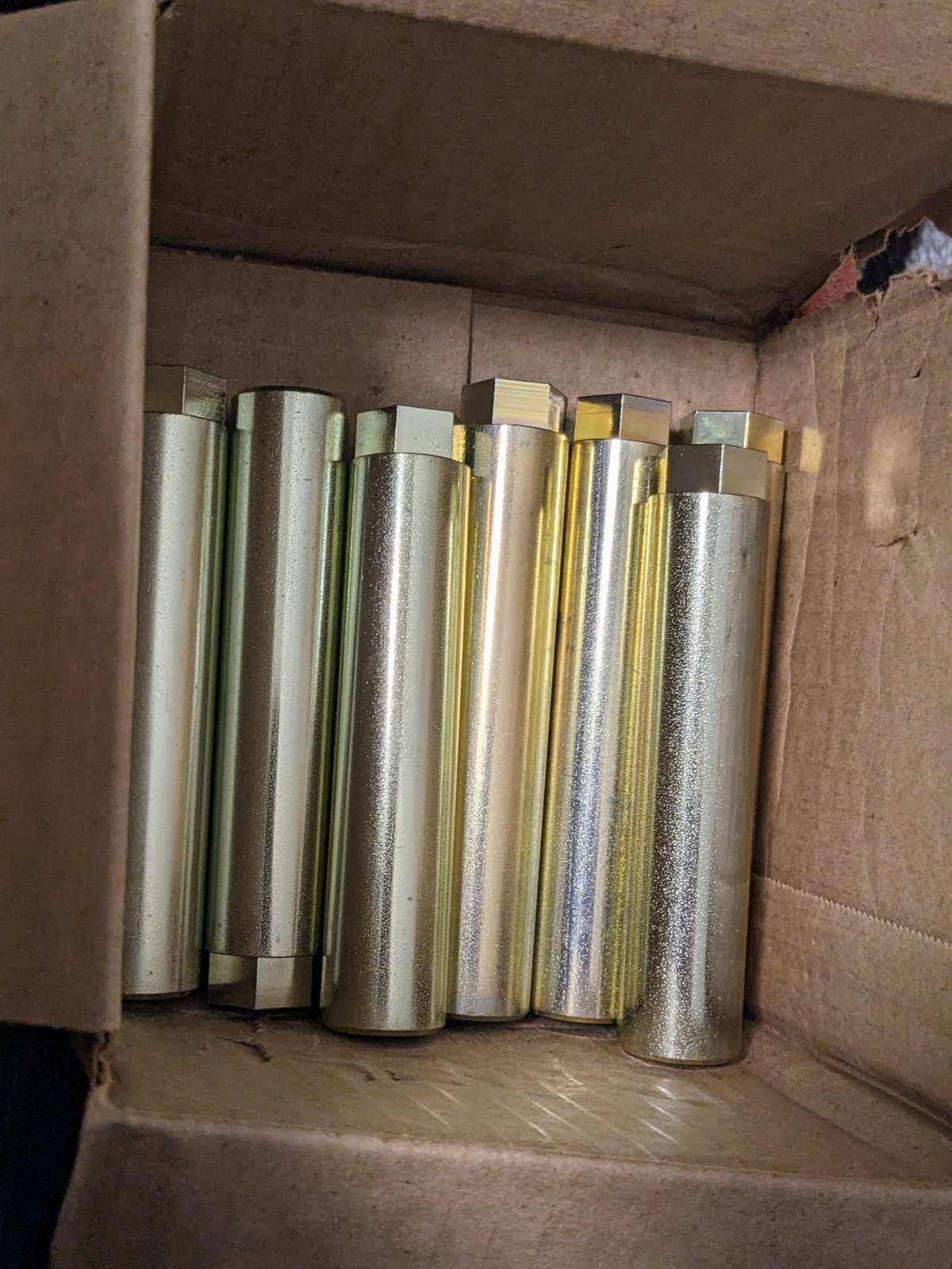

    Questions for the hive mind... As is good practice, I'd like to look into carying a spare CV axle or two. I've heard mention of higher articulation CV axles, and I'm wondering if it might be a good idea to go with a set of those and have my stock axles as backups. I've deleted my sway bar up front, so higher articulation axles seems like a good plan. Can anyone point me in the direction of a reputable aftermarket brand?
    Also, I'm thinking I'd like to check out some tie rod sleeves. War Fab seems to always be sold out. Any suggestions there?
    I got my recall replacement UCAs a while back from Ironman4x4 and I figure I'd like to upgrade this other stuff when I get around to replacing those so I'd only need to get an alignment once. I also need to rotate my tires (5 tire rotation) so I'll be stopping by my buddy at Tires Plus to reprogram the TPMS sensors. Figured I'd do that when I get the alignment done.

    The O'Reilly Gold extended travel or long angle or whatever they're called. Have held up really well in our group here. I also have an AutoZone called that I put on before I ever started wheeling and it's held up along with the stock axle on the other side.
    As far as the war fab sleeves go, they are robust but I highly recommend you fluid film that stuff after you put it on and then make sure you get an alignment at minimum yearly to keep everything from freezing up. Only because those sleeves cover up the 15 mm shaft. So you have to use Dutch pliers to move your inner tie rod and that can be difficult if everything starts corroding. But the warfrab sleeves are just about bomb proof.

    When I raced, we welded a piece of tubing over the stock tie rods. If a person were fancy, they'd weld a large nut on also, so you'd have something to turn with a wrench instead of Vice Grips. If a person had access to a mill, you could mill a couple of flat spots for a wrench.

    @CygnusX191 Are those yours? War Fab or another brand? Available for purchase? DM me if you wanna keep it on the down-low. :spy:
