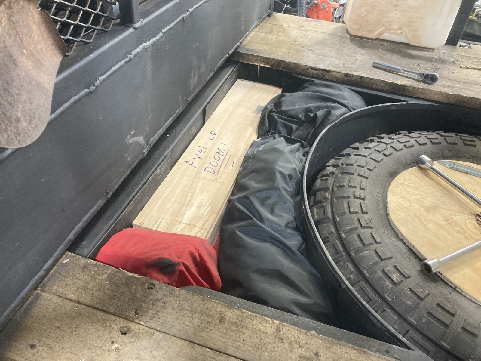

    For those who know…. The axel o doom!

    Axel Foley - Wikipedia
    Detective Axel Foley is a fictional character, portrayed by Eddie Murphy, and is the titular protagonist of the Beverly Hills Cop film series. He is ranked No. 55 on Empire magazine's list of The 100 Greatest Movie Characters of All Time.
    Axle - Wikipedia
    Terminology On cars and trucks, several senses of the word axle occur in casual usage, referring to the shaft itself, its housing, or simply any transverse pair of wheels. Strictly speaking, a shaft that rotates with the wheel, being either bolted or splined in fixed relation to it, is called an axle or axle shaft.
    Just saying, not judging.
    Cheers!
