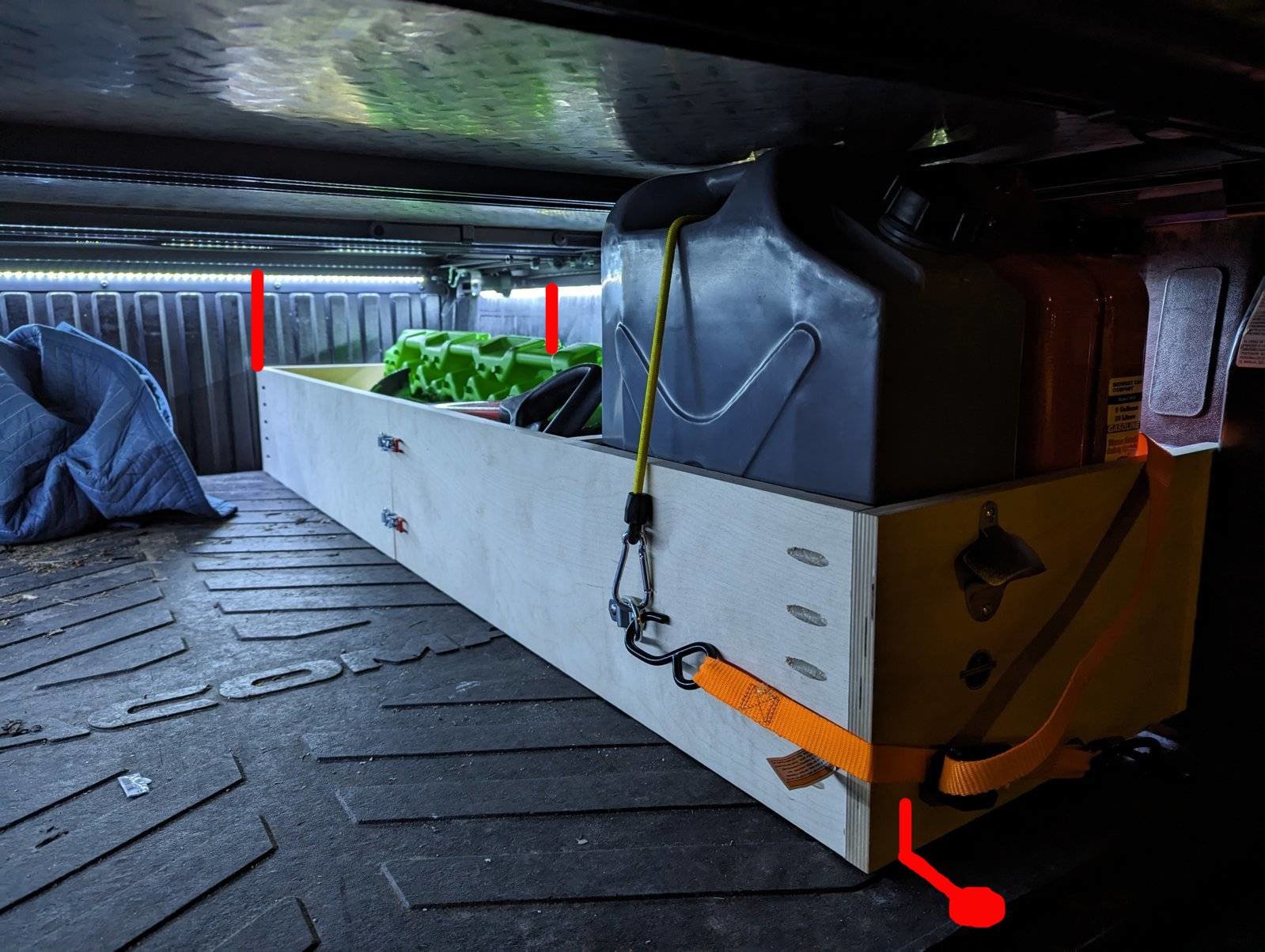

    Yeah, I'm trying different things, seeing what works. That cam lock strap just doesn't get as snug as I would like it to. Maybe I need to see if I can find some mini ratchet straps. I tried a couple different toggle clamps I had, but couldn't get them to work well using the factory D-ring anchor. Fabbing something custom would be ideal.

    I have an idea. Hopefully my crude drawing helps make sense of that idea:
    * Make some kind of vertical strut from the rear of your wood box to the track/rail towards the rear of the cab.
    * Make another vertical strut (or two) on the bed side in the same fashion.
    * Fab up a thin L bracket that bolts to the rear most bed hold down bolt and then also bolts to your wood box.
    This would give 3 very solid points of contact without much effort. Might have to buy some inserts for the track/rails though in order to use bolts to secure them but those are pretty common and cheap.
    Oh gosh I almost forgot. This is imperative. You absolutely 100% have to slap it once and publicly exclaim "that ain't going nowhere" or you risk it coming loose. Critical step in the process.

    This is a fine idea! My only issue with it is that I wanted to make this storage setup basically quick-release so I would be able to take it out and pop it back in when needed. Notice the 2 toggle clamps holding the front and rear sections together for quick-release. My initial vision was to use different types of toggle clamps to assemble and secure it. I end up hauling wood, furniture and larger stuff often enough that I'd need to be able to do quick changes.
    I also have the front up by the cab pretty well secured using the sidewall tie down in a way I could spend many words trying to explain, but a picture would be far easier. Problem is there is a blizzard going on in the driveway right now, so the pic will have to wait.
    I do like the idea of some kind of bracket at the tailgate end... That would be more secure than the crappy cam lock strap to the D-ring. I will let that idea roll around my noggin for a bit and see if anything comes of it. Thanks!
