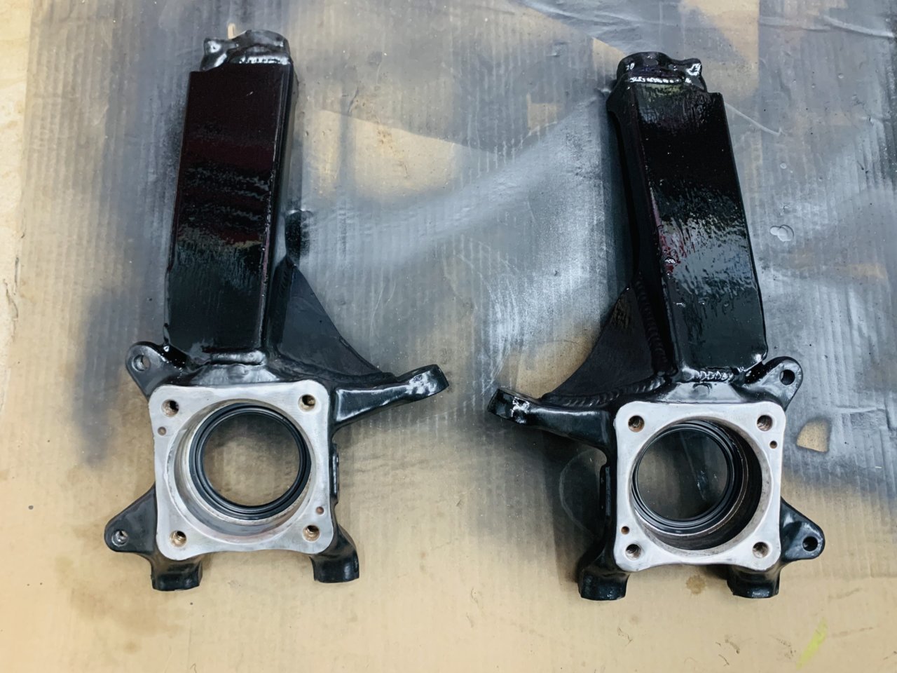

    Surprised you didn’t do spindle gussets while you had everything out

    Spindle gussets? Do tell... I can add it to the list...

    Perhaps I am picking on you a little bit, but the statement is true, I really am surprised you don't have them yet as they seem like something that would be right up your alley. You have different options. Considering both you and all your students are hands on fabricators I'm assuming you would buy the cheaper option which is the weld it yourself option. Only thing you have to pay attention to when doing the weld it yourself option (so I have read, I am not speaking from experience) is you don't want to overheat the spindles when welding on the gussets as you can warp them and or change the metal characteristics and make them brittle. Your other option is you can trade in your spindles as like a core charge and be sent to some gusseted ones that were already welded by a fab shop.

    Someone says gusseted spindles?

    Honestly I probably should get some considering how I take having to slow down for potholes and washouts and dips as a personal insult lol. There actually were some for sale not too far away from me and I'm still upset with myself for not buying them.

    Yeah, I just know people tend to have wheel bearings go not too long after they swap to gusseted spindles. It seems like wheel bearings don't like being swapped out like that. Not that it's a huge deal but just a pain in the ass plus you have to take so much apart in the front end. Are you going to try finding work at another dealership or head in a complete different direction?
