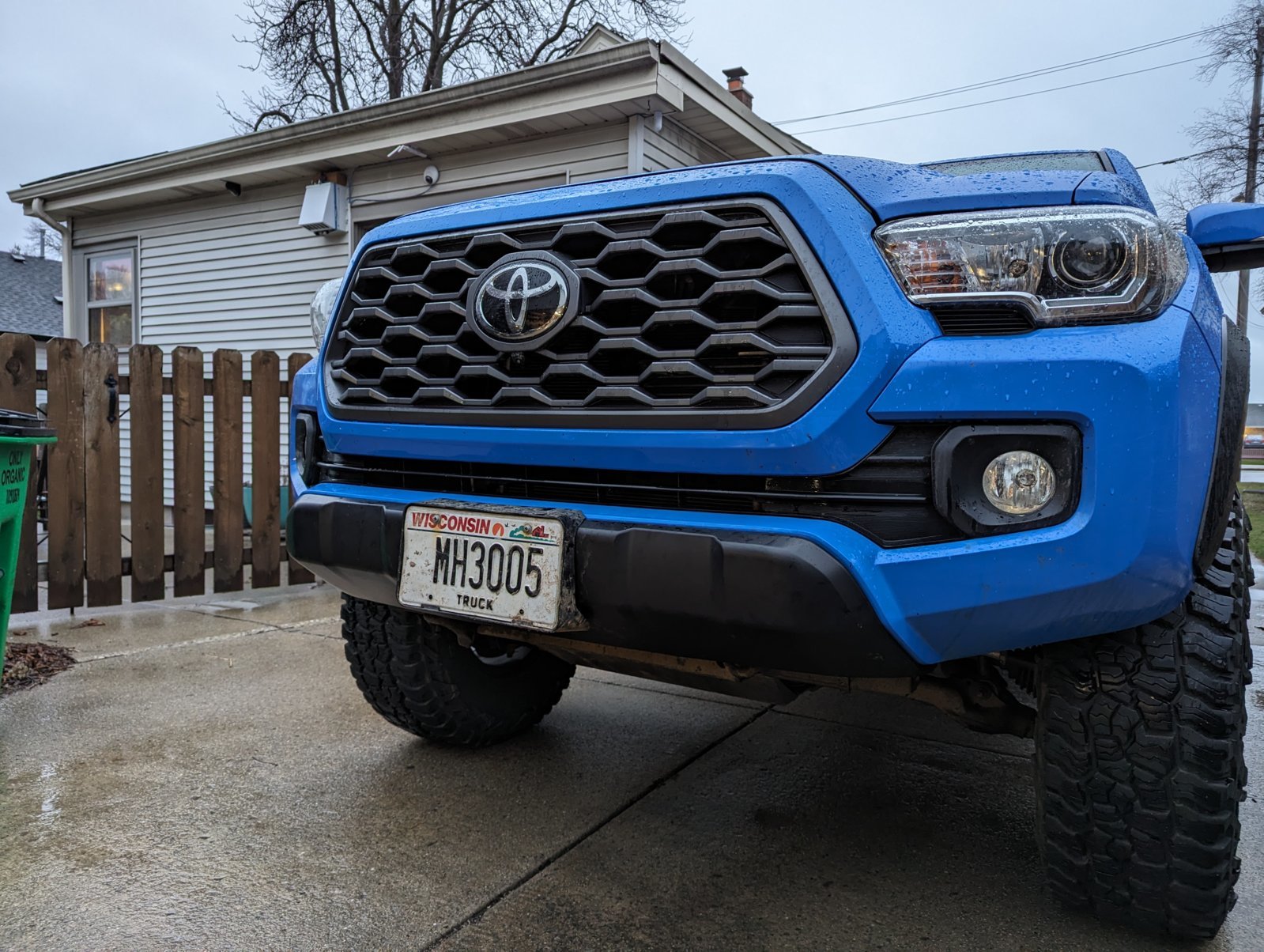

    Big shout out to @Camerasandcoffee for sourcing the black front bumper cover for me! Worked great Jonathan, snapped right into place. I ran the truck through the Kwik Trip car wash today and it got maybe 70% of the mud off (and revealed a lot of scratchiness), but the new piece up front is the cleanest bit on the truck right now.
    I probably won't get to figuring out the mess with the rear bumper until after Wyalusing.

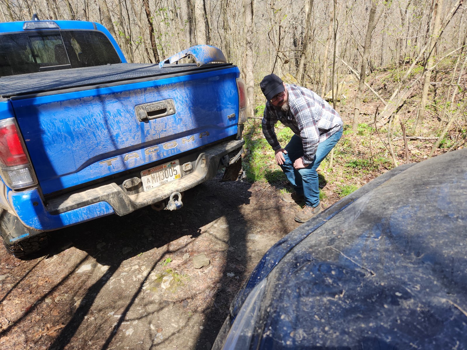

    Dean asked over the radio "was that your truck that hit? If so I have a problem." he had a problem, but only for a short second or so...
