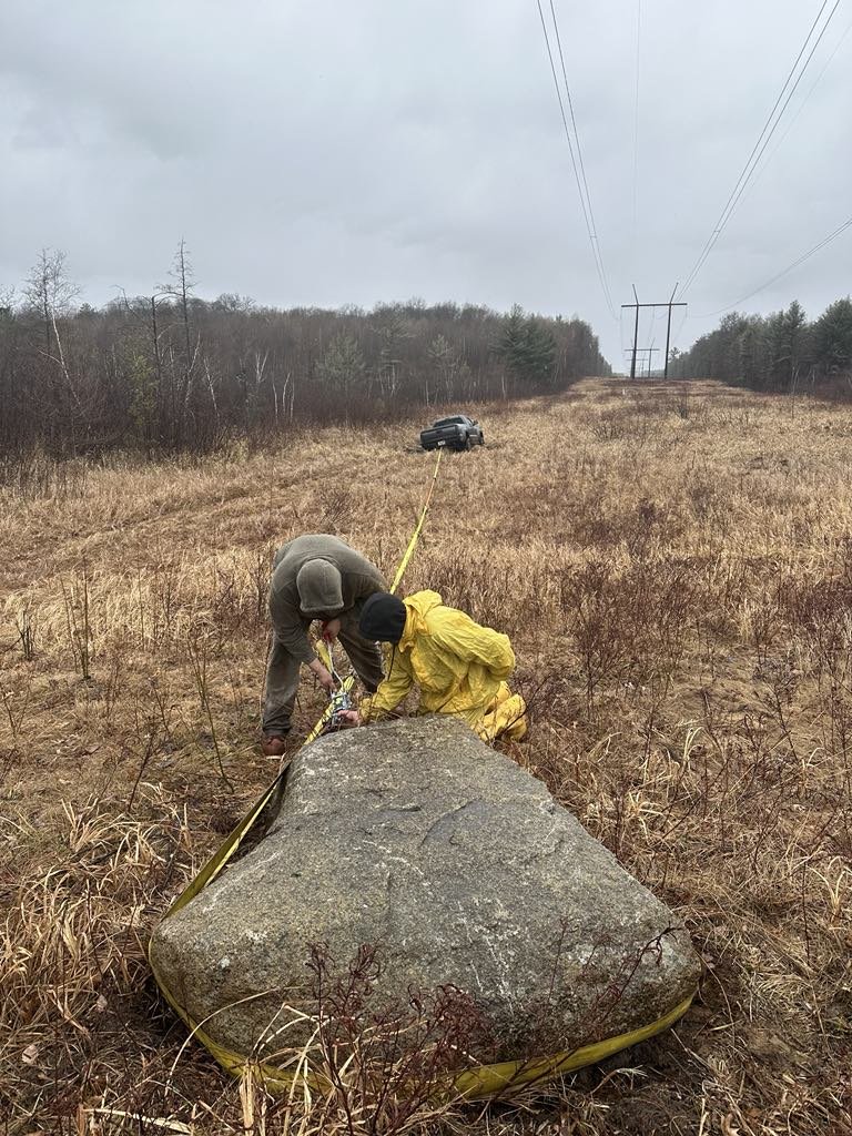

    Before his son showed up, the come-a-long rock method proved itself incapable.

    well you got to enhance your recovery skills today , looks wet ! Glad your trucks out. Oh just wanted to add something. Just because it's a full size truck doesn't mean it will make it where your Tacoma is ! Weight , sometimes has to be added into the equation. Just putting it out there.

    Your come a long didn't work properly because it was you against the truck ! What you needed was a truck winch or Rachet winch preferably a 3 ton or bigger. They work way better then normal come a long and cheaper then a truck winch

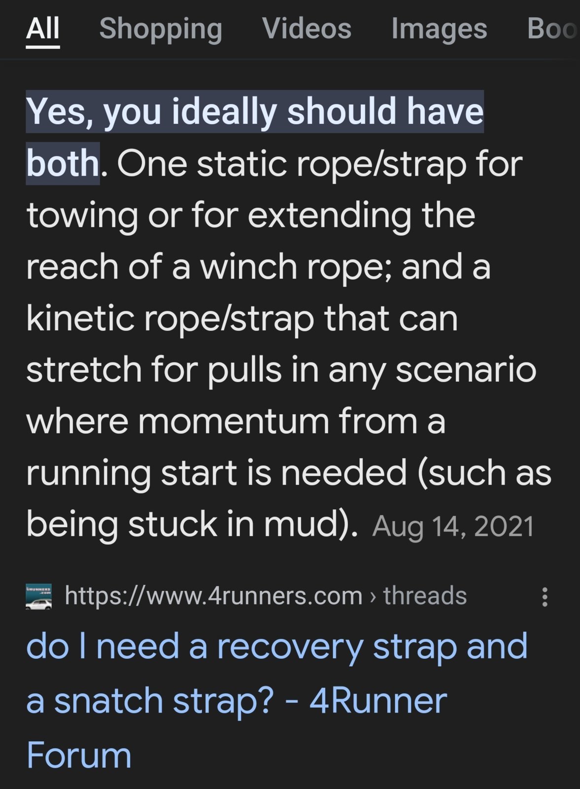

    I'm not sure either so I asked the Googles and 1st that popped up was from 4runners.co/m

    This doesn't say anything about using a static strap in conjunction with a kinetic rope or strap. It recommends having both for use in different circumstances.
    At the very least, I'd make sure that the static strap had a higher breaking strength than the kinetic strap involved.

    The screenshot you posted says it's good to have both types of straps, for different situations. It doesn't say to use them together at the same time.

    When doing kinetic recoveries, never use static straps, or two straps.
    Ever.
