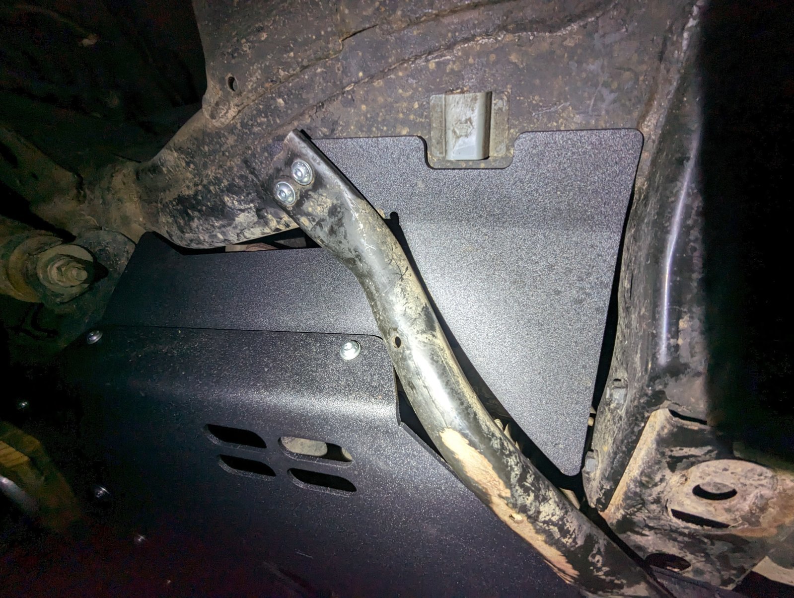

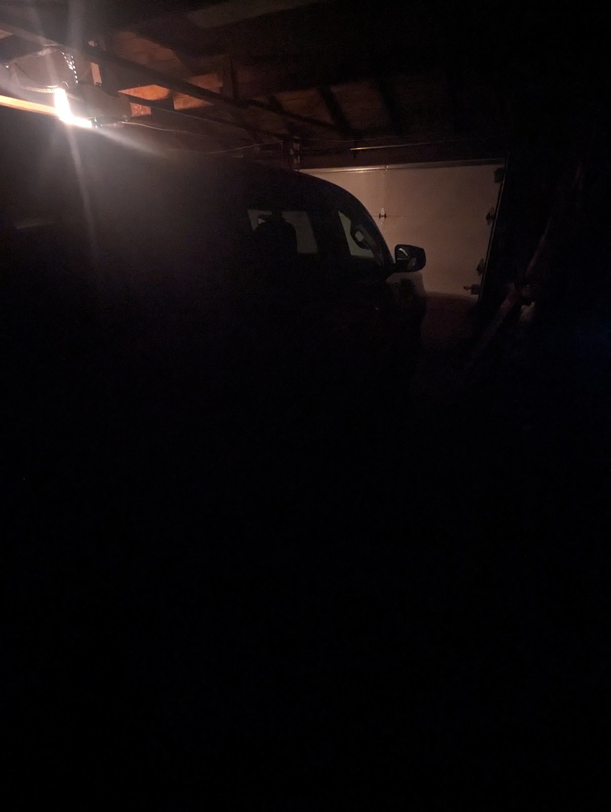

    I swear I'll get good pictures of this eventually. Got home late from work. My wife closed. And then my MIL couldn't watch my daughter any longer. She's got a second dental trip to Mexico coming up and needed to pick up some odds and ends.
    But thanks to that trip I have a 4-day weekend. This probably could've waited until then but I couldn't help myself.

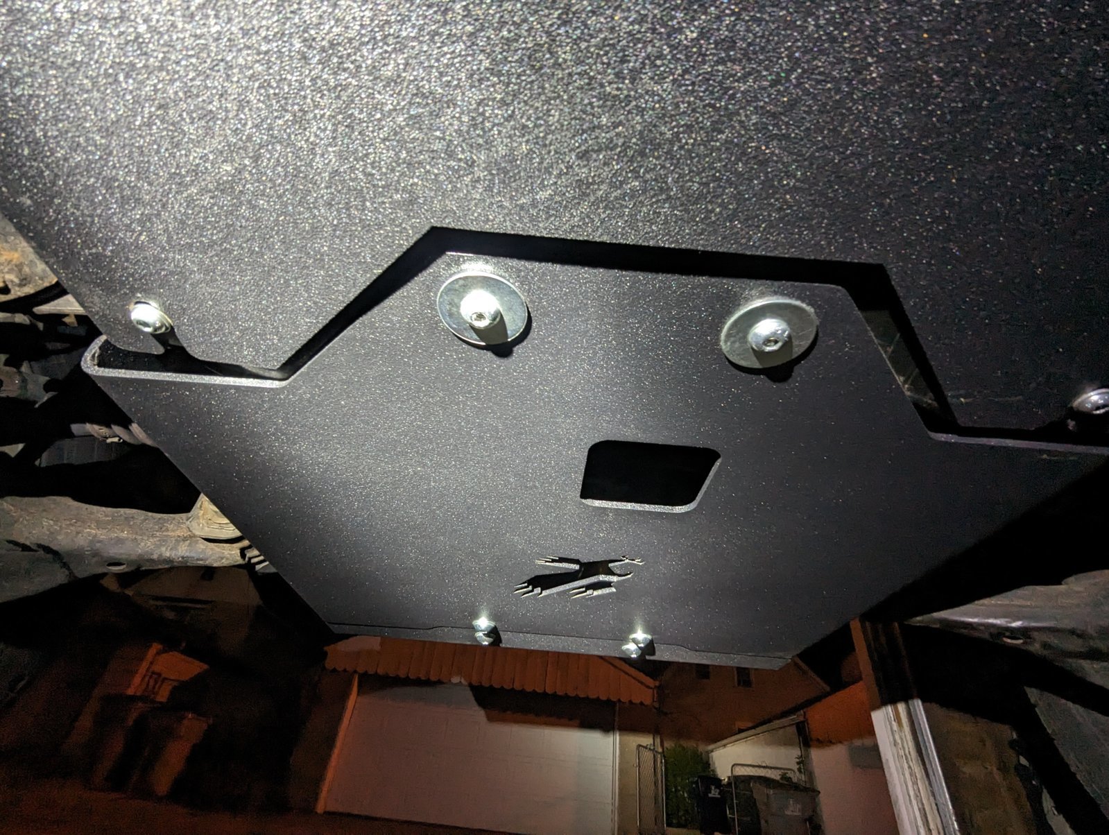

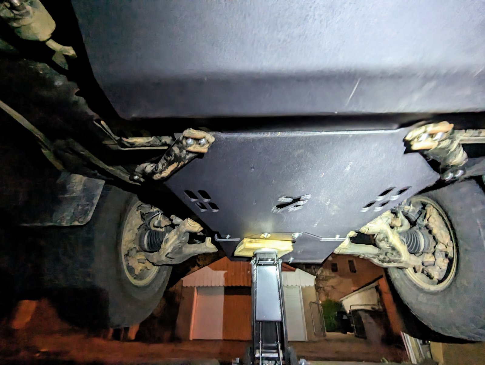

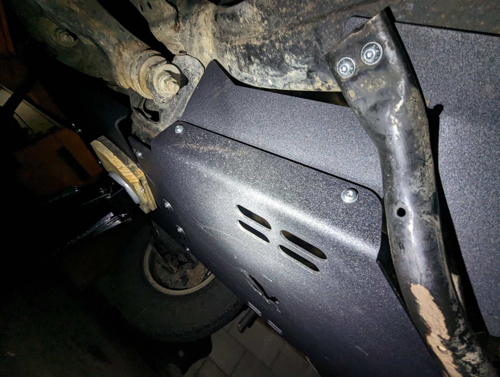

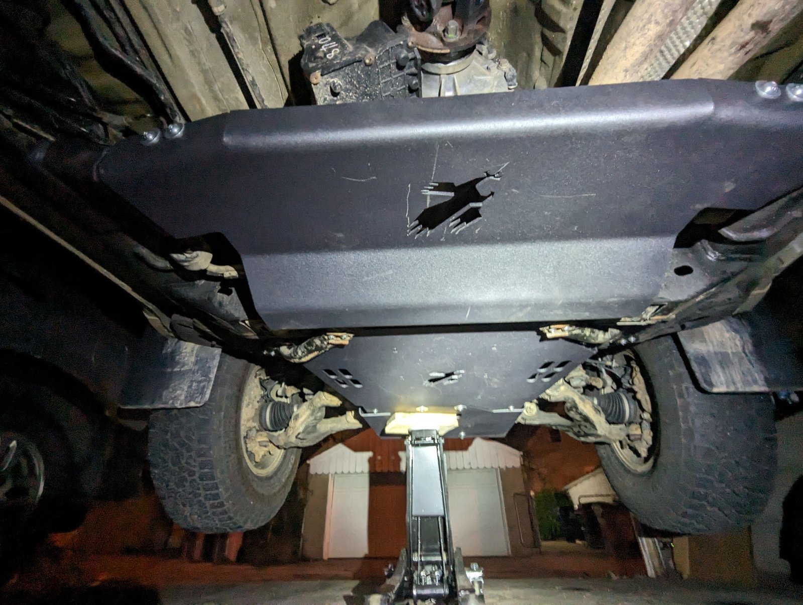

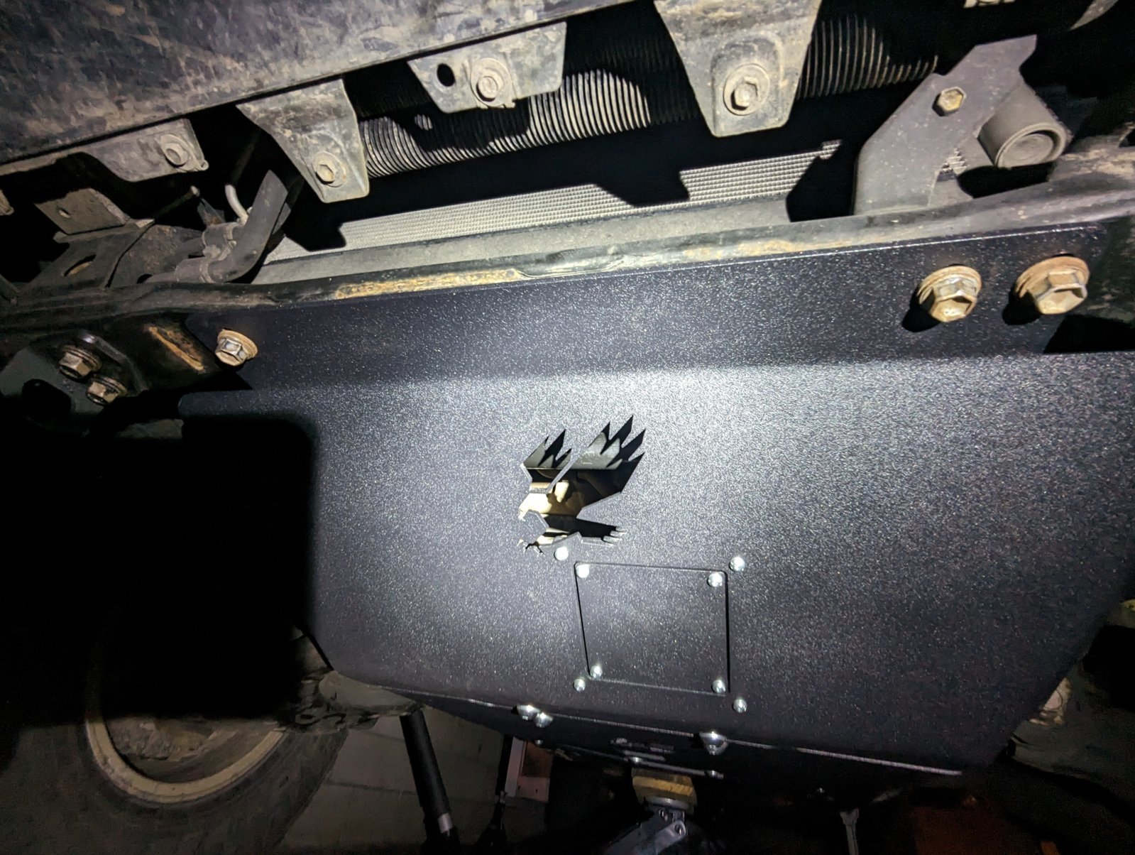

    Freshly showered and feeling accomplished, I think I can definitely recommend these to anyone looking for a solid budget friendly skid set.
    I spent some more time tightening everything down and making sure it was all snug. I know a common issue with loose skids is a lot of rattling.
    Engine skids
    Transmission Skid
    Transmission skid comes with some "wings" that add more coverage. There's enough room to install after the main part but not a lot. Definitely recommend loosely attaching them to the main thing first.
    Transfer case skid. I forgot a rag to keep the jack I was using from scratching them. Had the 3 ton floor jack and some 6 ton jack stands to make plenty of room overall.

    What? You don't pull them off for every oil change? Tree that tries to kill you? Wiring job? How quaint...
    Look great though! Congratulations... the game begins!
