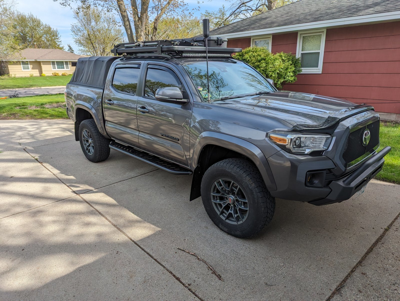

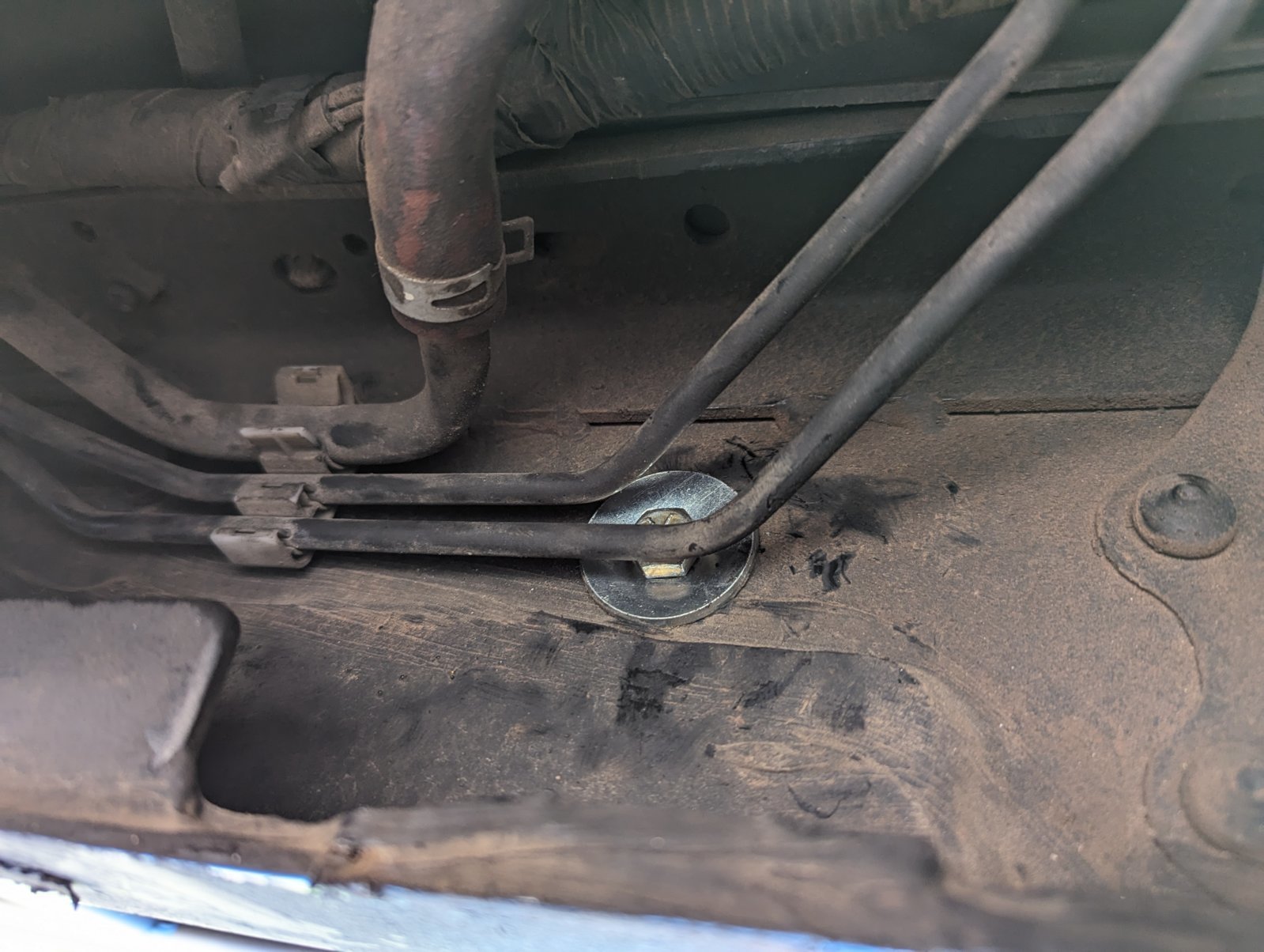

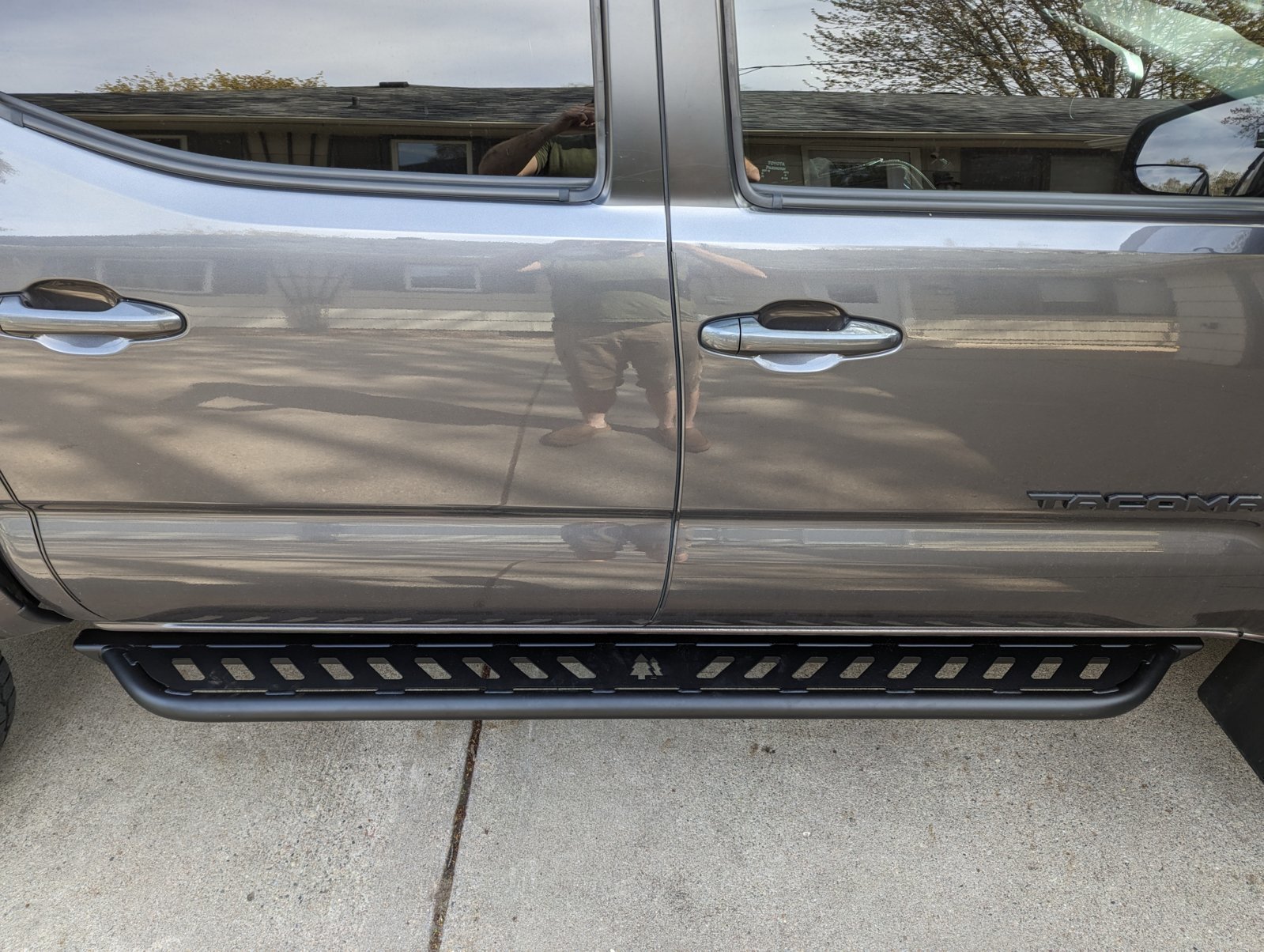

    Installed the aluminum sliders today. I don't know why people complain about installing them. It was incredibly easy to do solo with no jack.
    Took about 10 minutes start to finish on the passenger side. The driver side took a bit longer. The front bolt wasn't easy to get on and the electric box nuts were rusted.
    For the bolts on the driver side that are near the brake lines I installed them backwards so it has less chance of rubbing the lines.
    PXL_20240501_205642435.jpg PXL_20240501_205655082.jpg PXL_20240501_205730172.jpg

    Take your fingers and gently bent the brake lines away from the head of that bolt. The lines may still hit the head and wear through. I did say gently, and it only takes about 1/4". Brake lines bend pretty easily. Use your thumb as a fulcrum to keep from kinking the line.

    You can't see it in the picture but there is almost a 1/4" of clearance already.

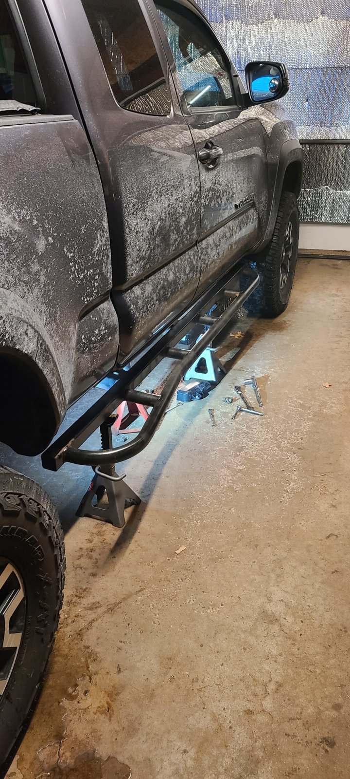

    I was able to get them within 1/4" of the holes, playing a balancing act on 3 jack stands.
    The rest was holding with one arm, bolt with the other.
    My knees and feet got involved at one point or another...
    Other than that. Piece of cake.
