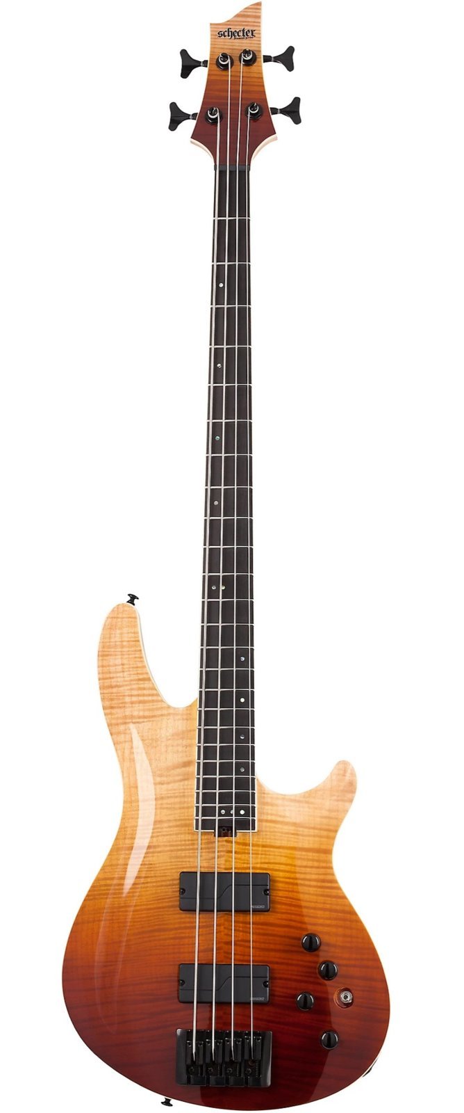

    Despite what the purists say, Schecter makes some quality instruments.
    As far as having a ton of them... I didn't choose the bass collecting life, the bass collecting life chose me. It just sort of happens and one day you have eight instruments who don't know what to do with

    I have hesitation about spending a lot of money on a Schecter. But, the reviews and videos can't all be BS. Plus, I certainly can't afford to spend $10K on a bass right now, so I have to value shop.
    Out of the 5 basses, I could sell 3 and not really miss them. The '95 Warwick and '80's Fender Jazz bass are the only ones I'm really attached to.
