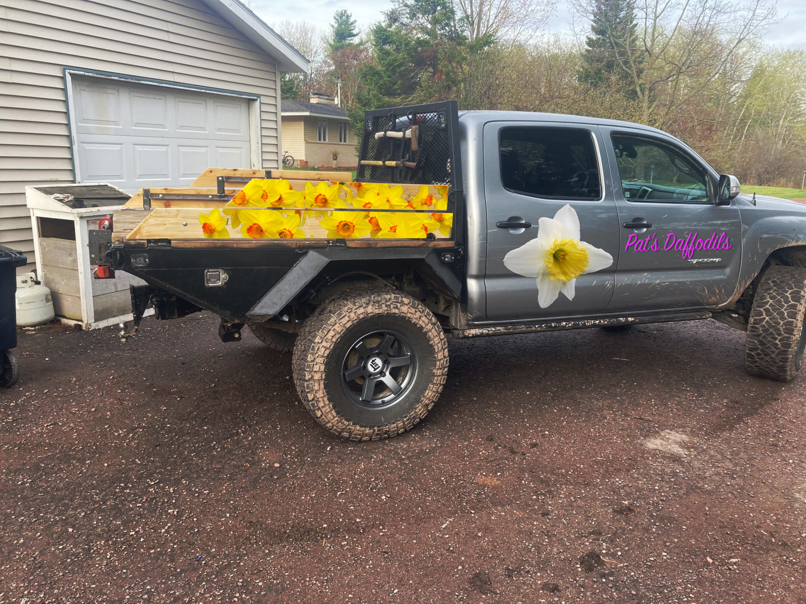

    77 square miles surrounded by reality.
    '15 Black DCLB SR5
    Tires, Softopper, fully armored, winch, many pinstripes.

  18. May 8, 2024 at 8:44 PM
    Pixeltim
    Pixeltim Misunderstood member
    Jun 23, 2020
    #332368
    7,642
    '15 Black DCLB SR5
    Holy crap!
    If only they were nearby...
  19. May 9, 2024 at 9:05 AM
    pearing
    pearing Well-Known Member
    Aug 4, 2018
    #261610
    5,208
    Wisconsin
    2015 SR5 quadcab
    Nice, but only 16" nice... You'll be buying wheels again says me.
