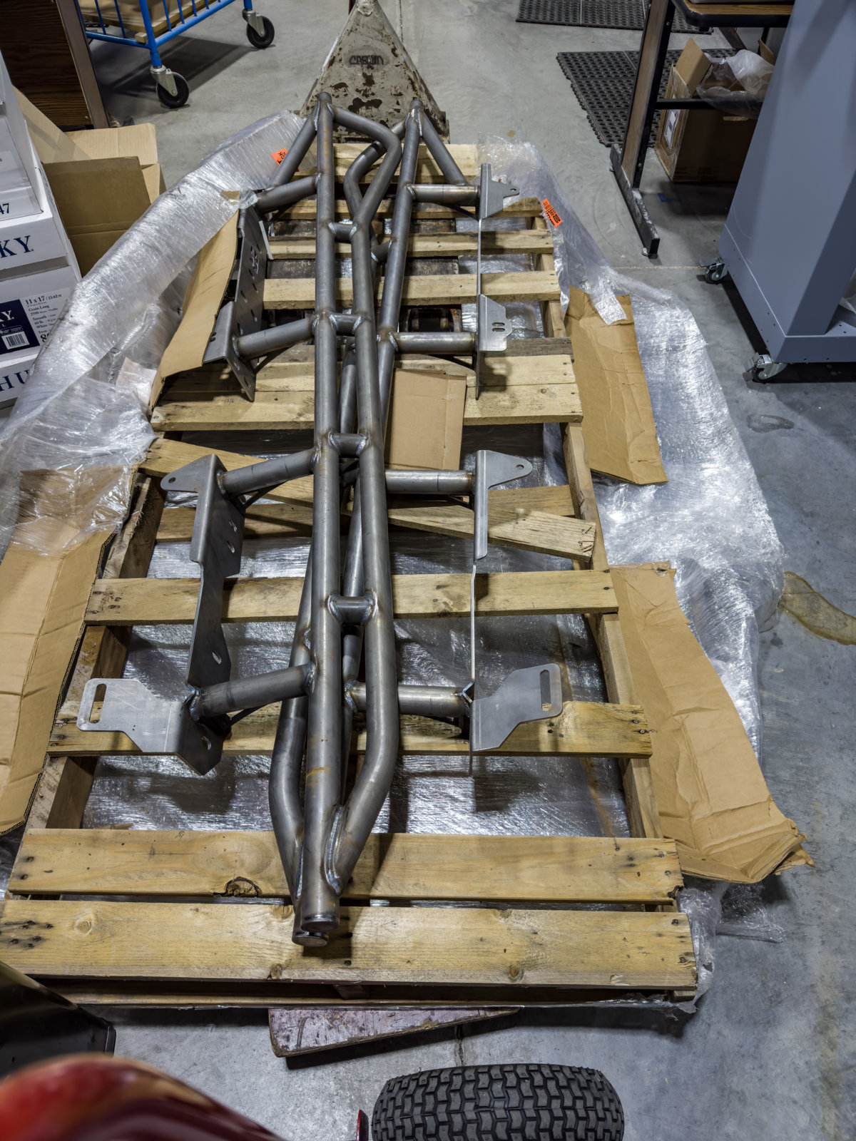

    I have new stickers!
    WTF???? It didn't come with stickers!

    Ok, for the raw new sliders, POR-15 or the Rustoleum self etching primer then topcoat?

    Primer then top coat imo. Easier to touch up and if por-15 is damaged water could get under the layer and cause issues... But I've only heard it never experienced it

    just run them raw and go with the natural look

    I painted my sliders with Rusto the 1st time. Didn't last 3 snowstorms. Salt blasted to bare metal. Stripped 'em the next spring and applied POR-15. It's still there after 2 winters. I've read of the peeling problem. Consensus is shoddy prep work. I acetoned the shit outta mine the 2nd time around. Only places its' missing is from rocks. My nephew and his buddies say Steel-It is better than POR-15.

    Seconded on steel it. Pricey, but amazing. Prep is key.

    The steel it sure looks awesome!

    Poly or epoxy?
