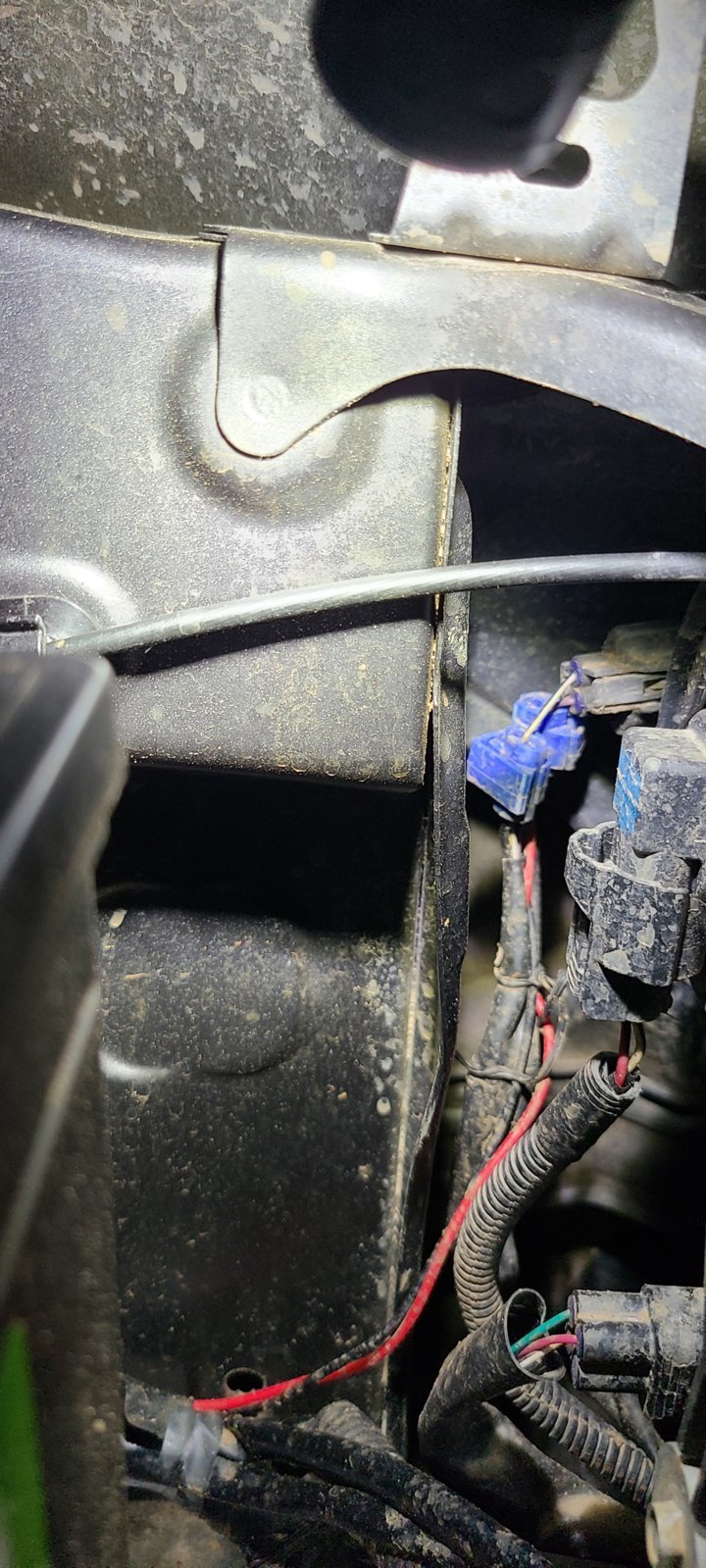

    The extra drl/sequential turn I added under the headlight is powered off the INJ under the hood.
    DRL portion is always on with ACC.
    Sequential turn wire gets tapped in behind turn signal plug. Or spliced in.
    The 3 glorious amber lights in my grill turn on with the 2nd drl setting (when the taillights and drl are on but no headlights).
    Those I spliced in with DRL.
    (Blue clips).

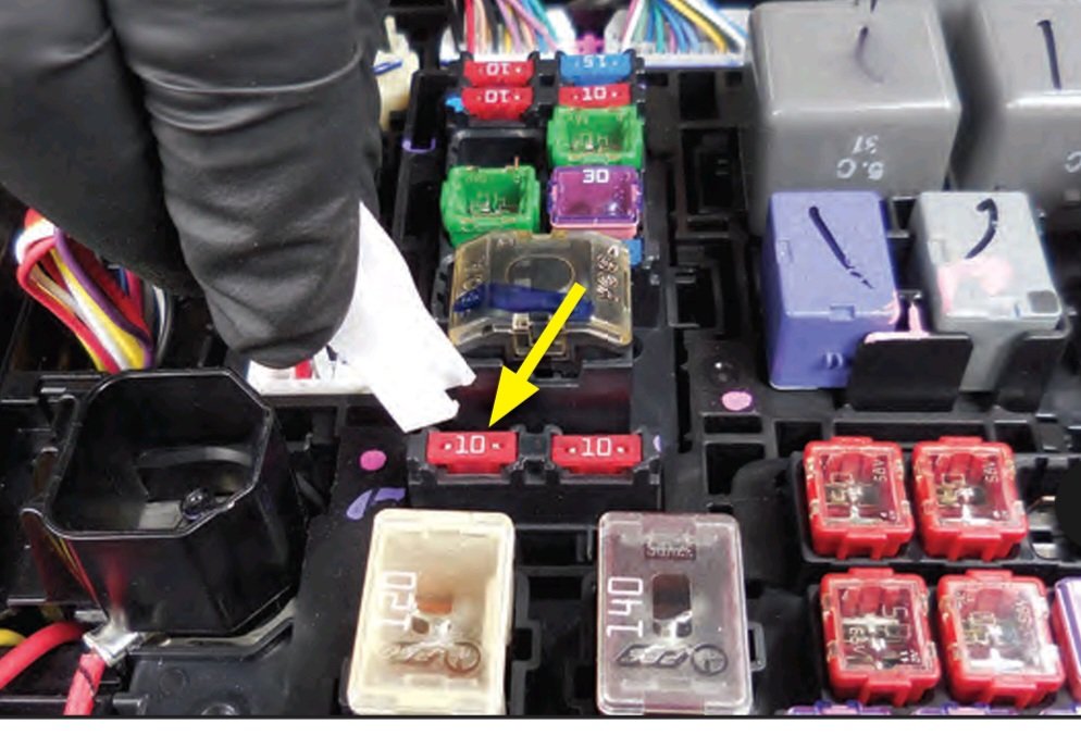

    Well, I'm learnin' a bunch again today. It's been a long time since I tried to tap power out of a fuse panel in a vehicle. If I'm understanding correctly, Toyota has all fuses in the main panel always hot. Power then goes to the relays, which get their trigger, which would be a ground, via the ignition switch. Without going into the interior fuseblock, it seems that most (maybe all?) of those fuses are switched. End user (radio/wipers/whatever) supplies the ground for operation.
    I guess I need to run the pwr wire through the firewall to the interior fuseblock. edit: First, I have to figure out how to get the cover off...
    Thanks for the input guys!
  13. May 15, 2024 at 6:57 PM
    Supr4Lo
    Supr4Lo Well-Known Member
    Jul 23, 2018
    #260306
    3,638
    Jason
    Surprise, AZ
    2020 DCSB Offroad MT, Supercharged, NWF Eco-Crawler, 4.88's Locked F&R on 37's
    I used the INJ fuse located in the engine fuse panel as my ignition on reference. You can sneak a wire in along the other harnesses. The use an Add a fuse to tap into the circuit. I would only use the INJ circuit to power a relay that would turn on power to your device. Don't power the device straight from the INJ circuit.
  14. May 15, 2024 at 7:16 PM
    OldSchlPunk
    OldSchlPunk A legend in my own mind!
    Feb 13, 2022
    #390091
    5,557
    Rich
    East Central Wisco
    '17 OffRoad Silver Sky Metallic
    Small lift, slightly oversized tires, well...
    The Auxbeam comes with an add-a-fuse (5A), which supplies power to the switch controller/triggers the output relays. I'm guessing SwitchPros works the same? So, you're saying fuse #44 is what you tapped, next to the big 120A &140A fuses? I didn't check that one, didn't think tapping FI was going to be a good move.
  15. May 15, 2024 at 7:38 PM
    Supr4Lo
    Jul 23, 2018
    #260306
    3,638
    Jason
    Surprise, AZ
    Not sure the fuse number but yes it's a 10 amp fuse closer to the 120 amp one
    Not my Pic but the one with the arrow.
