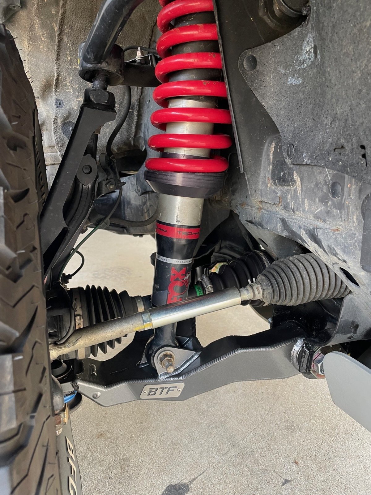

    Here's another option for stock length LCA that moves the LBJ 1" as well and is about $250 cheaper. https://btffabrication.com/collections/toyota-1/products/15-21-tacoma-high-caster-lca
    I'm running these along with a few other guys on here. IMO the JD Fab pivot is probably better all around and lets you keep your OEM LCAs which are pretty freaking stout. I just learned about the JD Fab kit too late.

    I think the $250 difference is the uniball conversion

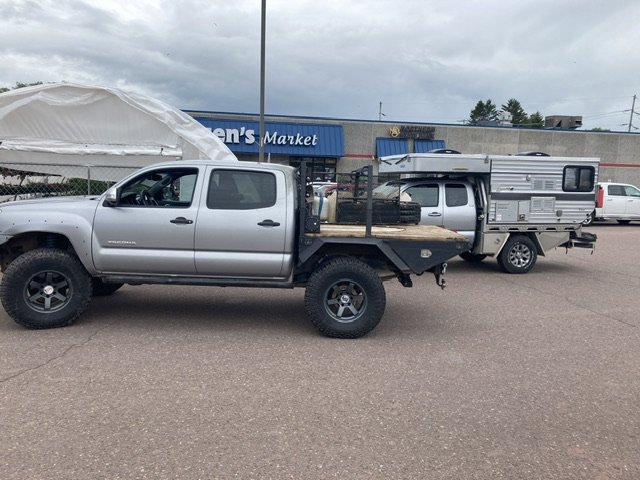

    This was at the IGA today. Florida plates. Nice look
