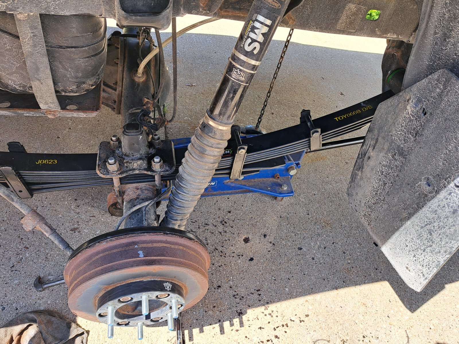

    Quick observation.
    Did the pins fight you because the leaves are bacwards?
    I thought the 2 military straps s/b in the front?
    or 'short side' of leaf facing front?

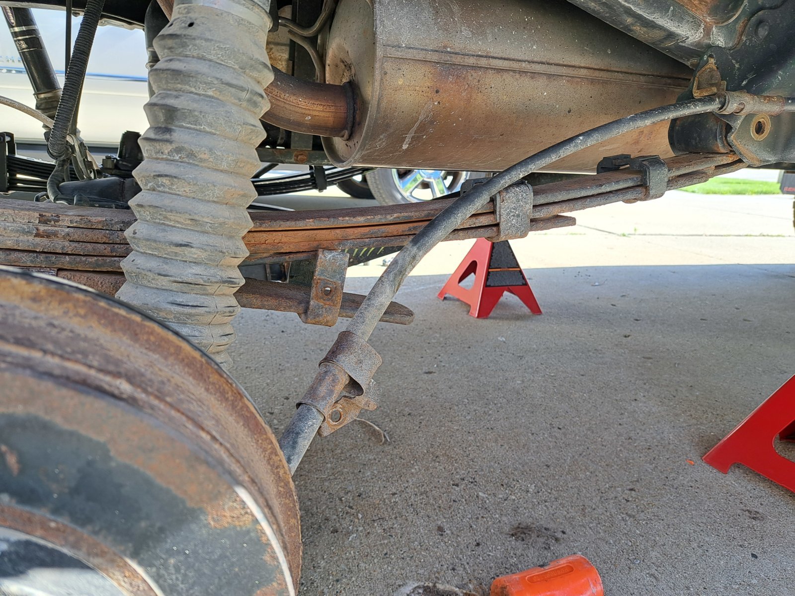

    Ironman's specs show the pin centered, no short side. There is only 1 strap drilled/tapped for the e-brake cable.

    Didn't think it'd be something you'd overlook but that pic looked different so I had to ask.

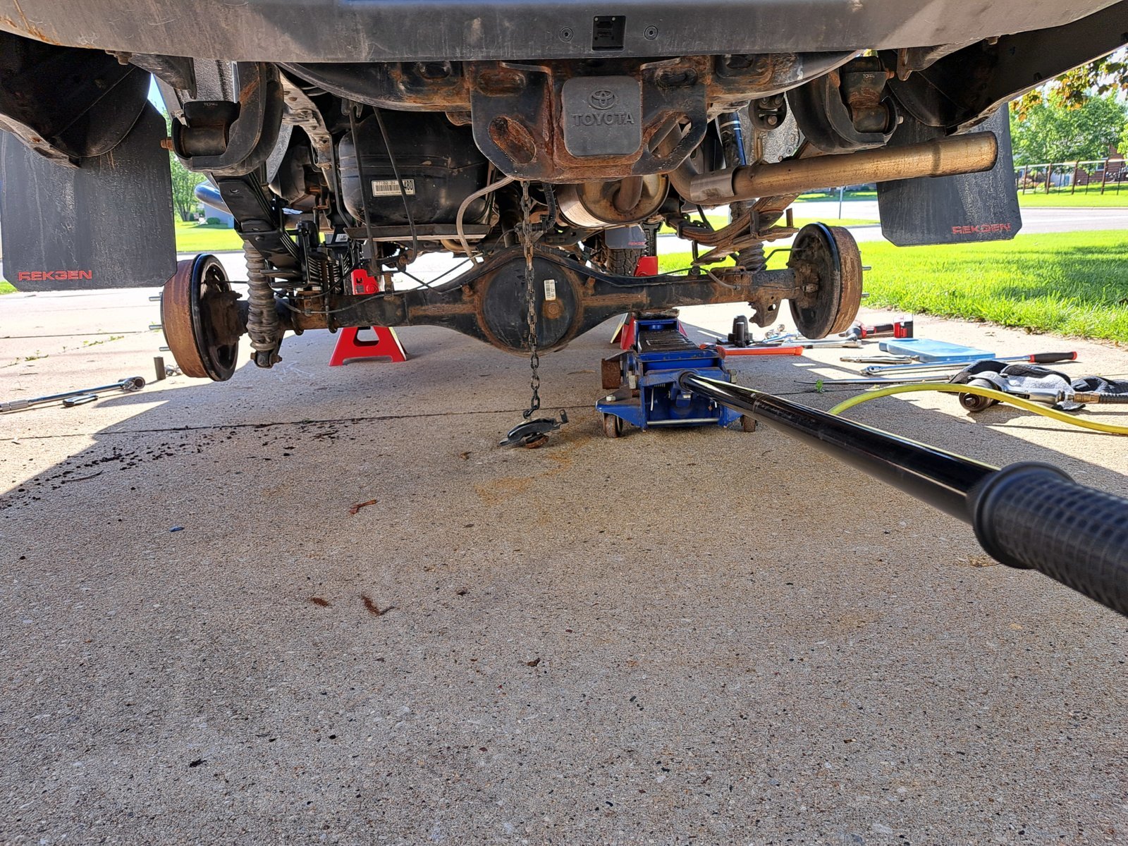

    I guess it was time to stop yesterday...I was trying to get the pin to drop into the wrong hole. Went real well once I wasn't fighting everything!
    Initial measurement is a lift of 1 1/2". I'm guessing it will settle around a half inch. Now I won't be going very slightly uphill all of the time!

    To be honest, when I got the driver's side in and dropped the u-bolts on the passenger side, the difference was about 4" between springs at full droop. The new springs almost top out the shocks at full droop, there is almost 1/2" in the shock yet. You can see the difference in this pic:
    The new springs appear to be very progressive as you put weight on them. The old ones were just flat! I could barely get 2 fingers between the bump stop and the landing pad, now I can get my fist in there easily.
