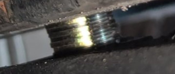

    I was thinking along similar lines when I spaced mine down. The washers I used are 25mm x 4mm thk. The downside of spacing it down is depending on how the force is applied to the skid it's putting the bolt in yeld vs shear. To that end a solid spacer is better than a stack no matter the configuration.
    I took my engine skid off yesterday when removing the sway bar. My skids are beat! definitely doing the job but are all kinds of bent up. I had to really flex the engine skid to get the back 2 bolts started.
    I'm at the crux of deciding if I want to spend the time to straighten the aluminum skids or move to steel and suffer the increased weight.

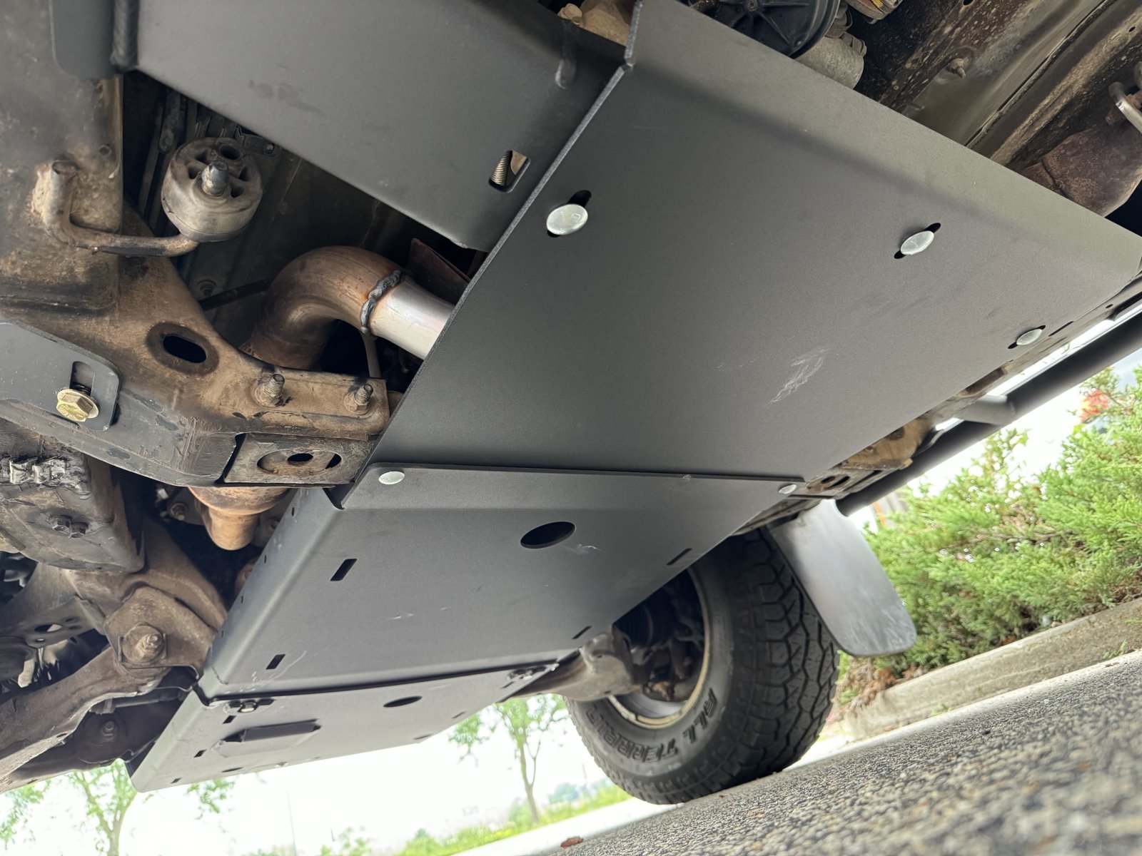

    Saving this photo so I know what straight skids look like.

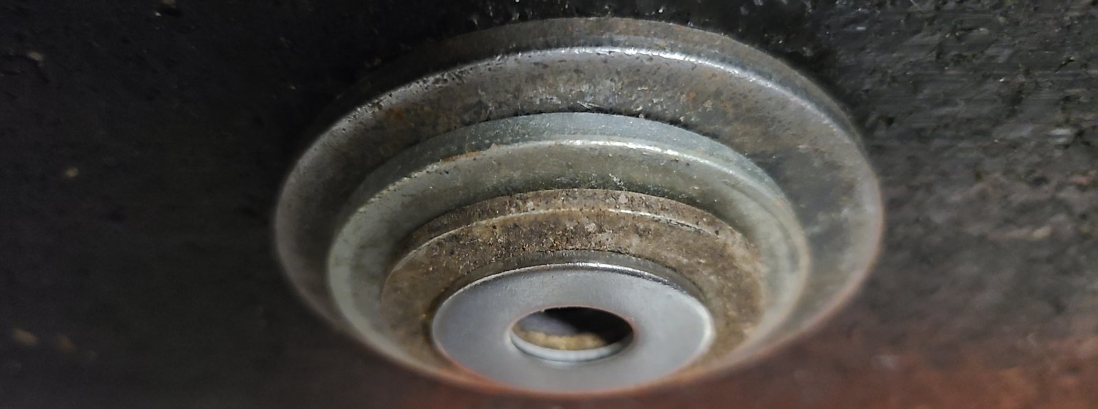

    :D
    I just got done swapping washers to something with a little more surface area. 2.25"o.d.
    (I'm imaging Rock bridge on 32's again.)
    The smaller o.d. washer left a dent in the xmember already, just from me tightening it when I put it on.

    So. Many. Stickers.
    Go steel. It's real armor. And the weight isnt that bad.
  20. Aug 5, 2024 at 3:56 PM
    OldSchlPunk
    OldSchlPunk A legend in my own mind!
    Feb 13, 2022
    #390091
    5,618
    Rich
    East Central Wisco
    '17 OffRoad Silver Sky Metallic
    Small lift, slightly oversized tires, well...
    When you figure that the skids are thicker (1/4") to give similar strength of steel (typical skids are 3/16"), you really aren't saving that much weight.
