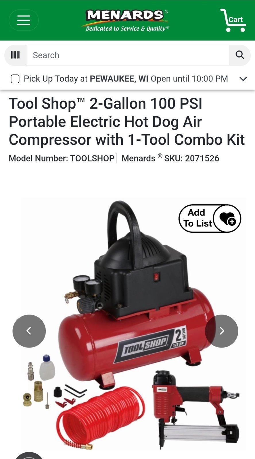

    I'm always in the market for hand-me-downs.
    Trying to determine how popping the hood to hook that up outweighs my current setup of just plugging a pancake comp. into the outlet in the bed?

    It doesn't Will be slower too.

    Well, we don't want that.
    The pancake isn't bad. Lacks the volume.
    I'll fill a tire with what it will take. Let the compressor fill and move on to the next.
    Then one last fill to go around and top them off.
    Not bad just the pancake takes up a 'little' extra space.

    I'm not so sure about that.
    It will come down to the specific compressor, but I used a little 1/3 hp hot dog compressor like the one pictured below for the first few trips when I had my Tacoma, and it sucked. I would never go back from the Viair 300P.
    I timed it leavingTigerton, and it took almost exactly 2 minutes apiece to fill 295/70/17's from 13 psi up to 35. Depending on the size you are planning on upgrading to next :)boink:), and the pressure you're going to run, it could be faster for you.
