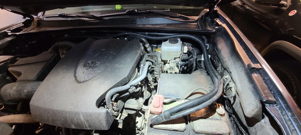

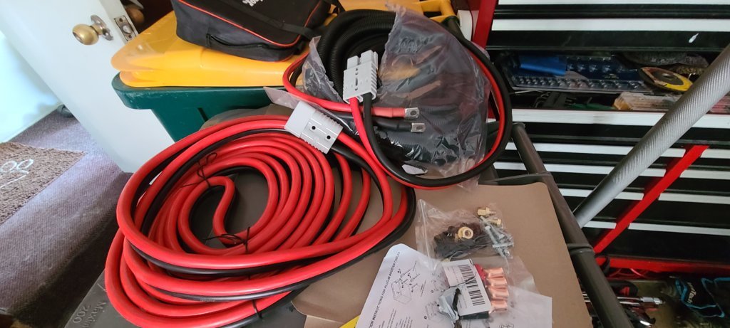

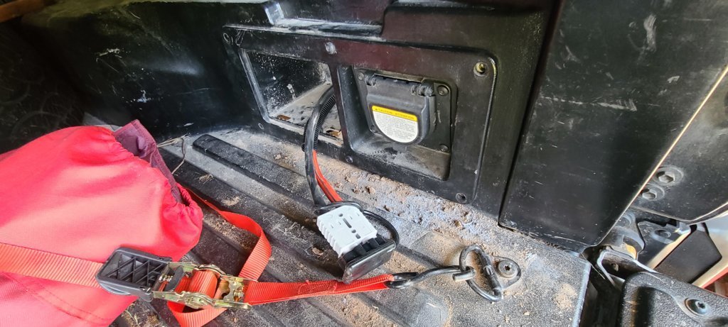

    We will have power.
    30ft of cable and several inches to spare.
    Nothing like taking a brand new set of booster cables and cutting them all up.
    The 800A rated 1ga booster wire came w/ 175A plugs on it.
    I needed 1 more plug but waited until these cables came so I could keep them all the same.

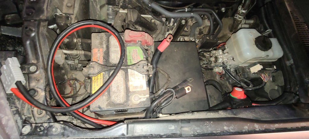

    That almost wraps it up. Winch ready for front or back.
    Heat shrink a couple ends and hook it up.
    Mount the switch and possibly the plug(s)....or coil the chord up next to the battery.
    (I thought about getting a 1,2,both switch for up front.)

    The ON/OFF switch is being used as a BOTH setup how I have it.
    With a 1, 2 both, I'd be able to pick one or the other.
