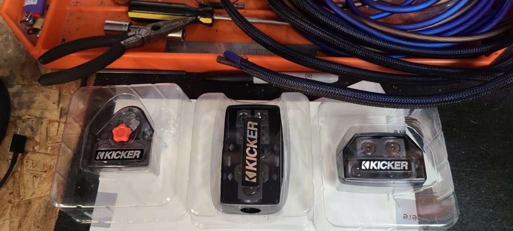

    The one dedicated 12v for the winch, on one side. (1ga. w/ disconnect, 175amp connectors)
    Another dedicated 12v for air, on the other. (8ga. w/ inline fuse under hood. Double fuse dist. block for + , 2 in 4 out ground block, with a 50amp plug for air.)20240917_200758.jpg
    Room for expansion and plenty of slack left to swap over to a 2nd battery someplace.

    Those are to allow him to plug his winch and compressor in at the back of his truck...like how Pat @pearing uses his winch.

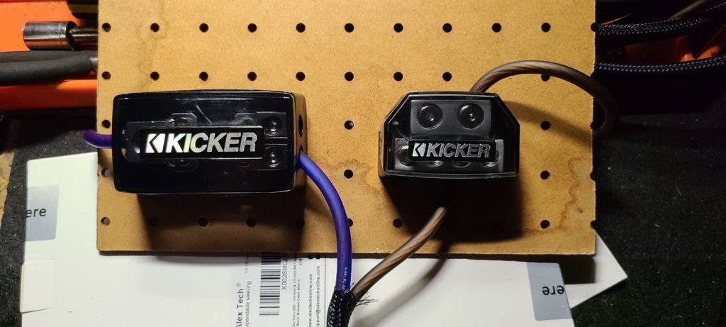

    Like Rich said about the winch and compressor.
    I already ran a line down the passenger side for the winch and winch only.
    What you see in the pic will be in the driver side bed cubby.
    Power distribution.
    On the left is a 1 in 2 out dist. block with a separate fuse for ea. out line.
    On the right is just a 2 in 4 out plain dist block for the ground.
    I'll hook up a cable with an Anderson plug for the compressor.
    The other + output will be open for future expansion.
    The ground block is going right to the battery so I'll have a sure solid ground for anything else I decide to do.
    Running a winch (front or back) and compressor (back) was main objective without having to drag cables around. (plug and play)
    I didn't have to go through the firewall as I ran straight to the back.
    The wire follows existing factory wire along the inner side of the frame.
    For the fridge I'm guessing an inverter would be required? Depending on the fridge, I guess.
    I'm not that far along to get into the AC side of things.
    @wi_taco might be more helpful.
    My get up is pretty raw at the moment.
