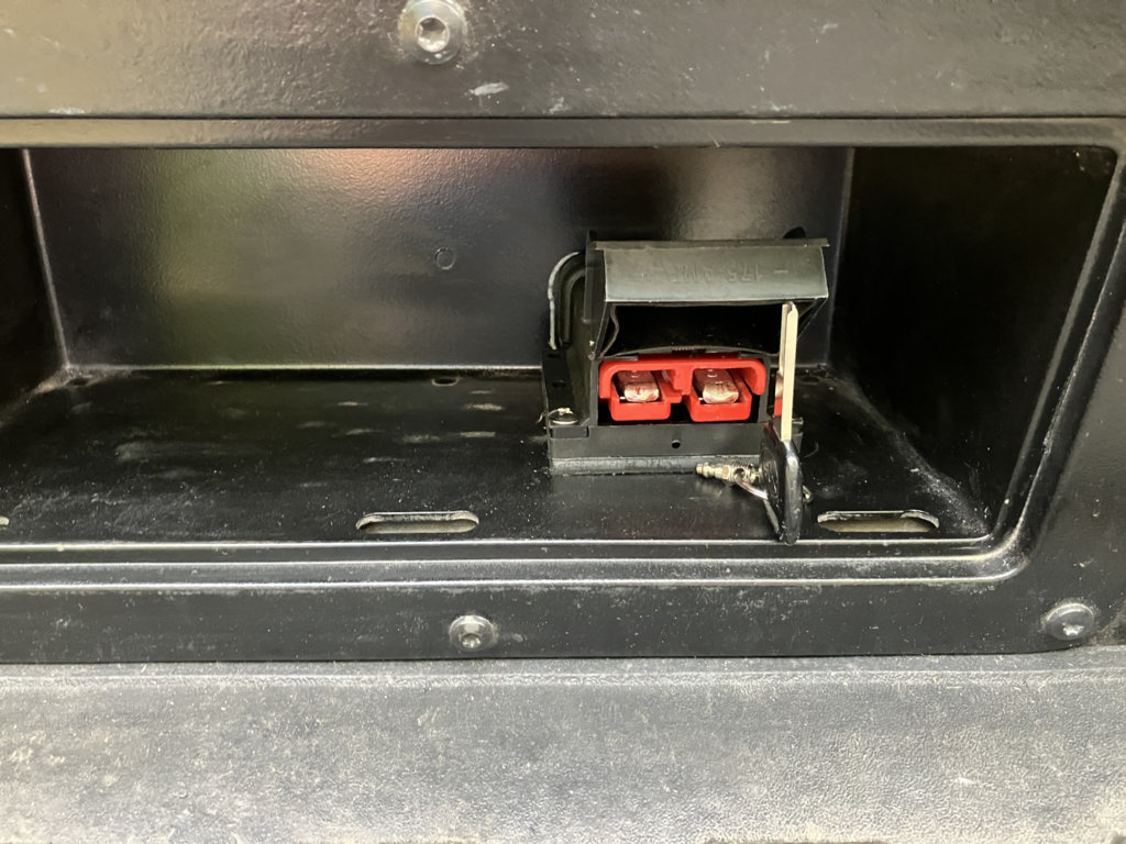

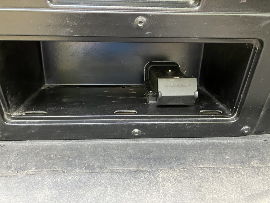

    Bungled solar install fixed!
    Spent 11 hours of my time and about $200 to correct the mess that the professional solar installers left me. Removed & rerouted the wire under the truck, followed the factory loom from the engine bay to the rear of the truck, repaired the abrasion cut with heat shrink tubing, covered the first 8 feet with Techflex Insultherm, wrapped the wire in flexible conduit/loom and wire tied everything securely. Installed a mount for the Anderson connector so it no longer flops out the back of the truck.
    Before:
    After:
