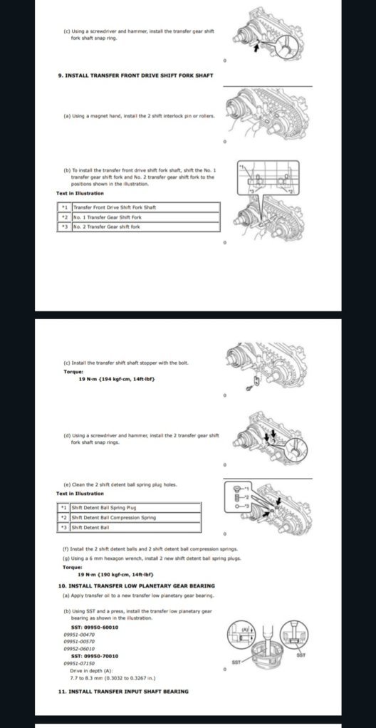

    Sir Manuel shows a couple detent balls and springs holding the rod in position.Screenshot_20241008_184457_Drive.jpg
    I'm thinking those springs are jammed in the path.
    Going to drain the fluid and look for metal before driving it again.

    The rod being able to turn in 2wd is bothering me more than not turning in 4wd.

    I had something similar happen on a rifle build.
    The detent ball for the front breakdown pin got lodged in the slot and I couldn't get the pin out.
    Should be fine that the rod spins because the gear in the actuator holds it in place.
    Once the detent ball breaks the groove, the rod will roll smoothly to the next position.
    It shouldn't take a lot of force for that detent ball to break the plane.
    If I can't pull that back by hand.
    IMO. It's f"$%×D unless I open it up.

    IIRC the end of the rod should be bolted to the shift fork, meaning no turny.

    From the photo(s) I posted, I'm not seeing it.

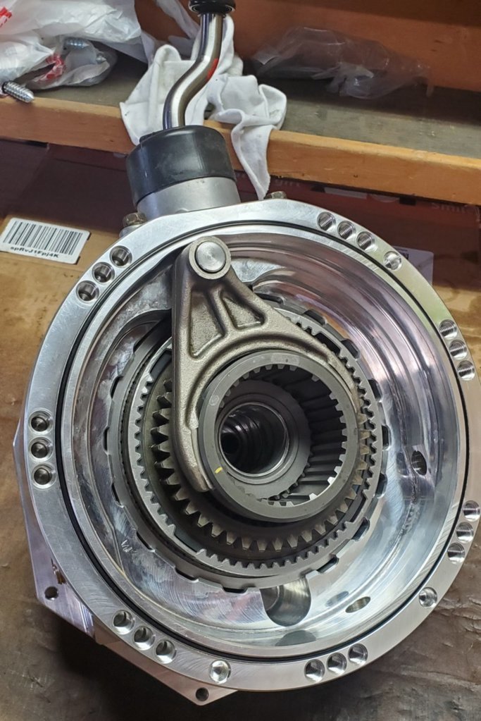

    I'd pull the case and open it up. It's really not that hard.
    The shift fork is inside the case. Looks like this. ( this is in my crawl box but they are parts out of a toyota case)
    This is the low range planetary set same as what's in your case.

    It's the only way to find out what's going on. Even if I picked up a salvaged case it has to come off.
    I'm just trying to accept that I have to tear into it.:blahblah:
