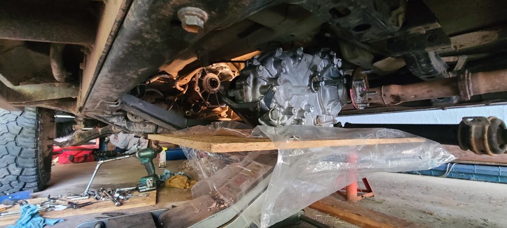

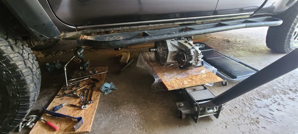

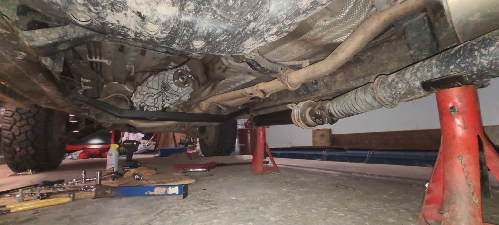

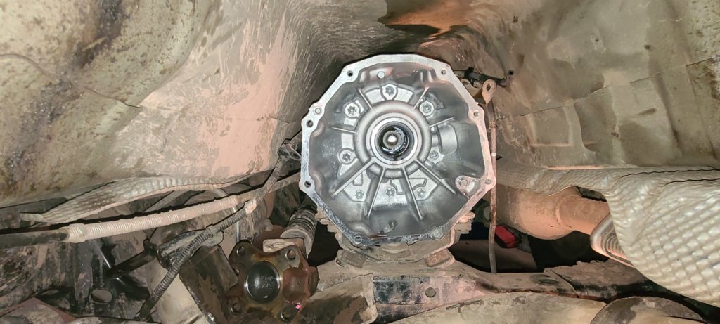

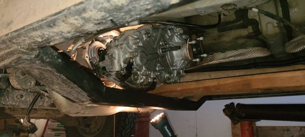

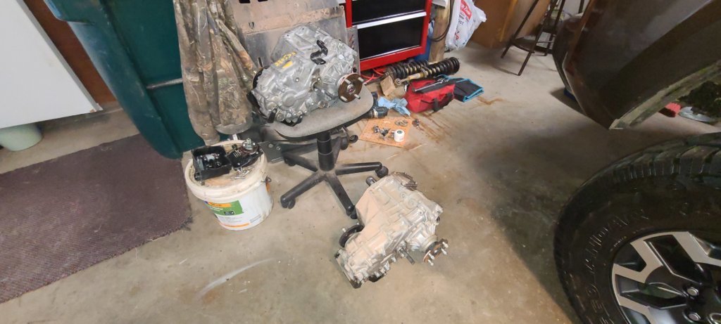

    Halfway there.

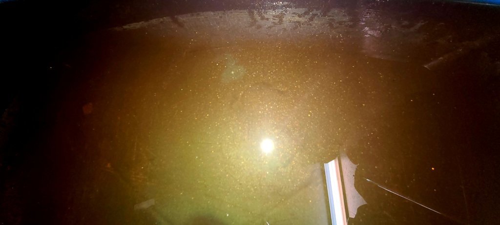

    Edit: Oil analysis can see a glittery bronze substance. No solid chunks and magnet was clean.
    Looks like another pic of the sky.
    We're going in...

    Back in business.
    4HI
    4LO
    I can't say it went without issue.
    1st time I tried. I got stuck in 4H. Didn’t even try 4LO.
    Took the actuator all apart to find this funking thing was still lodged in the plug-in from the previous trucks wiring harness.20241012_040225.jpg
    Actuator wasn't plugged in all the way. :anonymous:
    Thanks to everyone who helped me get this resolved.
