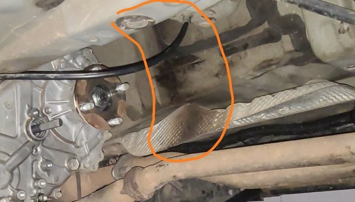

    Pack that shit in there.
    Ujoints were made to be overgreased.
    Edit: was trying to find a decent pic...that streak of brown is around all my ujoints from grease slinging when I get done greasing.

    That? That is far to clean. Mine looks the underside of my dads 55 chevy-grease everywhere! Still killed the shaft...

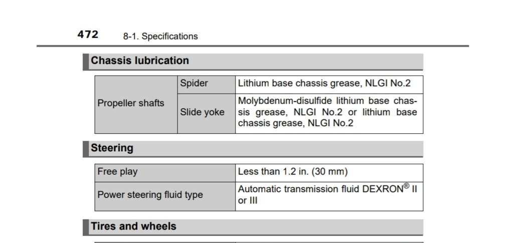

    I know on the 4Runner certain things call for a lithium-based grease.
    I went with lithium-based NLGI #2 for everything because it’s acceptable for the U-joints and slide yoke.

    I use Amsoil Extreme

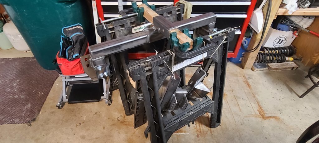

    Rock solid.
    This really has been a great set of saw horses for how inexpensive they are.
    I remember my old man’s wooden ones.
    Solid as all get up but always shuffling them around from shed to garage to lean-to to garage.
    And heavy.

    they'd be lighter if you took all that stuff off them
