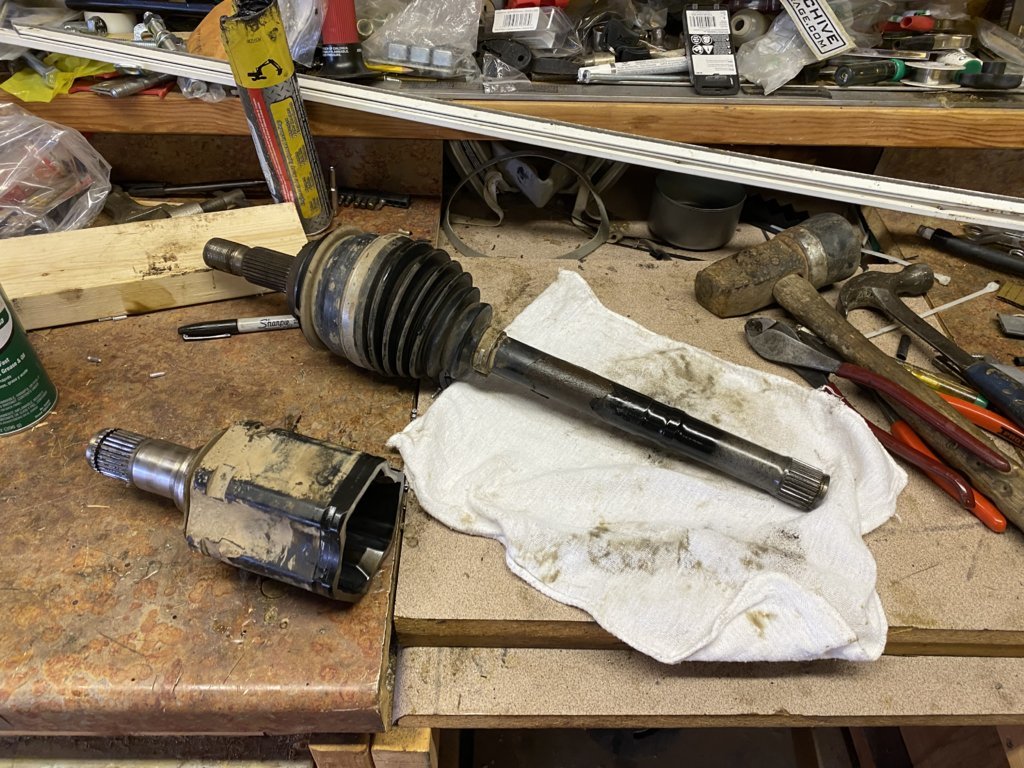

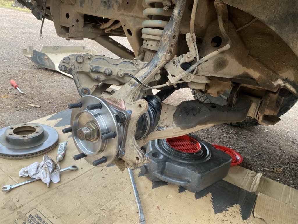

    Dan, if your over 100k and have a lift... only a matter of time on the boots. If you over 100k on the original wheel bearings... your due. I know where you play, surprised you haven't had an issue yet. Same for Dean, Jonathon and everyone else on here. Between Twark, the holes at Tigerton and everywhere else we play your coming due... Just a friendly maintenance and cash depletion reminder.

    That is in my opinion a problem that will never solve itself. I let the experts press my bearings as my track record is 0 for 2 (on my CRV's.) It costs more, but its quick and easy.

    Am I misremembering, or did you already replace the boots not too long ago?

    I did the Passenger side and... a week later the driver side burst. Couldn't find a good time to do it until this weekend. Know how to do it well now.

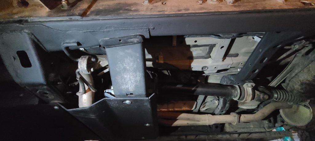

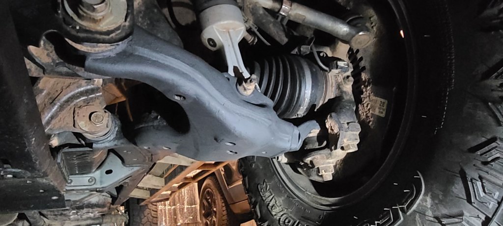

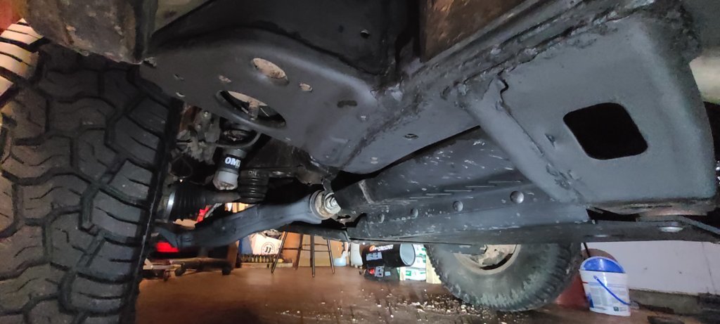

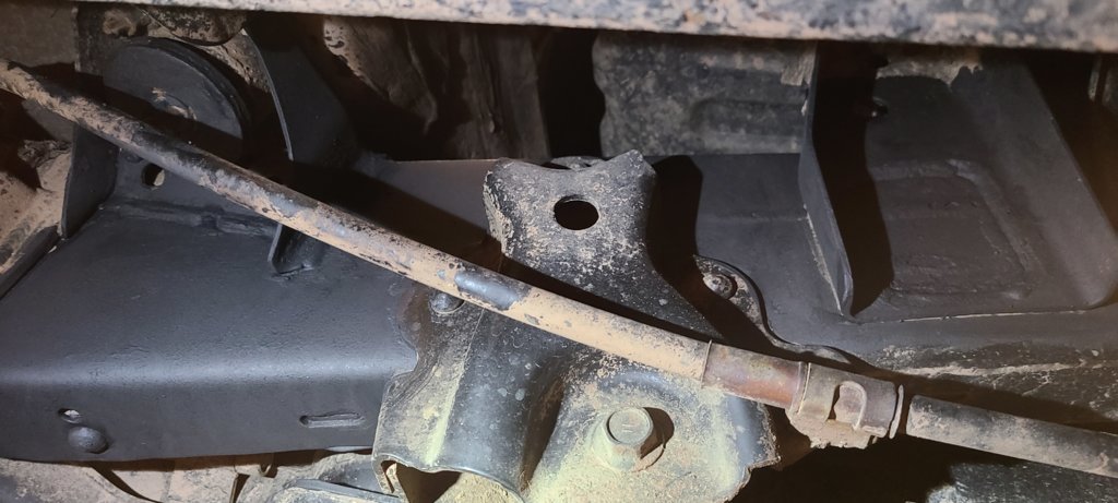

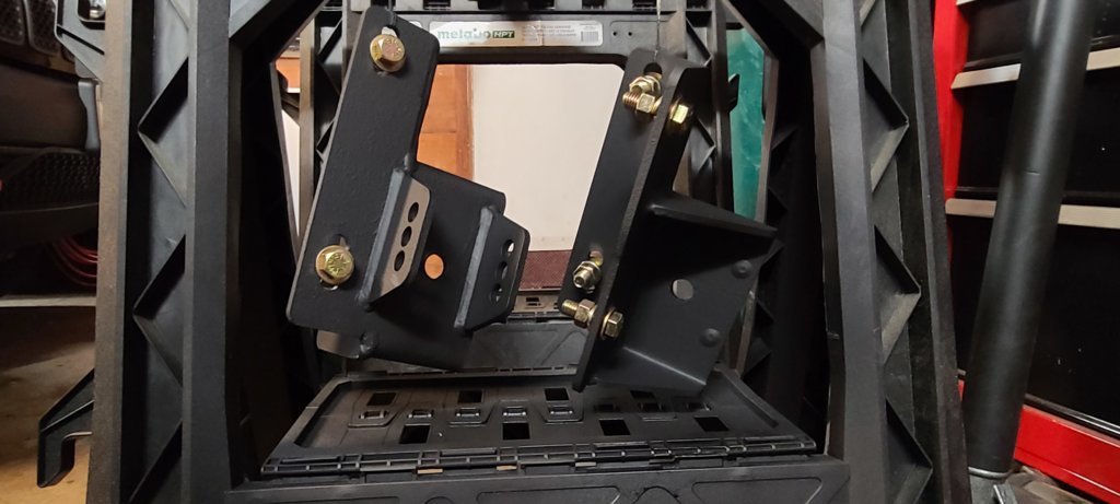

    Got carried away with the woolwax and kept on going.
    LCA's, Cab mounts, cross members, side frame back to rear cab mount and bed mount by the front shackle hanger. (both sides) 20241117_133729.jpg 20241117_133522.jpg 20241117_133559.jpg

    Hoping I can get the shackle flip on this week.
    Heading a fair 3 hr ride to the hunting shack, Friday.
    Would be a good chance to get a feel for it.
